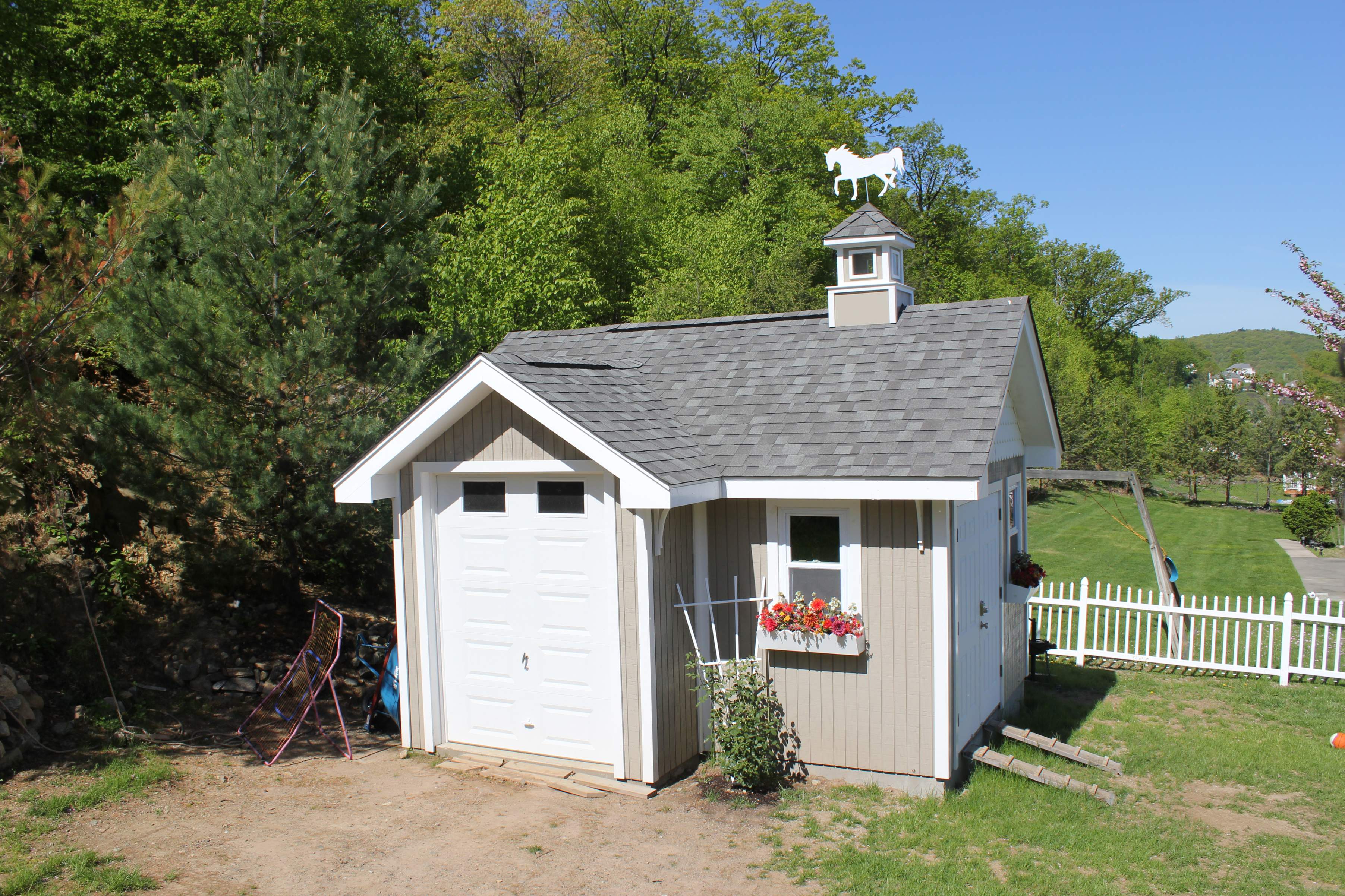

They say the tar paper should not sit exposed to the elements, for too long. One reason is the tar paper starts to get wavy (for lack of a better word) and lifts away from the sheathing. Depending on how bad it gets, it will be noticeable when the shingles are done. They will also look wavy and won't sit nice and flat as they should. That is what happened to me 2 years ago, when I built my shed. Good luck, your off to a good start. Heres mine:
