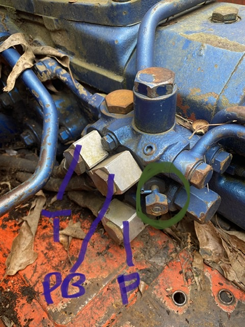

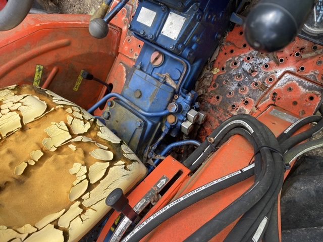

K5lwq, I've read your write up and thank you for this. I have added a front loader to my lk 3054 and now not much is working. Trying to figure out what I've done wrong and I think this is gonna help me a lot. Do you have any information as to where you hooked up your pressure gauge and any pictures of your relief valve taken farther back so I can make sure I a dealing with the right part of my tractor. Thanks
   / LK 2554 and LK 3054 Hydraulic Pump Upgrade
#20
I put the pressure gauge on the curl function of the loader valve. I will have to take more pictures tomorrow but they have a couple different priority valves so yours may look different.
When you add a loader you have to turn the knob on the priority valve clockwise to direct flow thru the power beyond port. I will get a picture of that as well. Hope that helps.
