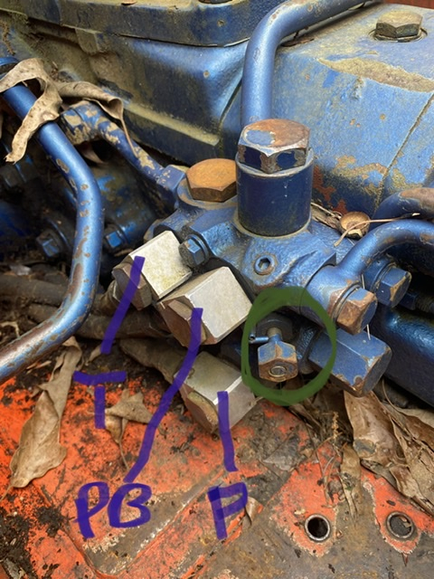

I marked the first picture I marked the hoses and diverter knob.
P=Power to loader valve
T=Return to tank
PB=Power beyond from loader valve that feeds 3pt hitch
The knob is circled in green and needs to be all the way clockwise to feed the loader valve.

I put the pressure gauge on the curl function of the loader valve. I will have to take more pictures tomorrow but they have a couple different priority valves so yours may look different.
When you add a loader you have to turn the knob on the priority valve clockwise to direct flow thru the power beyond port. I will get a picture of that as well. Hope that helps.

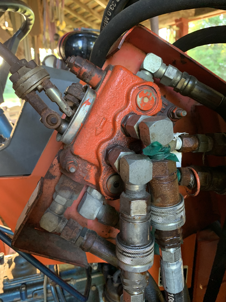

Can you post a picture of your loader valve? You should have 7 total hoses connected. 4 to the cylinders, 1 to the power in, 1 to the tank port and 1 from the power beyond port.

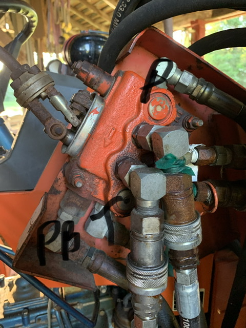

   / LK 2554 and LK 3054 Hydraulic Pump Upgrade #25
T=Return to tank
View attachment 700484 View attachment 700485
Sorry about the crazy pictures. My computer is acting up and having a terrible time attaching files. This is only one of several.

Can you confirm you have hoses correct?
P=Power in
T=Out to tank
PB=Power Beyond

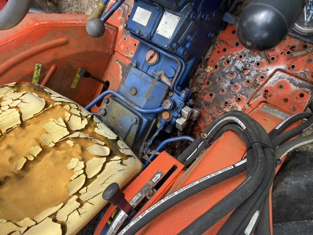

Here are the 3 hoses that go down to the block on the tractor
