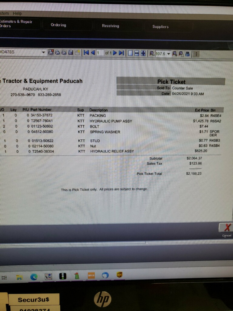

   / LK2554 Hydraulic Pump Question #17
Here's the parts list from my local dealer
#18
Wow that is way more than what I paid. Here is the thread where I did the install. I shared my prices and the part number. Hope that helps but that seems high to me.
