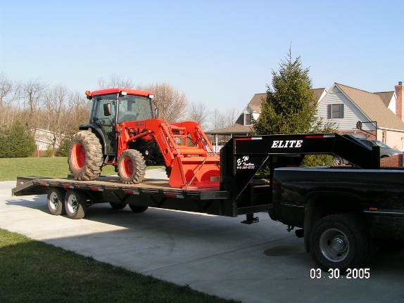

OK... lots of good thoughts and suggestions... and, since y'all like to spend other's money, I've moved to the following idea for the trailer:
A deckover
2 7K axles (or greater) with elect brakes each axle
25 foot dove tail with fold up ramps, probably 5 foot.
farm tags, clearly, lots of reasons, including less restrictions
sides fitting into stake pockets

Here is a Kubota 5030HSTC sitting on that exact setup.

Wow, Dargo, that's an Elite set-up:D :DI could really use something like that:) Thanks for the photo.... convinces me that this is a good way to go...

LOL, thanks. I have another just like it but it is 5' longer and has dual wheels on each axle and those axles are 10k each where the pictured axles are 7k each. Pictured is the 20' with 5' tail, giving 25' with ramps up. I use it far more often than the larger trailer. It's easier to handle and easier to turn without dual rear wheels. Just thought it may give you a reference for your tractor. The 'bota will fit even with my 7' rotary cutter on the back and FEL on the front of the tractor.
