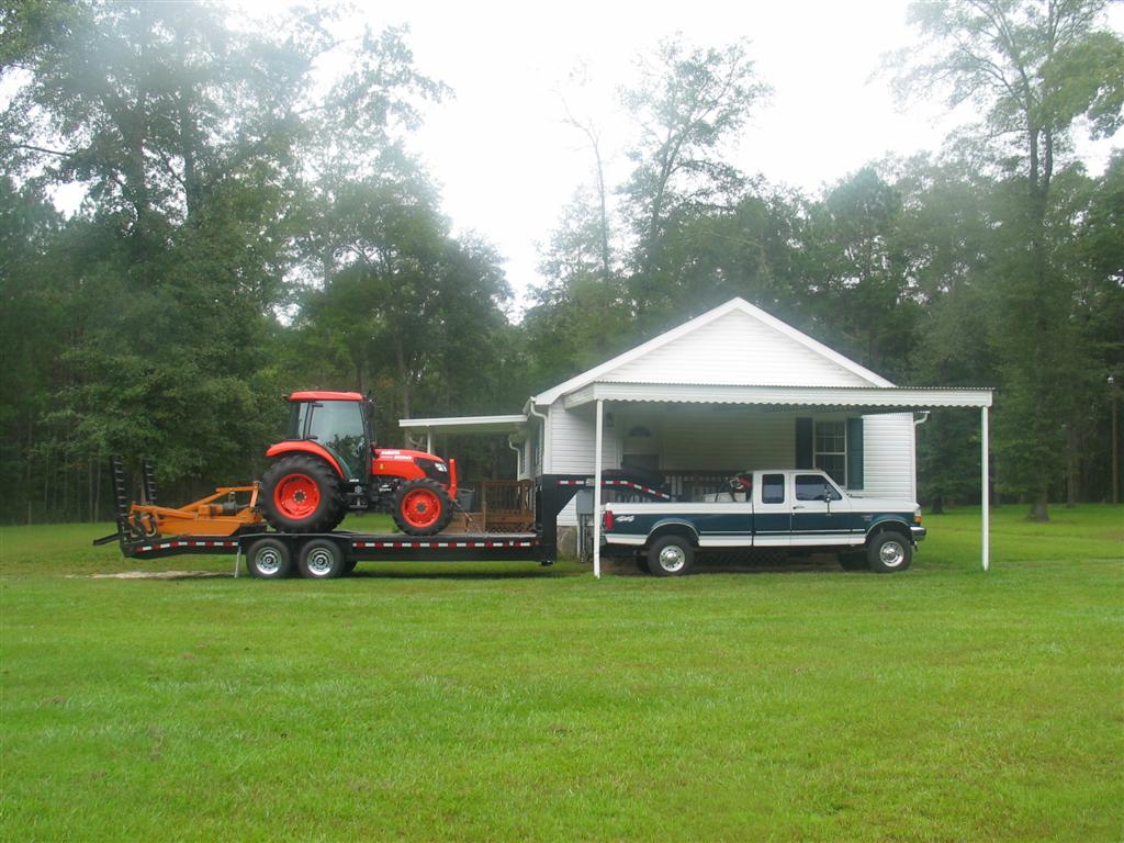

I thought I'd post a pic of my 20' plus 5' flatbed gooseneck.
It's called a Driveover Fender model and has worked real well for me.
Stu

   / lo-boy versus over-the-wheel flatbed gooseneck? #60
That is a nice trailer. Just dont do like the guy on the net with a new 5th Wheel Camper and a New Dodge truck and take down the awning.
Chris
