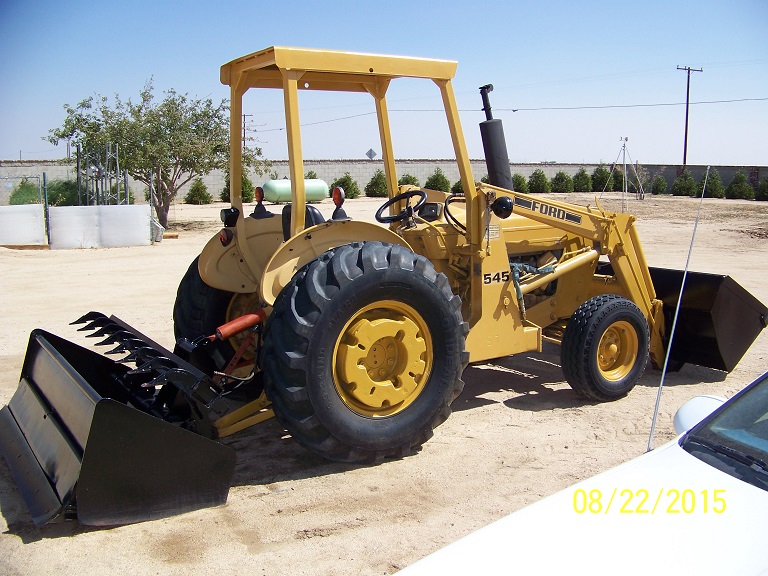

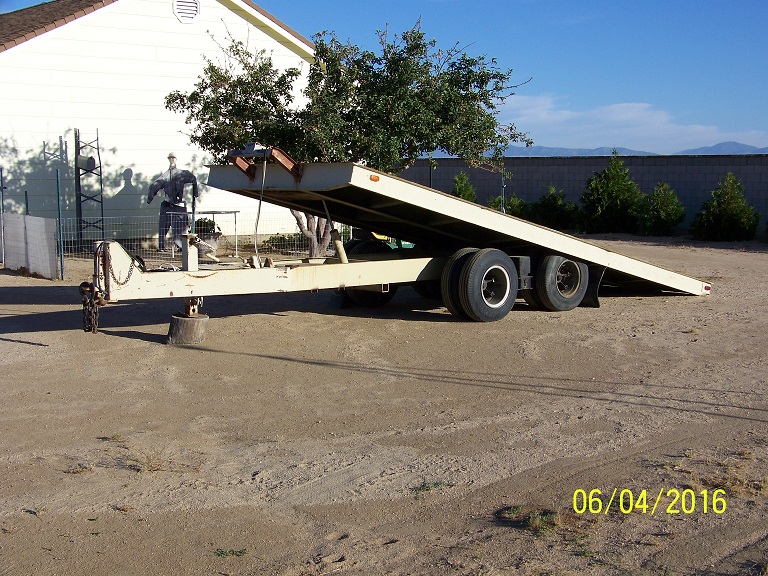

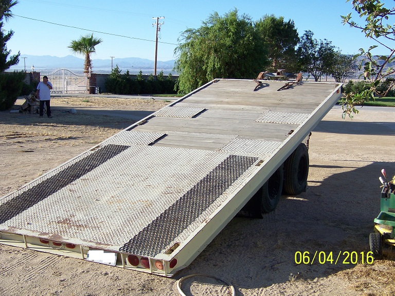

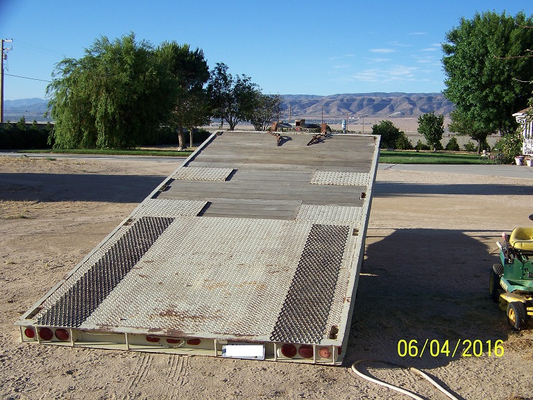

Hello everyone
Just purchased a 1980 Miller Tilt bed for my Ford 545A any advice on how to adjust the load...
I was told by a Trailer manufacturer that a hydraulic cylinder requires the axles to be placed too far forward, and that a scissor jack is best.
But at 13K I went with the Old Miller.
How good are Miller Trailers...?
Best way to balance...?
Thanks 545A -sm.jpgF350 and tilt bed trailer 003 good pic lic blocked -sm.jpgTilt Bed before - 11-sm.jpgTilt Bed before -2-sm.jpgTilt Bed before -3-sm.jpg

Looks heavy duty. What is the GVWR of the trailer?
Best way to balance it is get 10-15% of the gross weight of the trailer on the tongue. It might be a lot of weight for your truck. From the looks of it the tractor is going to have to about as far forward as it can go. What does your tractor weigh? The specs say that model ranges from 5k to over 12k. That trailer probably weighs at least 5k. Hope you have a heavy duty hitch.
   / Load balancing #3
Think you're going to be in trouble with tongue weight. That trailer probably weighs over a thousand pounds on the tongue empty. It appears to be at least a 15t rated trailer.

I figured I needed a dump truck, the person I purchased my Ford 545A said it weighs 12K lbs (6 tons).
I was also told that the cylinder tilts, require the axles to be mounted closer to the front to make the tilt action work.
He said he uses a scissor lift now instead of a cylinder..axles go farther back ride is way smoother.
I was told to try to balance the load by backing up on the trailer possibly.
I was also told if I can get a good balance I would be able to load more than one would think... but that scares me.
Previous owner stated it did start to sway at about 35-40 MPH I knew that going into the purchase.

What are you using for a pintle hook on your truck? If it is something going in a factory 2" receiver it isn't rated for that kind of weight.
I am guessing it is around a 97 model? Excellent trucks and engine but they were only rated to tow around 10,000lb. The weight of your tractor and trailer might be close to double that.

There is only two ways to load the tractor. Pull it on, or back it on. Try both, use what works best. But in either case, the trailer + load is NOT a good match for that truck IMO.
Do you know how much the trailer weighs empty? I am gonna venture a guess, just based on how its built, its north of 7000# empty.
And your machine, with loader, wheel weights, box scraper....I'd put it at ~13k.
So you are wanting to tow 20k bumper pull, from a hitch probably only rated at 10k, and no W/D hitch with pintle, with a 2-decade old truck, that is lifted and oversized tires to boot.....
I'd re-think your plans. Get a truck to match the trailer and load. Or at the very least, if you insist on towing that 545 with THAT truck, get a GN plate, and a lighter ~16k GN trailer. Still gonna work the snot out of the truck, but with an adequate hitch, and good trailer brakes I dont see it as being unsafe.

I agree, it is a very poor idea. And when that trailer starts to sway it will be unrecoverable.
