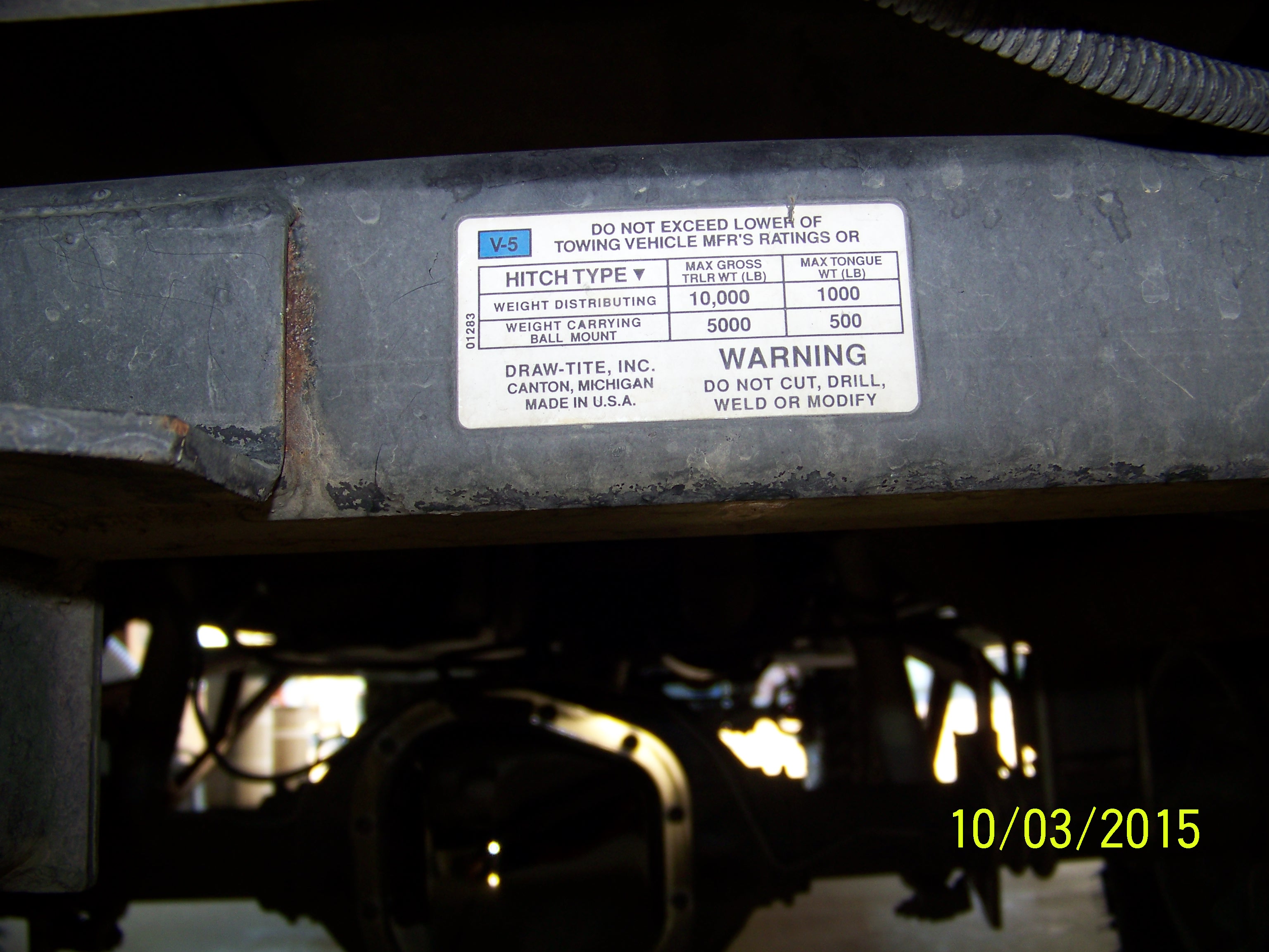

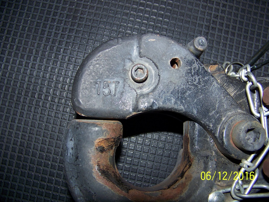

That is a 15 ton pintle hook. The hitch on your truck you posted a picture of is not up to the task. Kind of hard to tell but in the picture it looks like it is cracked to the left of the sticker. With the pintle hook you are using it in the weight carrying /ball mount mode which means it is rated for 5,000 gross trailer weight and 500 lbs tongue weight. It likely isn't rated high enough to haul that trailer empty.
You can find decent old dump trucks in the 10-20k range. If you don't need a dump truck you could find something like a international 4300 or 4700 probably in the 5-10k range that is a medium duty truck. Likely would not have a bed so you could either build a flatbed or whatever.

Hello Bdog I hope this helps (pic of pintle and hitch)<img src="http://www.tractorbynet.com/forums/attachment.php?attachmentid=471686"/><img src="http://www.tractorbynet.com/forums/attachment.php?attachmentid=471687"/> I am assuming its a 15 ton pintle hitch..?? I called Draw-tite they said they did not make a class V receiver hitch..?
That is not a class 5 hitch. It's confusing but V5 is the SAE standard stamp that towing components are marked with that are sold in North America.
It's a class 3 hitch or possibly a class 4.
Chris
/ Load balancing #25
500 lb tongue rating is class 3.
Not even rated for the empty trailer.

V-5 has nothing to do with the tow rating or class. It means the hitch meets or exceeds the minimum standard for a hitch.
Here is a link to the standards. Click on the V-5 for a PDF download of hitch standards.
VESC Regulations

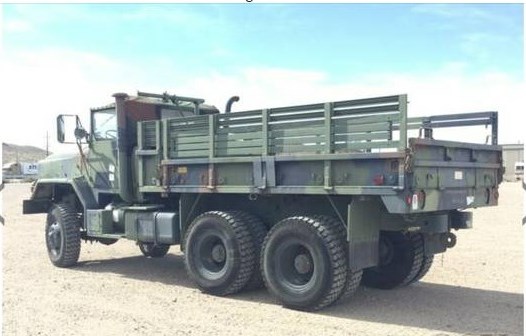

Well said Gary...overkill it's like a disease. I think I found a truck to pull my trailer, and once again overkill steps in.
This is a 5 ton..I think I can get a Deuce and a half for cheaper, registered as "historical" with no CDL required.
Any input would be appreciated..Thank You

Look into the historical plates in your state. There is usually wording that dont allow you to drive it like a normal vehicle.
In ohio it says something to the effect that they are only to be used to participate in special events, parades, club functions, exhibitions, etc. (I would assume it would include travel to and from as well). But NOT to be used for general transportation.
I think you would have issues towing a trailer and tractor with something tagged as historical.

I have only seen one response to your photo of the hitch on your truck that seems to be cracked on the left side. I would for sure look into that crack/break before using that to pull even a small boat trailer. It appears from the photo that the bottom plate has failed completely and the square tubing is also broken. I would weld the whole thing up with a full penetration weld prior to using it again.
/ Load balancing #35
I don't see a break, I see an L-bracket welded at the top and bottom of the tube, but not across the face where it would introduce a stress riser, and some rust at the gap where the bracket overlaps the tube...?
Hello LD1 I was looking at a 5 ton and the owner said he uses it to tow his race car..he loads the car unto his trailer, then uses the ramps to load his car from the trailer to the M923 bed.
There is a website called steel soldiers that seems to have quite a bit of info..with the bad economy the prices are quite low on these types of vehicle's.
I have 2.5 acres 25 miles away from my property, and plan to use it to tow my 545A w/1979 Miller tilt bed for my own personal use, I will make sure this meets all the requirements.
From what I am reading "no" CDL required. Just had a friend sell his F-650 because his insurance company would not give him a "non-commercial" policy.
Hello Gary It will put that on my desk at the top...I may send another photo, If I remember I do believe it was just a scratch, or paint flake..But I will "definitely" look into this ..You guys rock !!
Hello Gary I quadruple checked, wet my finger and the illusion disappeared. No cracks..thanks for the heads up though.
