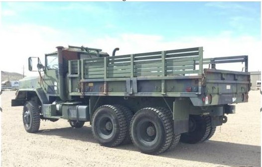

Well said Gary...overkill it's like a disease. I think I found a truck to pull my trailer, and once again overkill steps in.
This is a 5 ton..I think I can get a Deuce and a half for cheaper, registered as "historical" with no CDL required.
Any input would be appreciated..Thank You

Look into the historical plates in your state. There is usually wording that dont allow you to drive it like a normal vehicle.
In ohio it says something to the effect that they are only to be used to participate in special events, parades, club functions, exhibitions, etc. (I would assume it would include travel to and from as well). But NOT to be used for general transportation.
I think you would have issues towing a trailer and tractor with something tagged as historical.

Hello LD1 I was looking at a 5 ton and the owner said he uses it to tow his race car..he loads the car unto his trailer, then uses the ramps to load his car from the trailer to the M923 bed.
There is a website called steel soldiers that seems to have quite a bit of info..with the bad economy the prices are quite low on these types of vehicle's.
I have 2.5 acres 25 miles away from my property, and plan to use it to tow my 545A w/1979 Miller tilt bed for my own personal use, I will make sure this meets all the requirements.
From what I am reading "no" CDL required. Just had a friend sell his F-650 because his insurance company would not give him a "non-commercial" policy.
And I do believe the DMV wanted a $2600 weight fee
If I have learned anything in life, it is to always be patient....Lord knows how many times I have had to do a "do over".
Thank you for the info and the heads up.
