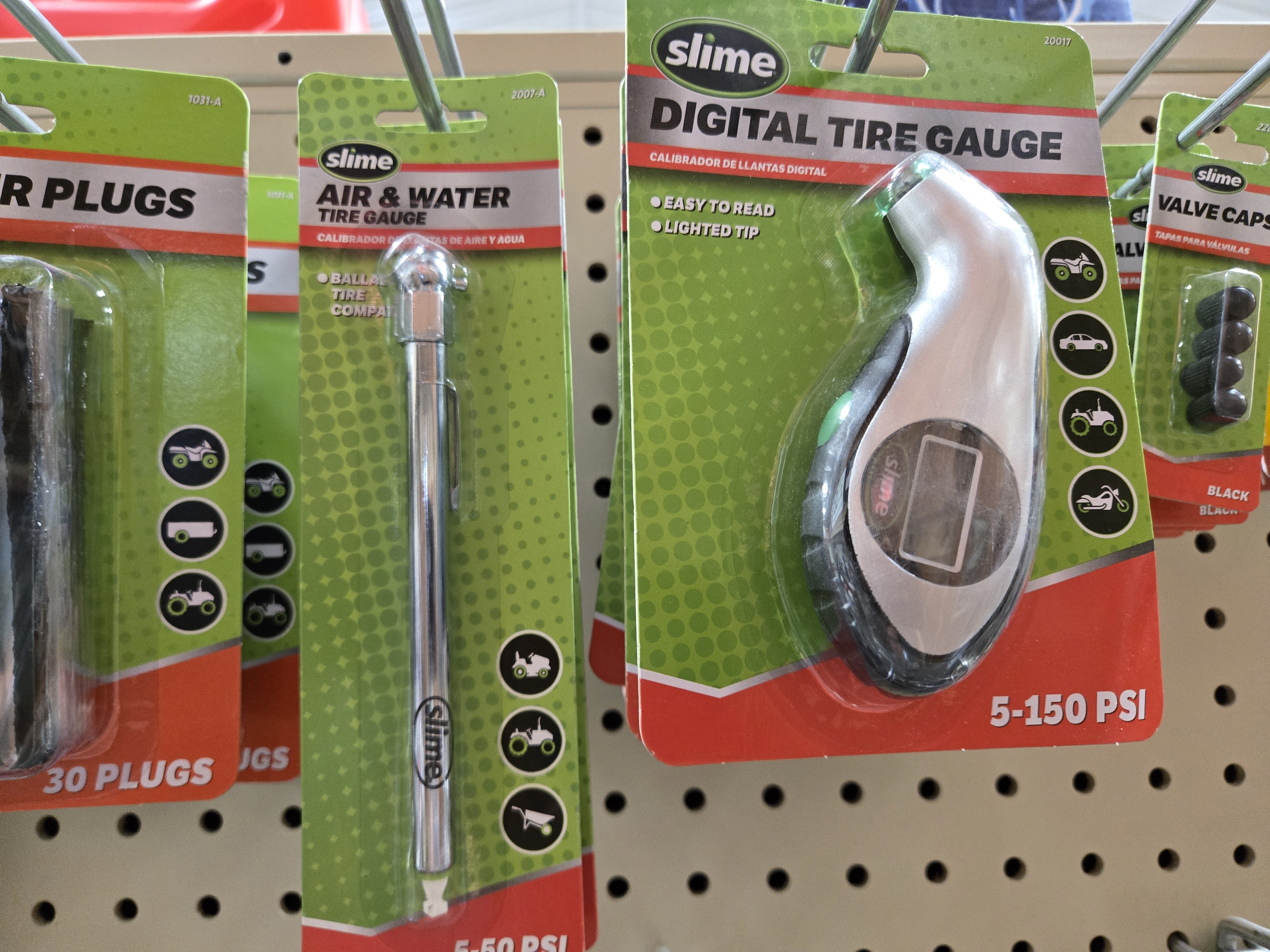

The digital one on the right wont work ( I ruined one with beet juice...)
The old school one on the left works fine, its even says air and water.
