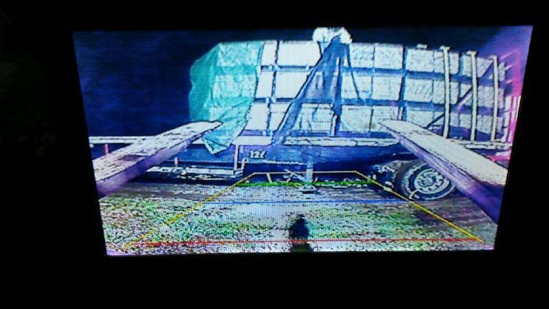

Don't the newer go pro's have the ability to transmit to your cell phone? They have a ton of mounts available. Not exactly cheap but it could be used for other things as well.
Tom
I stuck the GoPro on the closed tailgate with a magnet mount and pointed down to the hitch ball. Yes, the newer GoPro's transmit to your cell phone. This is a temporary thing as a person wouldn't want to be haulin' the GoPro around. It could mysteriously disappear.
/ Loader Camera (pics) #24
This mount has been changed some. It was made out of 3/4" square tube, the replacement is 1" (so the camera plug fits through the tube. Also the tube now has a forward bend and it not quite as tall (the height is adjustable within reason using a sliding bracket at the base).
The big wing nut on the left adjusts clamping pressure on the loader cross tube so the camera boom can be set so it would be pushed out of the way if something impacts it. The clamp also allows for forward and aft adjustment. The small screw clamp on the right is for adjusting mast height.

Good job on getting the camera height just right to barely cover the bucket width. Does the camera vibrate with the engine running?
/ Loader Camera (pics) #27
No vibration at all, even with the 3/4" tube shown. As mentioned, I later modified it to 1" tube, mainly 'cause I put a radius bend in the tube for spacing purposes, and then had a camera glitch. And like all good plans that don't work out, the bend prevented me from pulling the dang plug back out to swap cams. Scratch head, scratch butt, start over!

I was inspired by JL when I first read this thread and so went to Amazon and bought the display and camera. But I set it up as a back camera, mostly for snow plowing because I also have a back blade on. I now have the display and camera mounted and it works great. What I didn't realize until I actually got the display and hooked it up first on my dining table is that it is capable of having 2 video inputs. And there is a button on the front of the display to switch between the two. So now for another $13 I can set up a front camera. Just thought you guys would want to know that in case you have a need to set up 2 cameras somewhere on your tractors. Good choice in parts JL.
/ Loader Camera (pics) #32
There's another long-running thread on here from last year, titled something like "backup camera for $50" where a bunch of us setup up front/rear camera systems with the monitor switching between cams, and it works well. Hard to believe you can do all this for so cheap. No doubt I had way more time involved in the labor and custom fabrication!
Here's the setup I used for my front camera:
http://www.tractorbynet.com/forums/...ckup-camera-50-a-post4042463.html#post4042463
Scroll down to post #219 on that page.
