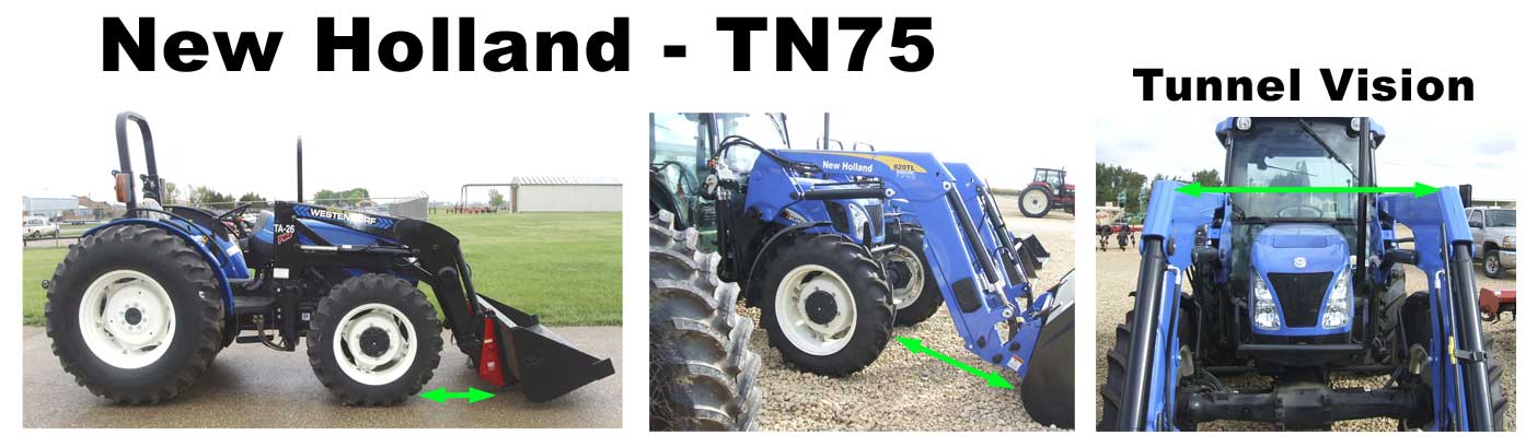

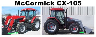

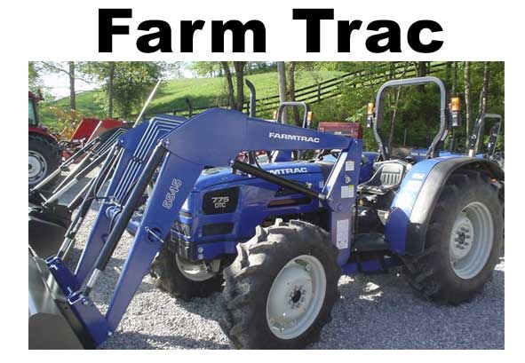

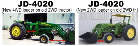

I would strongly disagree with this statement; it is actually quite the opposite. Tractor manufacturer's have a smaller loader base. Most don't even build them. Loaders are an "accessory" item for them, their focus is tractors. As a loader manufacturer, we have 5 Series of loaders that total nearly 40 different models. We match a loader to the stature of the tractor quite easily. SEE PHOTOS. You have more custom options with an aftermarket loader, so you can match your material handling needs. Sorry for the book, but I needed to clear up that common fallacy. This isn't just the case for a Westendorf, I've seen many Quicke, Bushhog, Koyker loaders that fit better too.
So back to the original post, Outside of the specifications of the loader, things your really want to keep in mind are:
1) FIT - how well will it fit the tractor, does it sit below the hood so you can see what you are doing? Ask to see a photo and how many other tractors can this loader fit?
2) QUALITY - Make sure its good steel, especially check size of the pins at high wear points. Getting the (grease-from-the-end) style are really nice for maintenance. Are the arms double tapered to resist twisting? How is the torsion tube welded in between the arms? Does it go all the way through to the outside (welded twice)?
3) USER FRIENDLY - Does it include a quick-attach? How does the loader come on and off easily? What attachments are available? are they reasonably priced? I've seen some companies give low prices on loaders, but take you to the cleaners on their attachment line or quick attach adapters.
4) PRICE - remember, you get what you pay for. Do you want a loader that will take you through your next 3 tractors and last 20 years or one that will wear out in 3 to 5 and not retro-fit to your next tractor?
5) USA Made - If you want reliable parts availaibility buy USA. We still mfg. full line of parts for loaders and gears we built back in the 50's.
It's important to shop around, so hopefull this information helps you know what to check out before you buy. I ranked this in order of Fit, Quality, Features, Price and USA made. What is most important to you guys out there when you purchased your loader?
