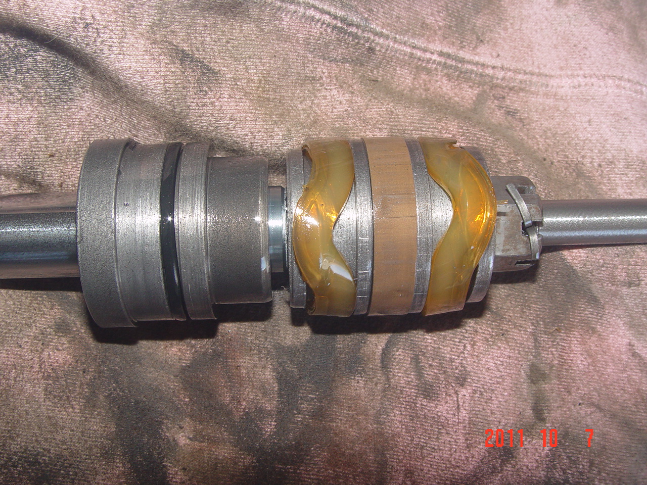

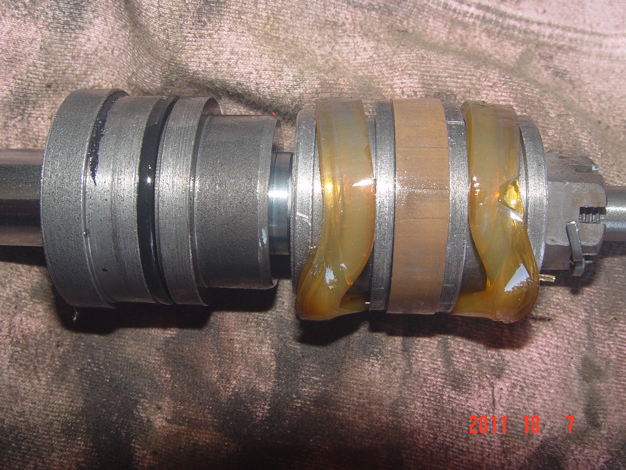

Got it all reassembled and got a nail in the tire immediately after on the way back from using the pressure washer on it. Oh well now it's put away clean and ready to roll next time the beaver makes our road impassible.
The first pic shows the parts that were clearly bad, the second shows the final bill to rebuild two cylinders ($260) and all the parts replaced.
The guy who did the work said there was a bit of rust in the cylinder that he honed, that seemed odd, but a long time heavy equipment contractor said this guy was the best.
/ Loader curl leak down #33
Thanks for the update Lex, glad to hear it was indeed the seals.
Now that you have the o-ring sizes, you can do the rebuild next time yourself :thumbsup:
