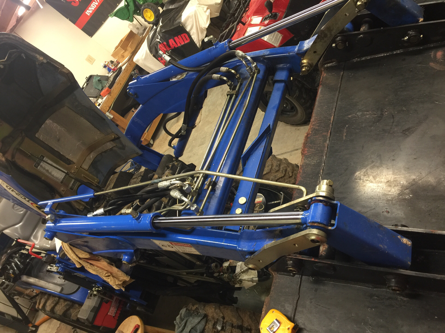

Cycled them to make sure they were full of oil, then raised the loader, to the point where the bucket was balanced. While it was up there I disconnected the lines and put caps on the cylinder inputs and it leaks down the same. It seems like that means both leak similarly, or one would hold the other.
Seems like the rebuild failed, any suggestions or recommendations on buying new cylinders? IMG_7707.JPG

Trusting that you cycled the curl at least 20 times.....
There are several designs of cylinder seals. some are more accommodating of bore irregularities. (Check Chicago Rawhide "CRC" for additional info) First check with the shop that did the repair. They may have a useful solution and be in a position to try to "make it up to you". After all, they want a good reputation based in useful repairs.

Only that with any air in the system, all bets are off. 3X is not enough.
Plus, seals can either "bed in" and get better, or ...not.
The proof of the pudding is in the tasting!
By the way, 15 seconds droop is excessive leakage. imo

Cycle the things back and forth for ~10 minutes straight. IF it still leaks, take them off and take them back to the shop that did the rebuild.
CAnnot advise on new cylinders without knowing what size cylinders were used. For a direct bolt on swap....OEM is gonna be best bet. IF you dont mind a little modification to get something to work, you can probably get close with aftermarket.

Put it back together and cycled for 10 min straight. After, the no load full dump time is 80 sec with all the lines connected normal. Pulled the lines and put caps back on the cylinders and got the same time. Guess I'll take them to the shop Monday.

Before taking anything apart, I would first call the guy that worked on them.
Explained to him that you cycled from full curl to full dump for 10 minutes straight. You did this in hopes of accomplishing two things...1. Seating the new seals, and 2. making sure ALL the air was purged out.
While things certainly got better, going from 15 sec to 80 seconds, it still isnt right.
Let him know that you have isolated the cylinders and capped them to rule out the valve or the couplers as the culprit. And that there is an issue with both the cylinders.
See what his suggestion is. He may "remember" the shape that the cylinders are in, and maybe there is nothing he can do. OR maybe he will try honing them again????
At this point I'd be getting some measurements off the cylinder....bore x stroke, pin diameters, rod diameters, width of cross tubes, etc and be seeing if I could find something aftermarket.

Hallelujah I think it's fixed it stayed in this position for hours.
Took the cylinders back to the shop, the guy said he could see some damage to the seal in the middle. Also said he did some measuring and used a slightly different larger seal? No charge for the work the second time.
Personally I think they didn't measure/ use the correct seal the first time. My impression is that New Holland parts are less common or an odd size compared to others.
Regardless, the guy made it right as best he could.
My question now is:
My tractor takes some odd hydraulic fluid (Ambri multi-g).
Was it necessary to remove the oil the shop used in the cylinder for testing so that I wouldn't contaminate mine with a different oil? Or is two cylinders worth not enough to worry about? Actually I guess it would be 4 or 6 cylinders worth at this point...IMG_7746.JPG
