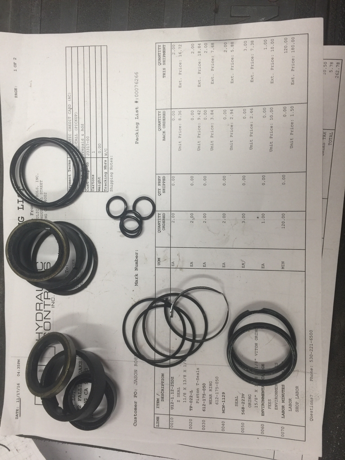

Got it all reassembled and got a nail in the tire immediately after on the way back from using the pressure washer on it. Oh well now it's put away clean and ready to roll next time the beaver makes our road impassible.
The first pic shows the parts that were clearly bad, the second shows the final bill to rebuild two cylinders ($260) and all the parts replaced.
The guy who did the work said there was a bit of rust in the cylinder that he honed, that seemed odd, but a long time heavy equipment contractor said this guy was the best.

Thanks for the update Lex, glad to hear it was indeed the seals.
Now that you have the o-ring sizes, you can do the rebuild next time yourself :thumbsup:

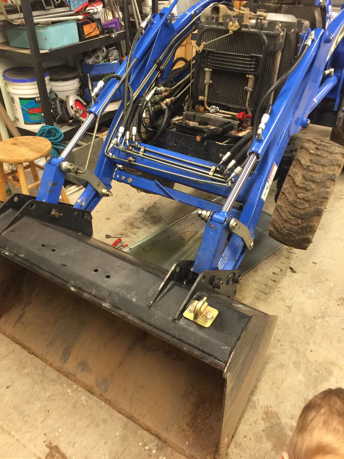

So I tried to determine if it was the valve.
The problem is the same with all the QD disconnected. So I think the valve is fine.
To give you an idea of the speed of the leak down, it takes about 15 seconds to go from full up to full dump.
Still no oil leak visible, which makes me think it's sucking air, I can hear noise in or by the cylinder while it leaks down.
I wondered if it leaks up or maybe that would cause a visible leak. raised the front of the bucket by extending the curl see photo... **** thing seems to hold. I couldn't disconnect the QD under that pressure, so I'll leave it up overnight, I guess theoretically it never spends much time with a load on this direction.
At one point I pressed the nipple on the disconnected QD and got foamy oil from the side that should have sucked which would fit the sucking air by the vacuum from the cylinder extending. I replaced that QD to be sure.
Could the cylinder leak in just one direction even after rebuild?
