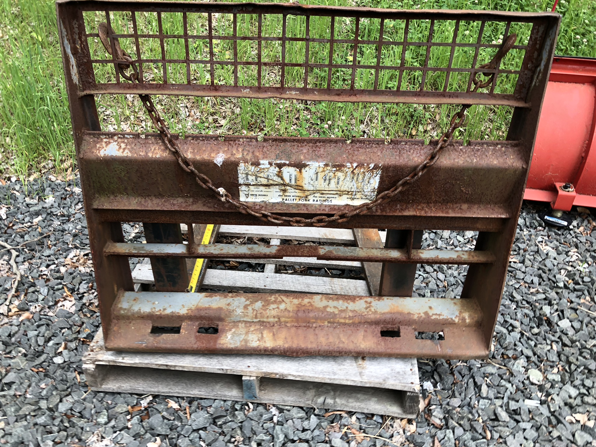

Tractor is a 5460-1 2014 vintage. Loader is LA1055.
No modifications. I bought the tractor as a used winter rental from Marshall Machinery with a little over 200 hours.. The loader was originally unable to pick up a round bale with only about 1200 psi at the loader ports. Marshall Machinery sent a loaner up (3 hours each way), picked up my tractor and adjusted hydraulic pressure to high end of spec.
Forks are 48 inch skid steer forks. They were free and have no ID left on so not sure how heavy duty they are. Forks are 1 inch at the mount and I'm guessing about 300 - 400 pounds.
2400 is my guess for pallet, pellets and forks. Could be a little less but I was not maxed out on lift capacity.
The surprising thing was the tractor was stable front to back and didn't want to nose down. Of course the Michelin front tires have a lot higher load capacity and the heavy box blade on the back is a must.

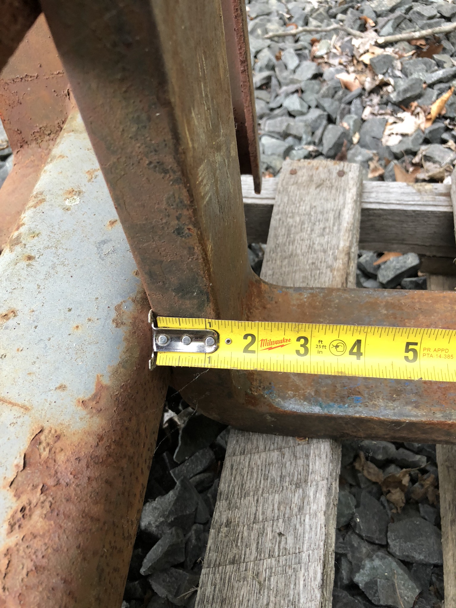

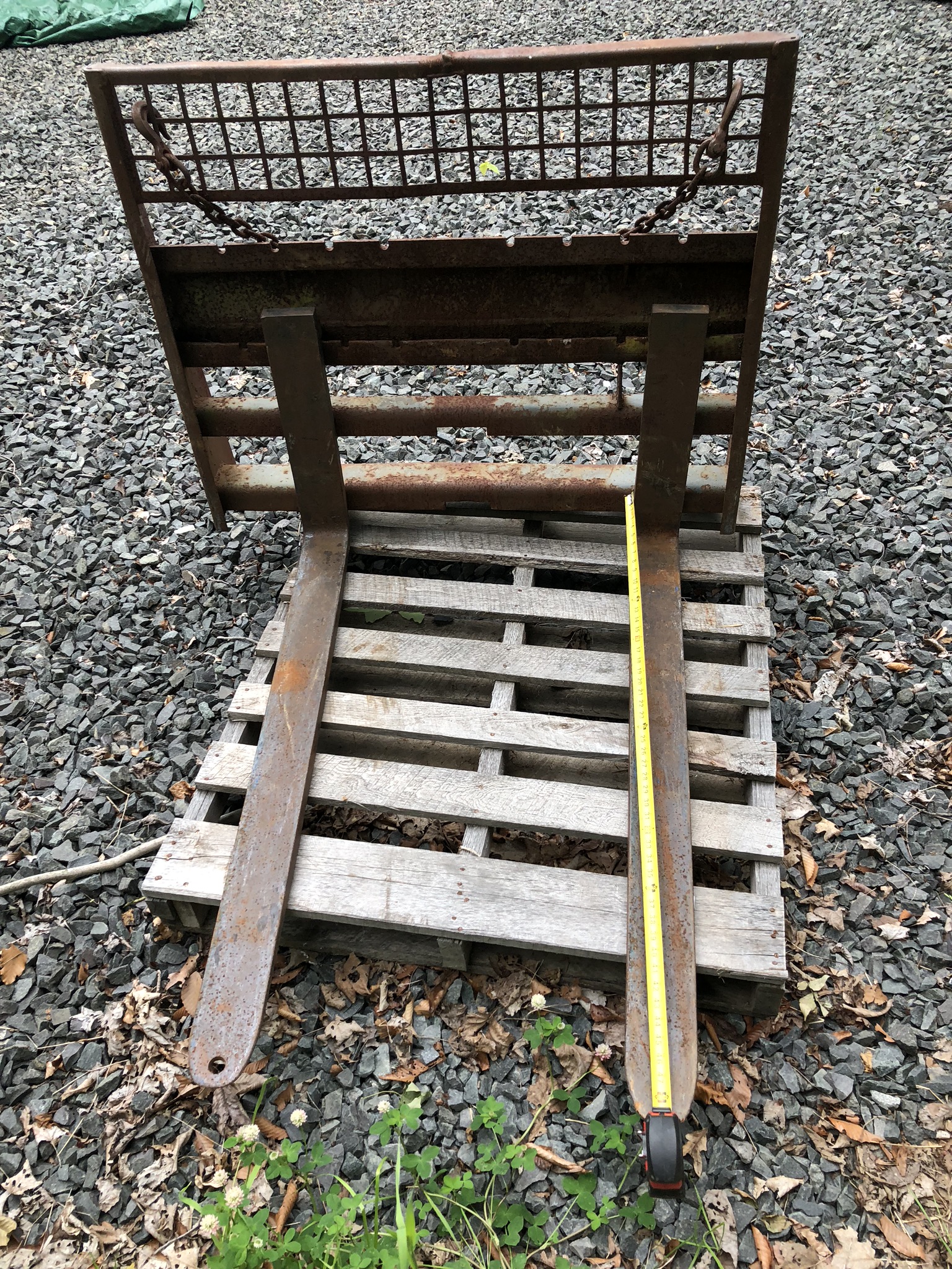

Thanks for the follow up information and pics. My forks are roughly the same, so it should be an equivalent. I'll have to talk to the kubota people and see what they can do about the loader and ask some questions about the specs. Thanks again.

I purchased my L6060 HST and LA1055 FEL in 2017 also from Marshall Machinery. They are only a mile down the road from my place. My 48" pallet forks appear to be identical to the one in your picture. The 1730# max lift capacity I tested was with the max recommended 2600# of pressure measured at the FEL port.
I would love to know how you manage to lift 500+# more than my nearly identical machine. I know it is possible to bump up the FEL port pressure by 10% or so above max. Perhaps that is what Marshall did with your 5460. Do you have a way of testing it? I'll ask about a possible modification to my L6060 next time I'm at the dealer.
I was also surprised at how stable the L6060 was handling the (albeit slightly less) load with a 1000# implement on the 3pt.
In any case, thanks for posting your results.

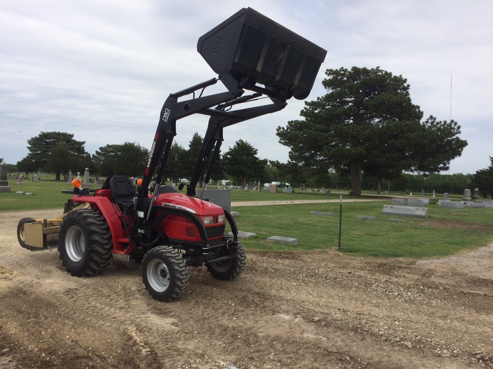

Something to consider might be an aftermarket loader for a new tractor. An example would be a Westendorf TA-111 FEL as shown in the attached link which I recently added to my "loaderless" Mahindra 3015.
The Mahindra ML110 loader for the 3015 is rated at 1350 lbs at the pin at full height while the TA-111 is rated at @ 2100 lbs at that point and the same 2000 PSI relief setting. (interpolated the TA-111 specs of two given PSI)
I did some measuring of the actual geometry of the 2" bore lift cylinders and loader arms on the Mahindra/TA-111 this morning and came up with these numbers with the BUCKET ON THE GROUND:
Breakout force at bucket pins--4158 pounds
Breakout force at 24" ahead of pins--2955 pounds
I realize that the loader loses capacity as it raises so I also did the calcs with the bucket FULL RAISED:
Fully raised at the bucket pins --2163 pounds
Fully raised at 24" ahead of pins--1540 pounds
Might also mention that the Westendorf TA-111 is 97" from ground to pins at full height where the Mahindra ML110 is shown at 95.5".
The 2955 pounds breakout force must be adjusted for weight of the attachment, weight of half of the loader arm length and friction. I would estimate that at about 600 pounds leaving @ 2355 pounds of actual lift capacity at ground level and 24" ahead of the pins.

Attached photo of the Mahindra 5030 with Westendord TA-111 loader might be captioned "Grandpa's New Digs" :)
