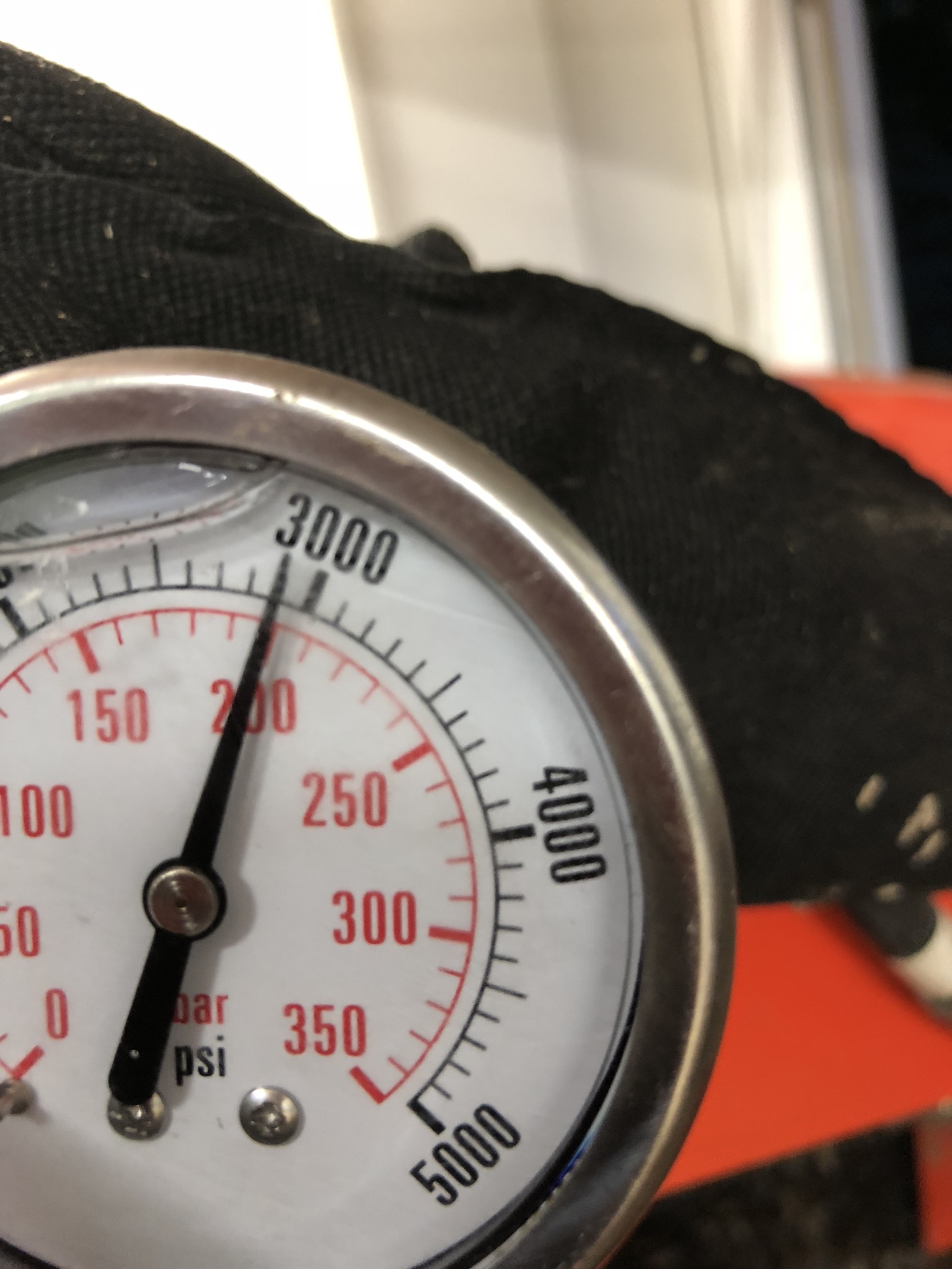

I purchased my L6060 HST and LA1055 FEL in 2017 also from Marshall Machinery. They are only a mile down the road from my place. My 48" pallet forks appear to be identical to the one in your picture. The 1730# max lift capacity I tested was with the max recommended 2600# of pressure measured at the FEL port.
I would love to know how you manage to lift 500+# more than my nearly identical machine. I know it is possible to bump up the FEL port pressure by 10% or so above max. Perhaps that is what Marshall did with your 5460. Do you have a way of testing it? I'll ask about a possible modification to my L6060 next time I'm at the dealer.
I was also surprised at how stable the L6060 was handling the (albeit slightly less) load with a 1000# implement on the 3pt.
In any case, thanks for posting your results.
Interesting. My hydraulic pressure is 2800 psi at 2000rpm and 2900 psi at 2500 rpm.
My previous 5240 HSTC with the same forks and ballast would not pick up a 2000 pound load but Daves does. My 5460 picks up a 2000 pound load but others don't.
A little extra hydraulic pressure may be the difference.
View attachment 558813View attachment 558814
Jim
In reading various posts on FEL capacity over the years, I've come to the conclusion that the max lift ability varies greatly even between identical tractor / FEL combinations. Hydraulic pressure is likely the biggest variant but there are others to consider.
Pallet size and weight distribution can also affect capacity. The farther forward the center of mass is from the pivot point, the less the FEL will lift.
Obtaining the actual weight of your test pallet is another issue. Keep in mind, if using the bill of lading or shipping receipt to determine weight, those figures are often inflated.
Thanks again for posting your pressure. I'll try bumping mine up a bit and do my brick test again.
