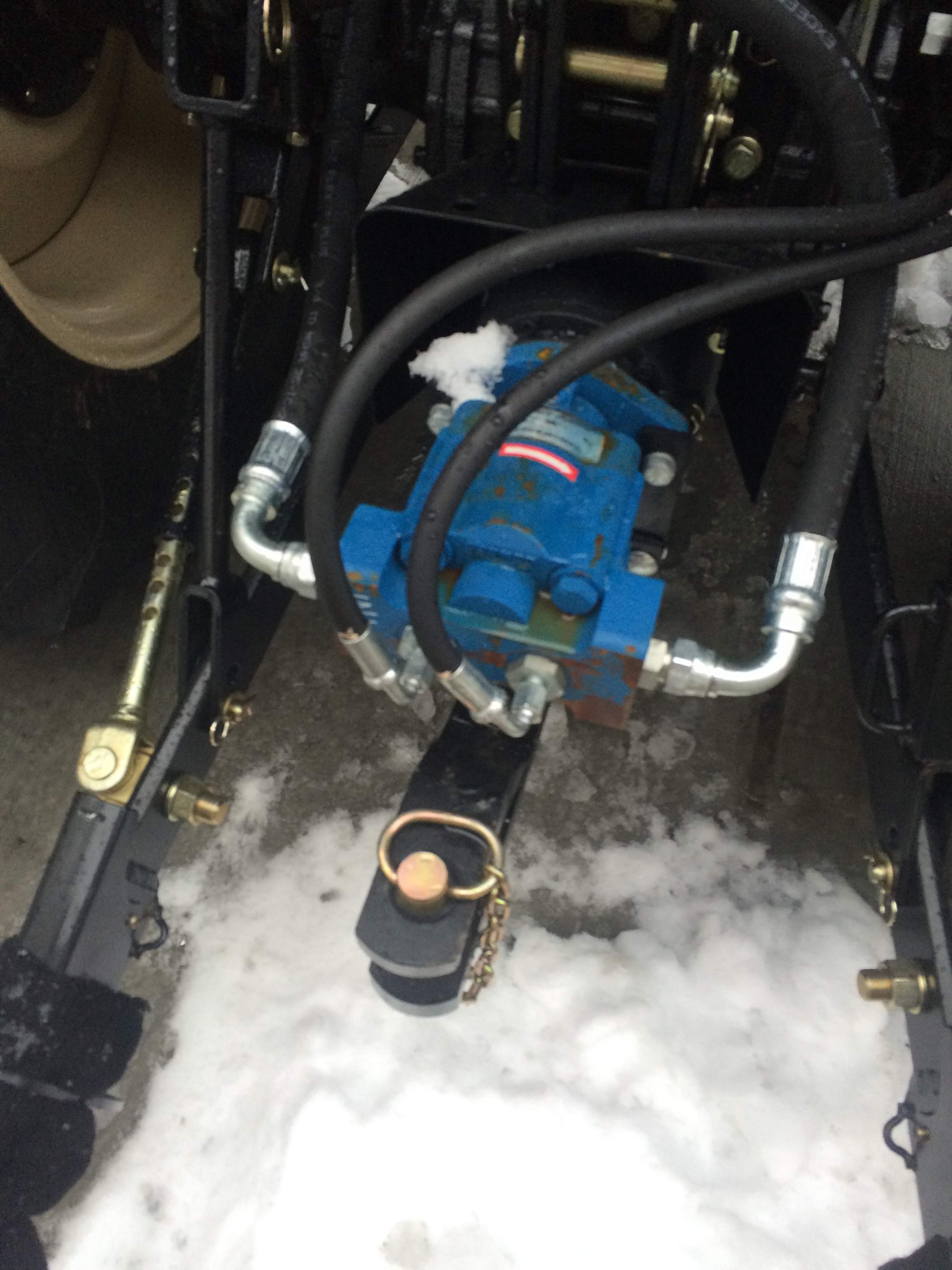

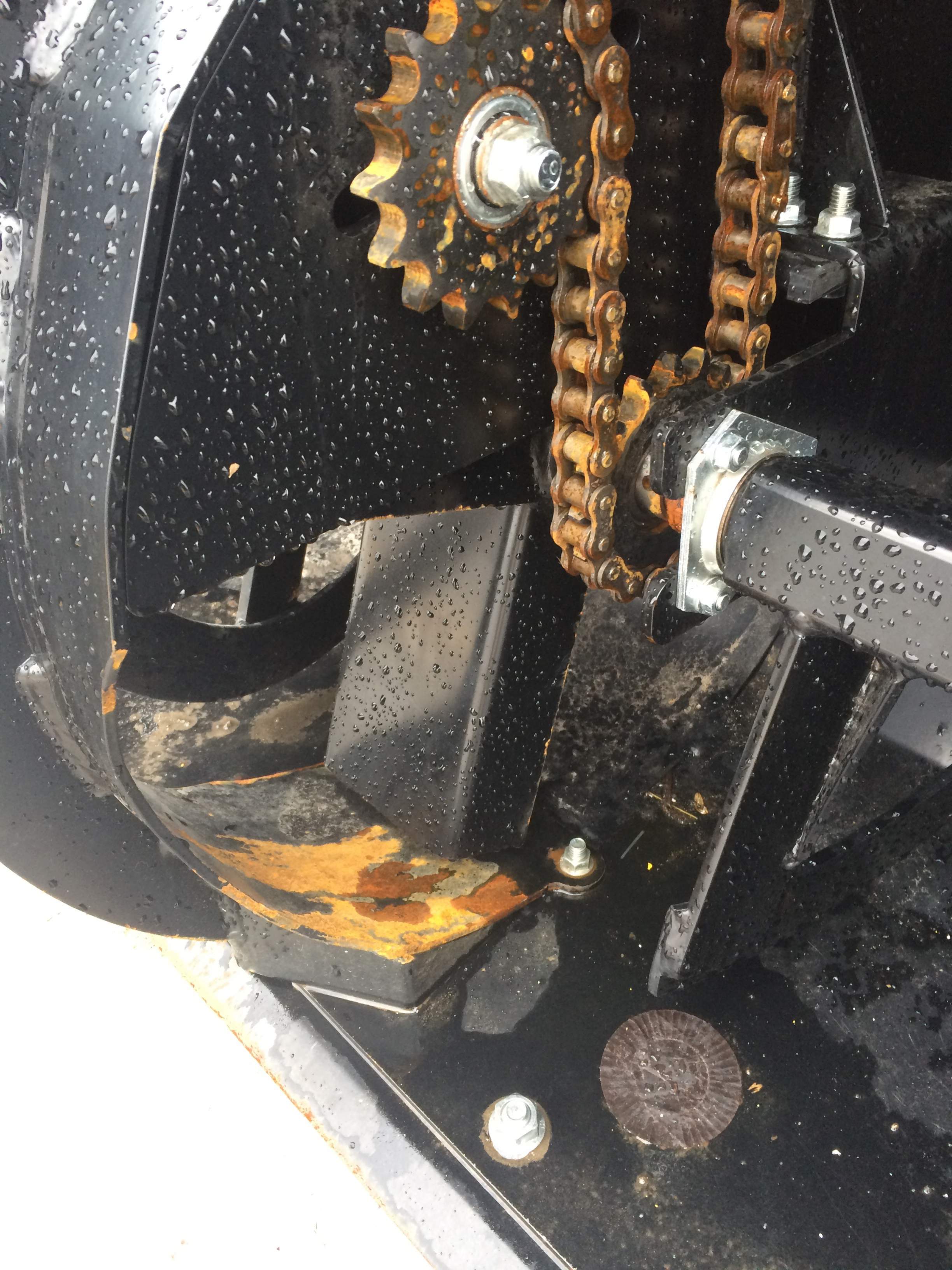

OK here are the pics from the dealer modified blower. If you look in the bottom left corner it does say HARDY, so I guess my assumption is correct.
The cylinder for the chute rotation was removed.

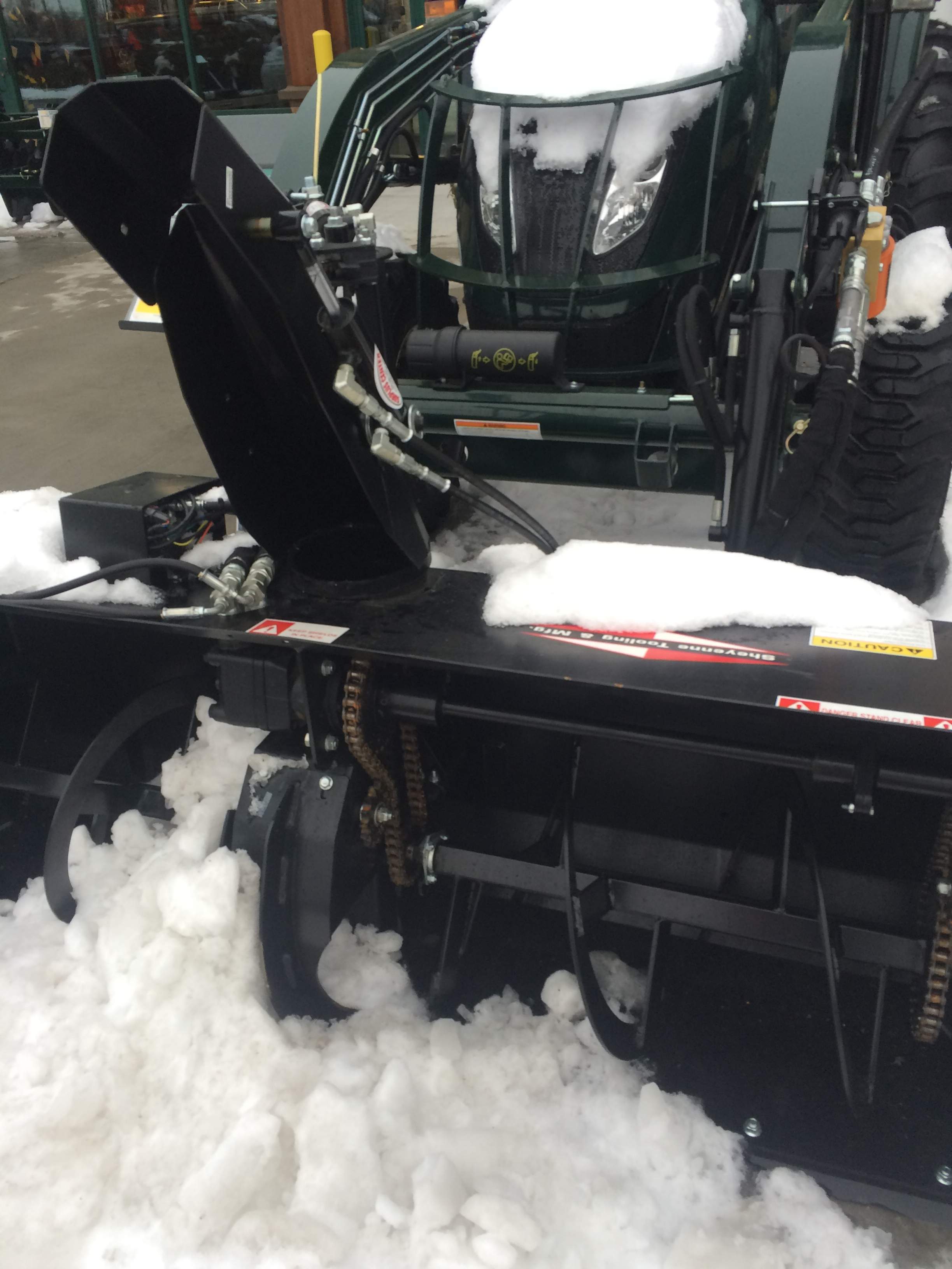

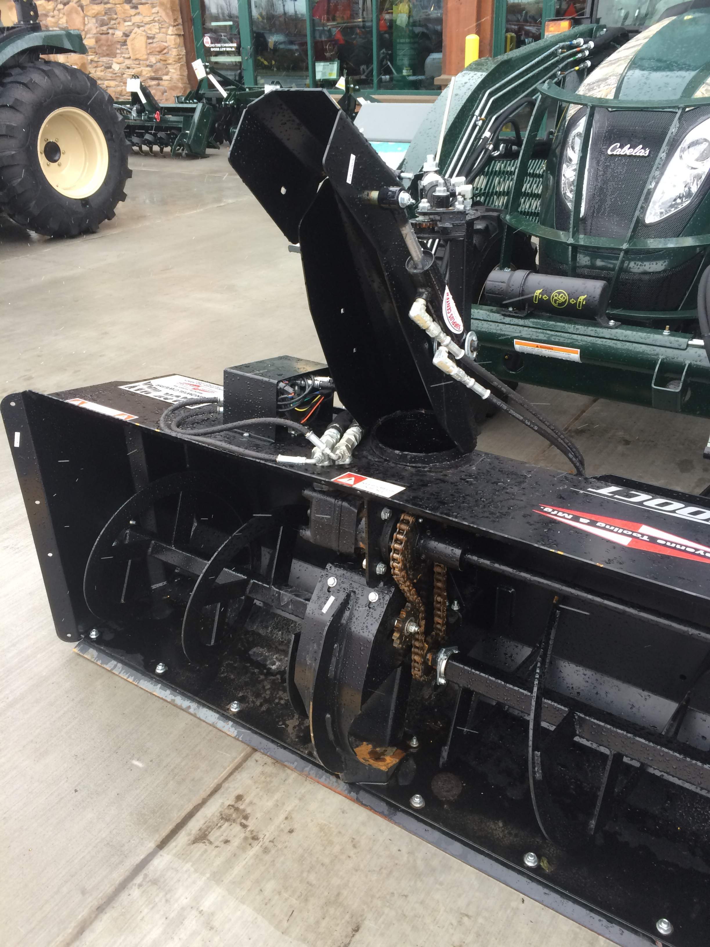

I was also back at Cabela's and here are more pictures of the Sheyenne Toolings model.
ST 2.jpg (not sure I like all the hardware just for the chute rotation)

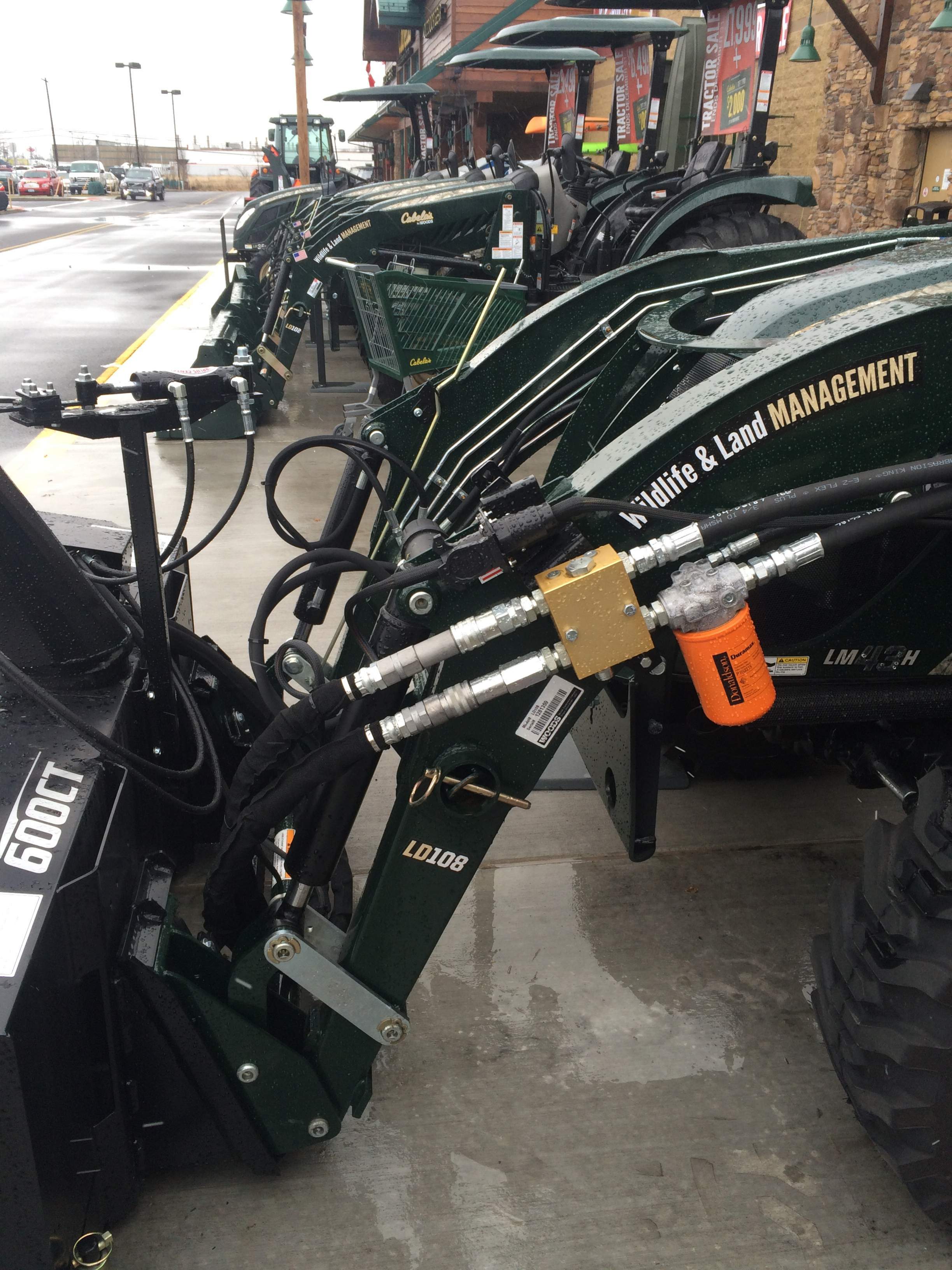

Extra filter hardware on loader arm.

With a step up gear box, two ports of return for cooling, and an extra filter that would also function as a cooler, I would not be worried. I think I am interested.

My original posting was for my dealers built blower. Which appears to be a Hardy Lynx, by Pronovost, 3pt blower that they modify to loader mount. He also uses a power pack which he did mention something like 25 gal. Seemed like a good price compared to all the others I priced.
