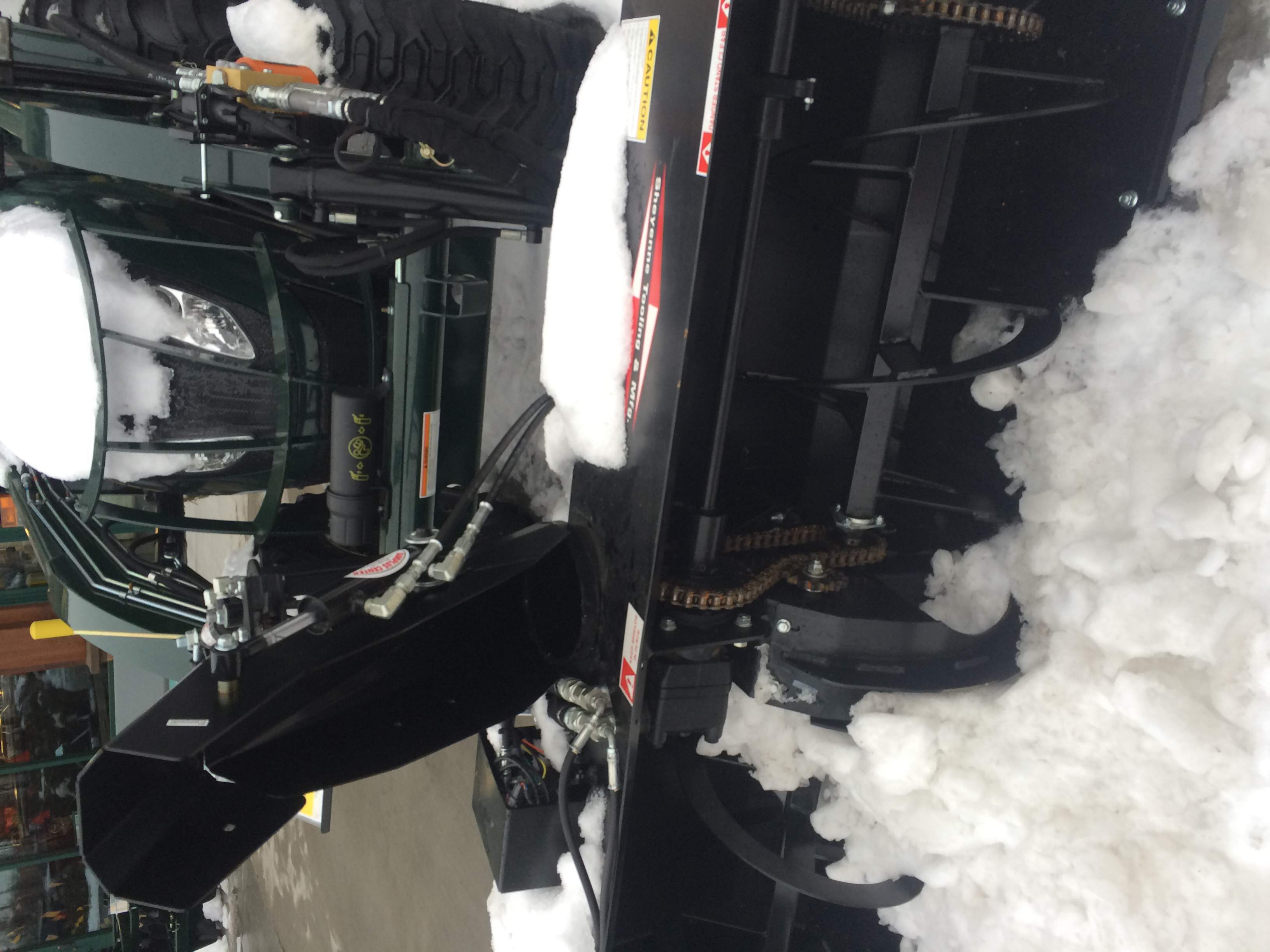

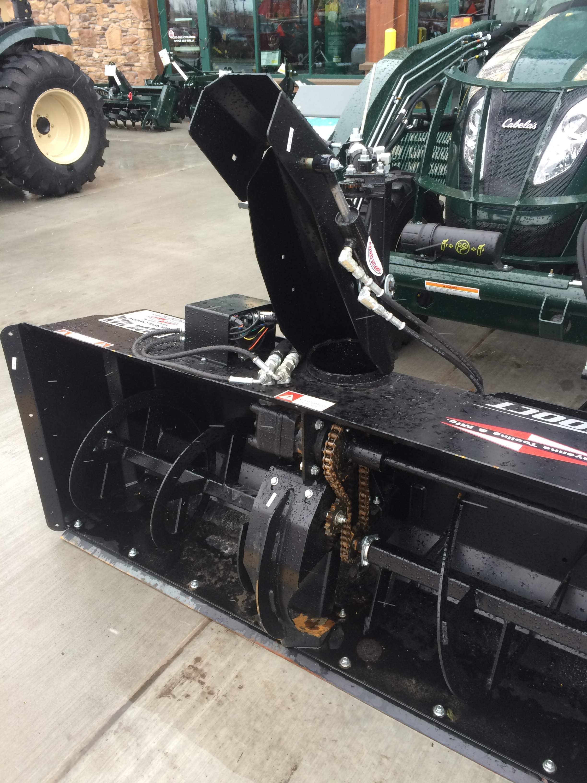

I've been on their website several times. Sheyenne Tooling & Manufacturing They have a couple of videos. All the hydraulic fluid used to run their blower comes from the tractors system. They tap into your tractors system. That's the difference between theirs and all the other systems I have seen. (This excludes skid steers, they have the hydraulics to handle things like this). All the other systems have a power pack. Basically a separate hydraulic reservoir on your 3pt and a PTO driven pump.
Here is the one I saw at Cabela's.
(sorry for the sideways pics they are off my phone, not sure how to rotate them on here)

That explains it, I was wondering how they were selling them so cheap. Sounds like a good way to burn up your hydraulic system??? I'm surprised they get away with that.

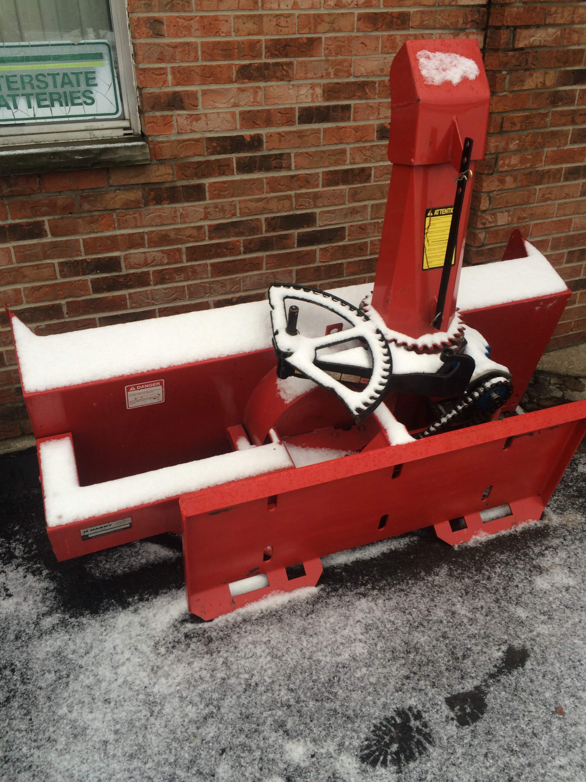

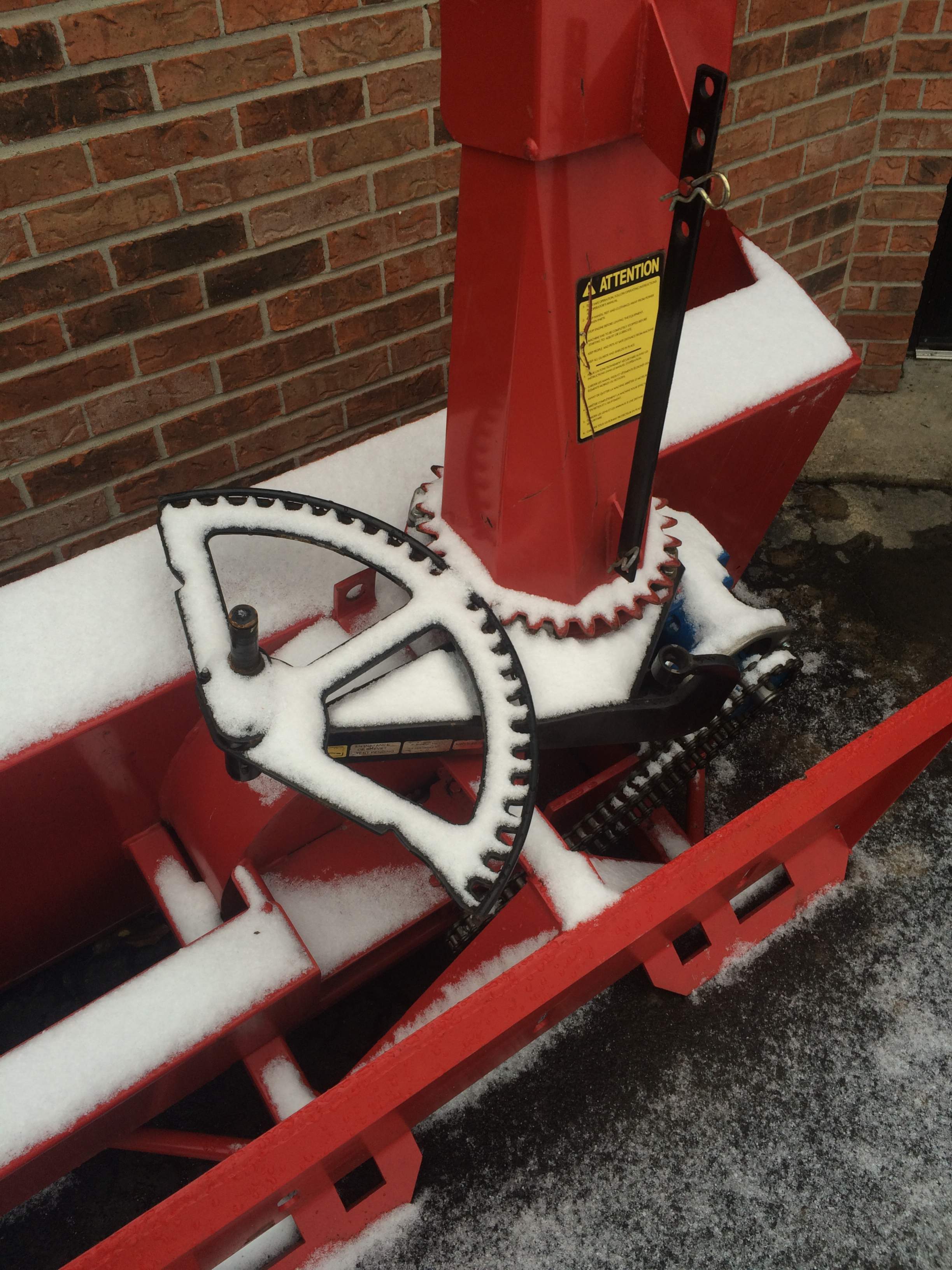

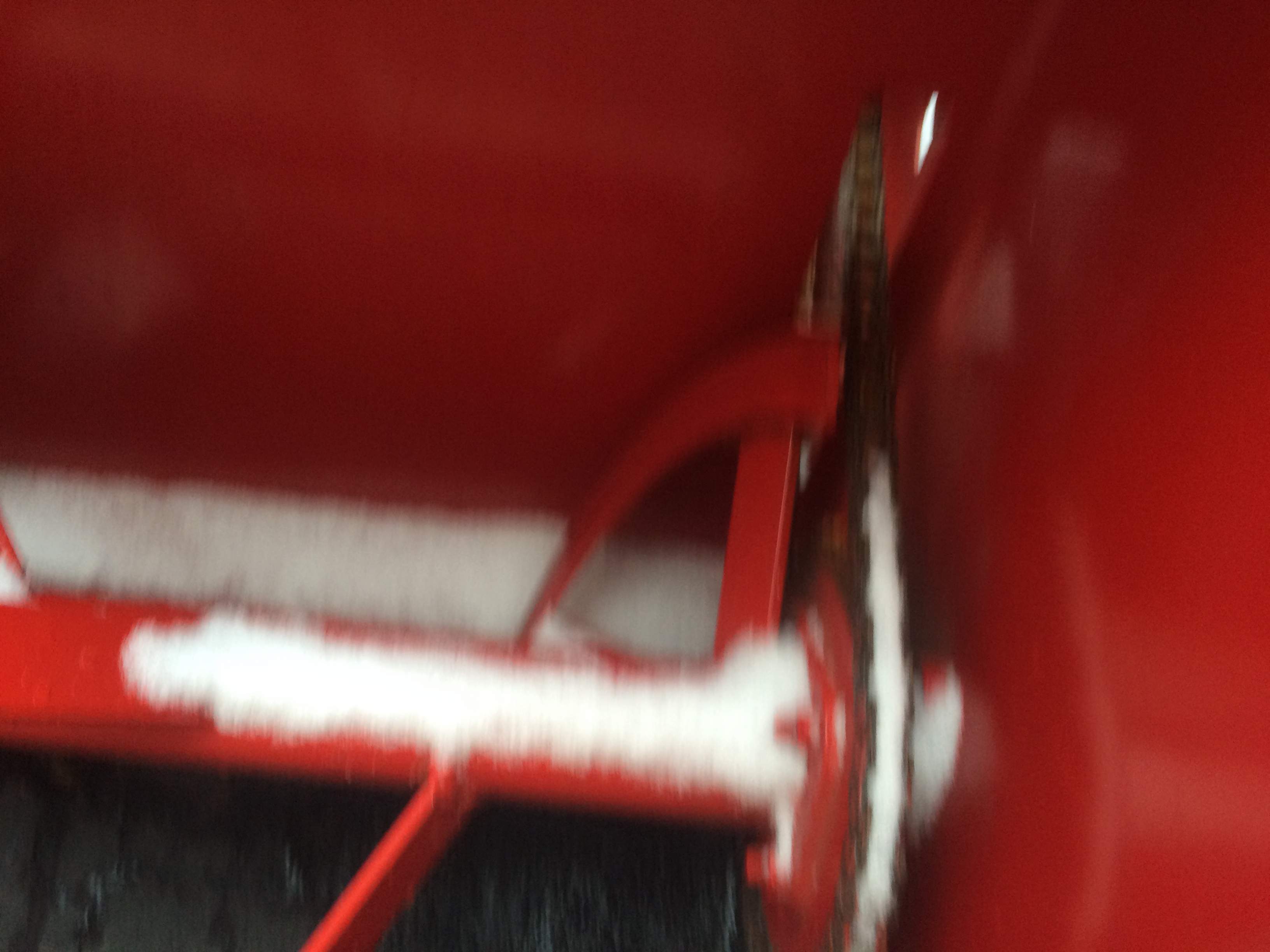

OK here are the pics from the dealer modified blower. If you look in the bottom left corner it does say HARDY, so I guess my assumption is correct.
The cylinder for the chute rotation was removed.

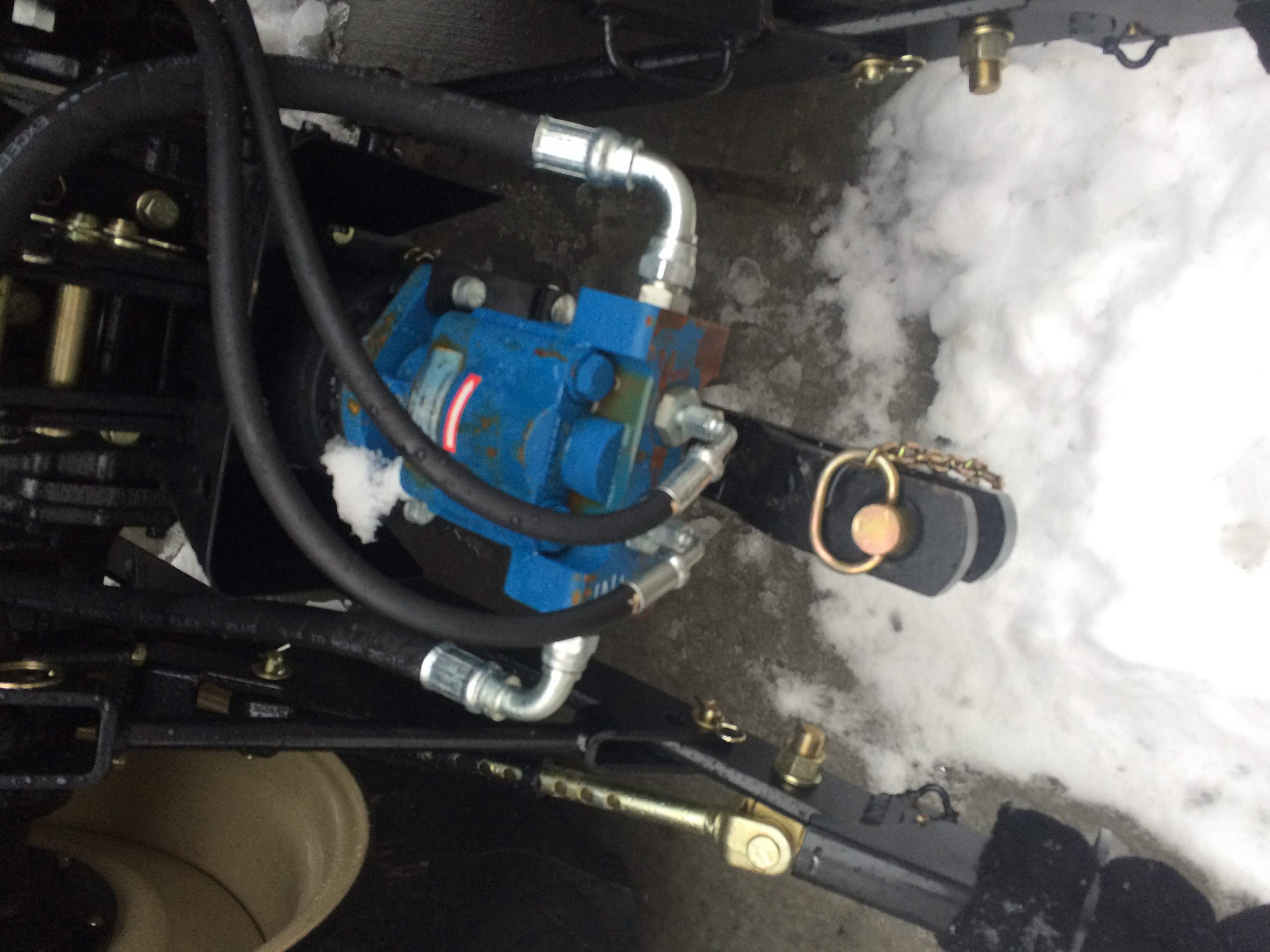

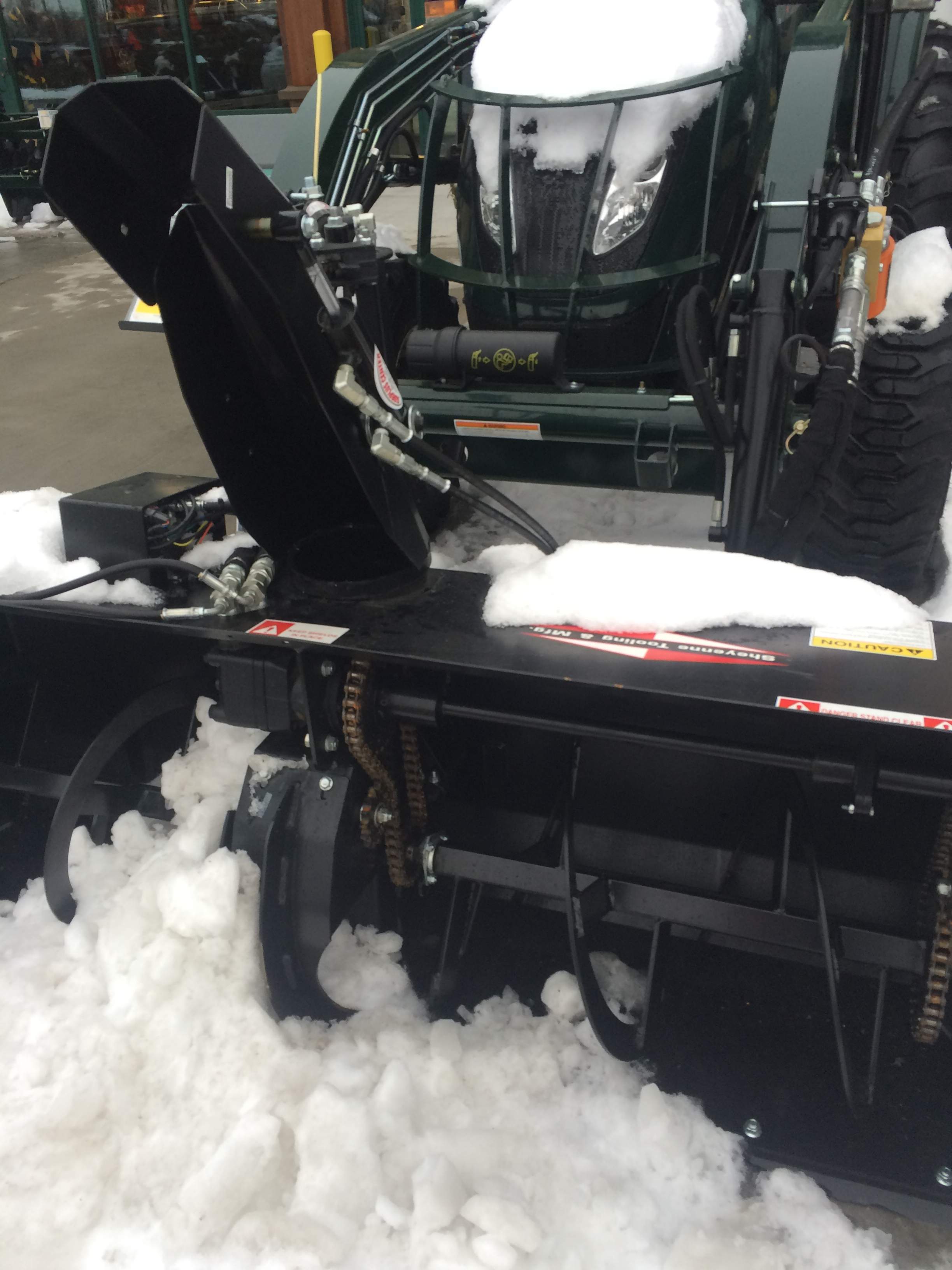

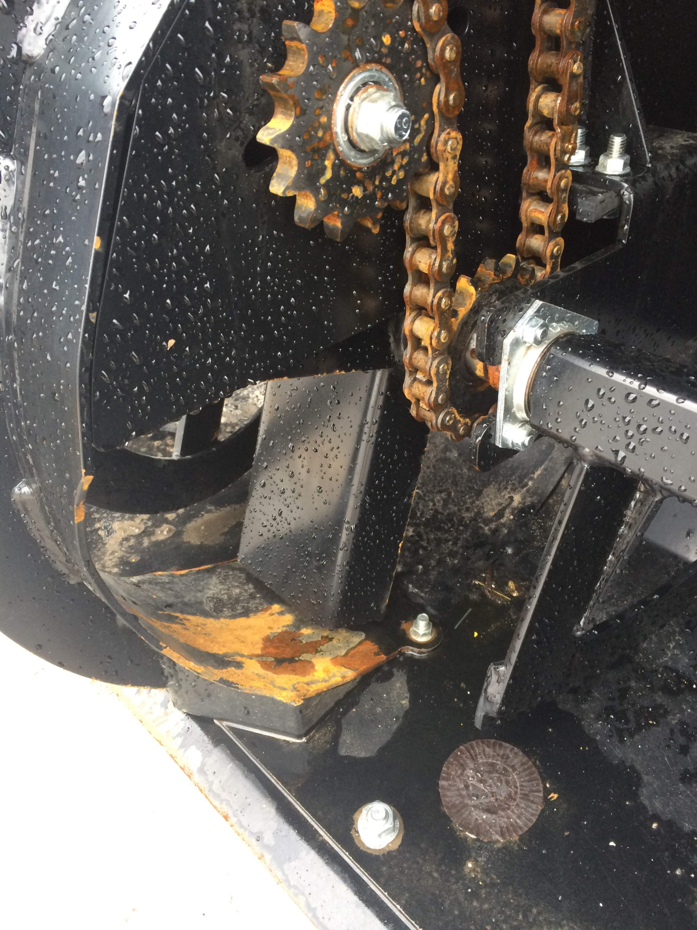

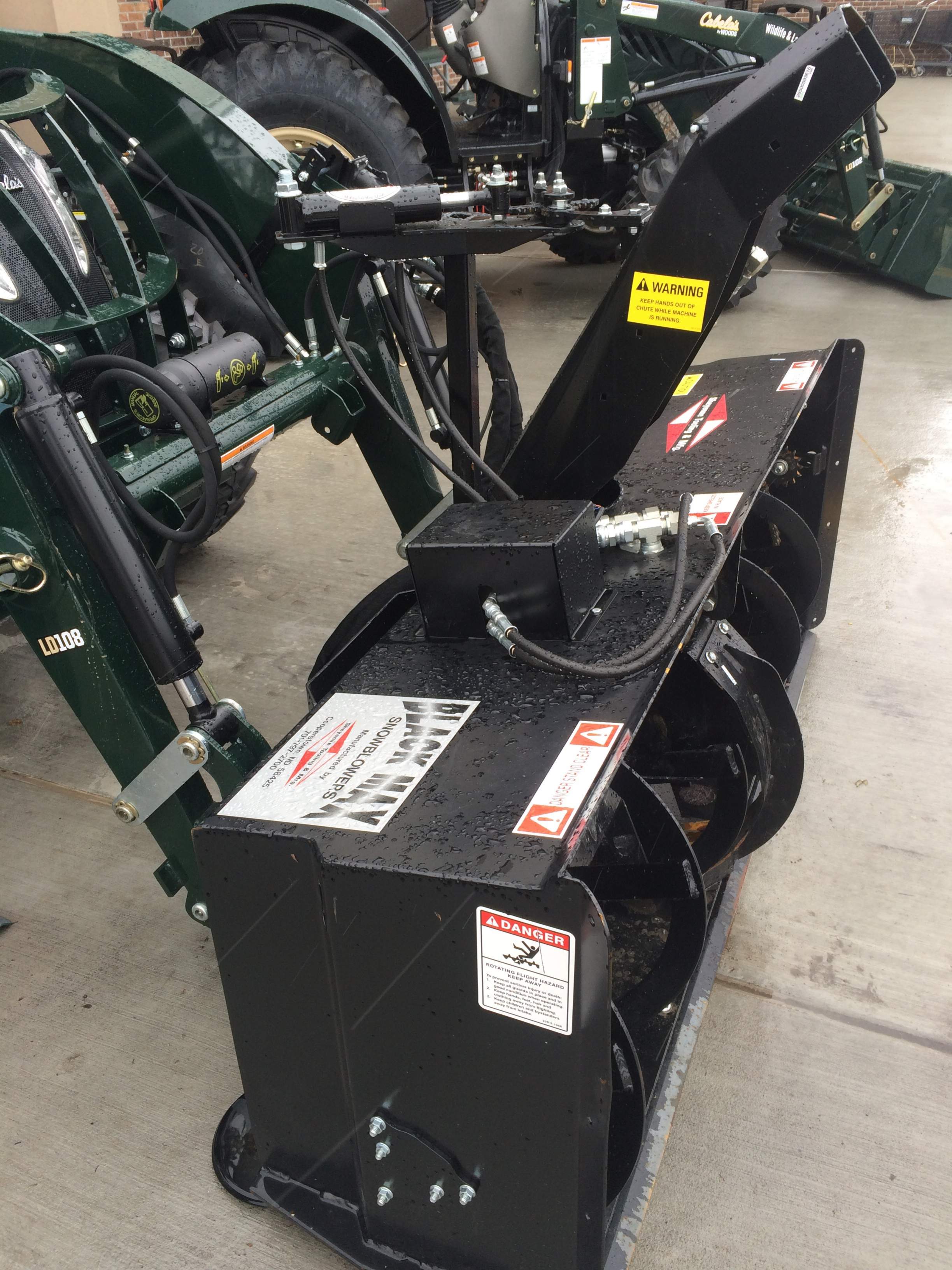

I was also back at Cabela's and here are more pictures of the Sheyenne Toolings model.
ST 2.jpg (not sure I like all the hardware just for the chute rotation)

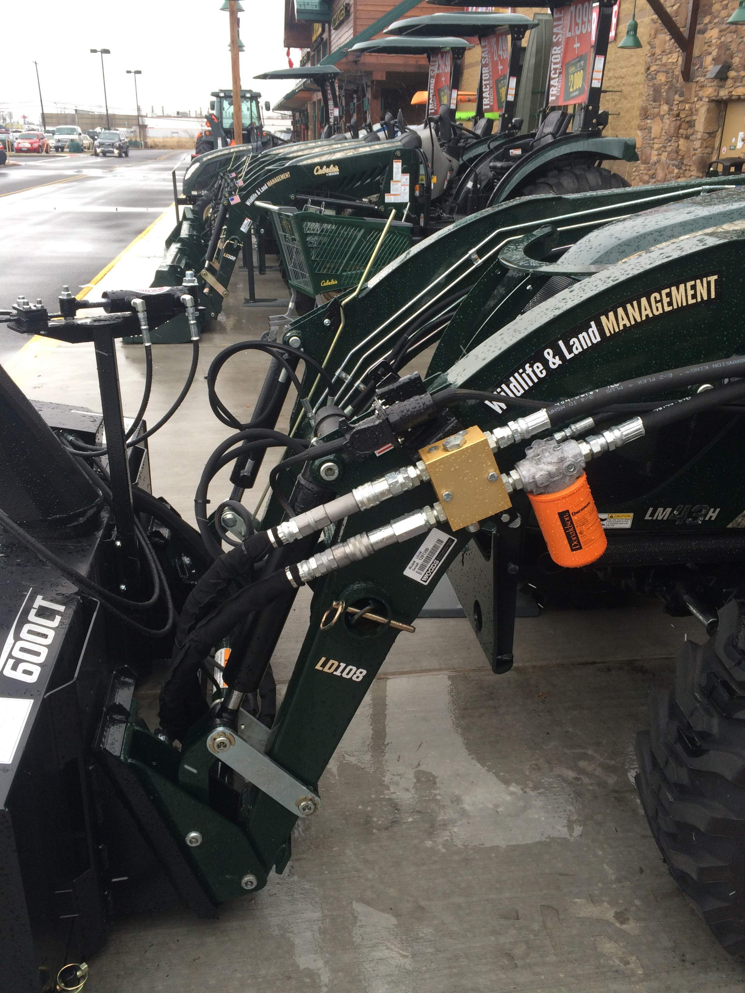

Extra filter hardware on loader arm.

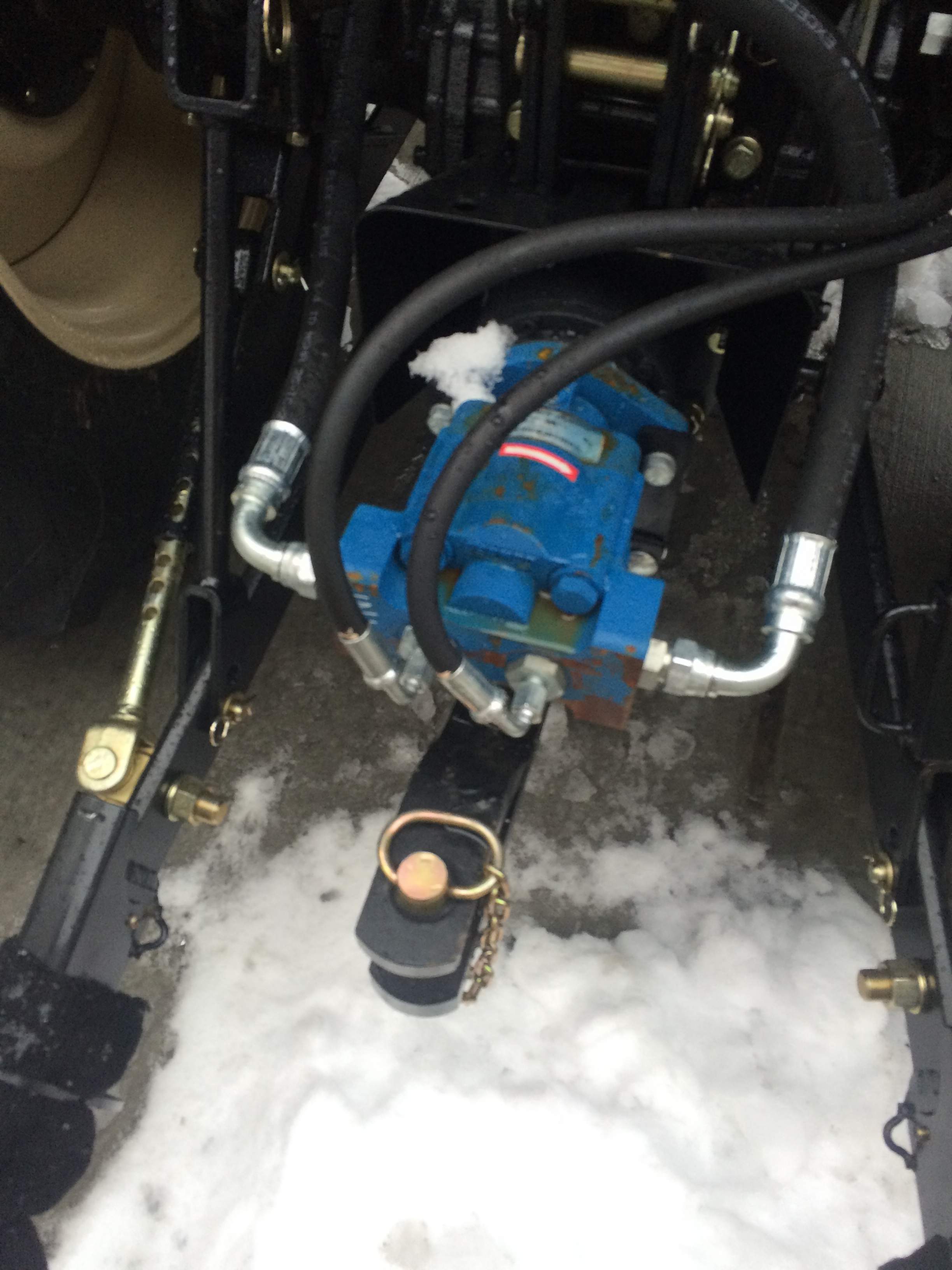

PTO pump

Just for info on the Rear Power Pack and Tractor Loader Front Snow Blower cost. I took my existing 6' rear blower + some steel and mounted sans 6' Kubota 852 bucket. I had a 3 pte rack where I mounted the 20 gpm pump and 25 gal. tank. 3/4" hosing et al came close to 3,000 dollars US. I have it on a Kubota L4610 glide-shift and it works beautifully. Sounds like the subject super sale is indeed that.............. There is much work to do what I did plus owning the blower. One thing using the existing tractor hydro fluid would help to heat it up...................... mine runs barely warm and I have used no more than 15 gallons of tank hydraulic fluid. I have posted plenty pictures here on my build. Once you have one of these you'll never look back...............
Carl
I'm not endorsing using the tractors hydro supply................
/ Loader mounted blower #16
tell you what, i have a loader mounted blower, and it has a separate 25 gal hyd tank.After an hour of blowing snow, that tank is hot to the touch. Id hate to think of the tractors system running this blower.
im actually thinking of adding a transmission cooler to my setup.
/ Loader mounted blower #17
With a step up gear box, two ports of return for cooling, and an extra filter that would also function as a cooler, I would not be worried. I think I am interested.
