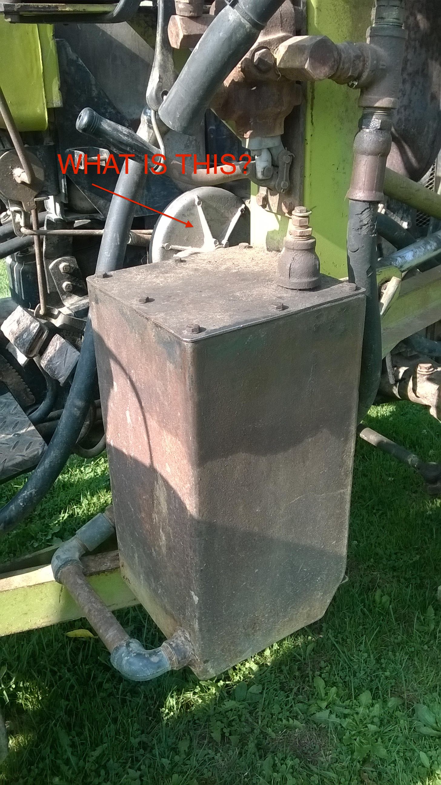

If my attempts today to get the front fittings tightened up don't yield any results, I think I'll remove the filter to see what happens. This fluid is pretty thick and maybe it just can't get through there fast enough. The old system had something on it before returning to the tank, but I couldn't figure out what it was. Here's a photo taken right after I bought it. Here's a photo highlighting the mystery item. It's a disc shaped item, looks like a filter of some type but I couldn't figure out how to clean it and figure replacing would be better.
My guess it was some sort of screen, but it is hard to tell from that picture. You say the fluid is thick? Like gear oil? It should be fairly thin, like a very light motor oil.
