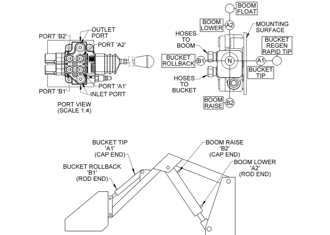

#64
I posted earlier about the regen.
I still believe that might be your problem.
The schematic says to hook up the boom to A+B 1 and the curl to A+B2
I'm open to all suggestions, but honestly, I don't know what or how to check for regen problems. I'm following the drawing below and I double checked it yesterday and this appears to be correct based solely on following the hoses. BrandValve.png
That is not how you have posted that you have it hooked up.
I know this thread has already gotten kind of long, maybe I mis-spoke or mis-typed. I'll have to re-read to see where I explained how the loader lines are installed.
   / Loader refurbishing worse than when I starte
#65
Regarding the possibility that the hoses are reversed on the pump ... I don't think so because there is some functioning of the lift arms.
I've come to this conclusion myself. Things more or less work at this point, it's just loud (like something is about to break soon and frothy.
The pegging of the guage over 4000 is a big clue and a big concern. I wonder if you have hoses from the loader plumbed incorrectly. A circuit is made up of an A1 and B1, and the other is A2 and B2. If you plumbed A1 and A2 to a cylinder and B1 and B2 to a cylinder it would be incorrect, but I don't know how it would behave.
I adjusted the pressure relief valve down to about 1000 psi and it seems to be bypassing at this pressure. I haven't tried to turn it back up yet. Maybe something was stuck in there or it was set incorrectly at the factory. I'm more comfortable about this now that the pressure isn't spiking and trying to stall the tractor. The front pump is coupled to the front shaft with 2 shear pins. One was sheared off because of the spiking nature of this. Seems much better now.
I think you need to double check how you plumbed it from the loader control valve. This can be confusing, so look carefully. From the pictures, we can not trace where to lines go on the cylinders.
I realize that. If I can locate some different colored tape tomorrow I'll color code them and re-photograph.
Also, double check the return to tank line is plumbed to the correct port on the valve.
Will do.
