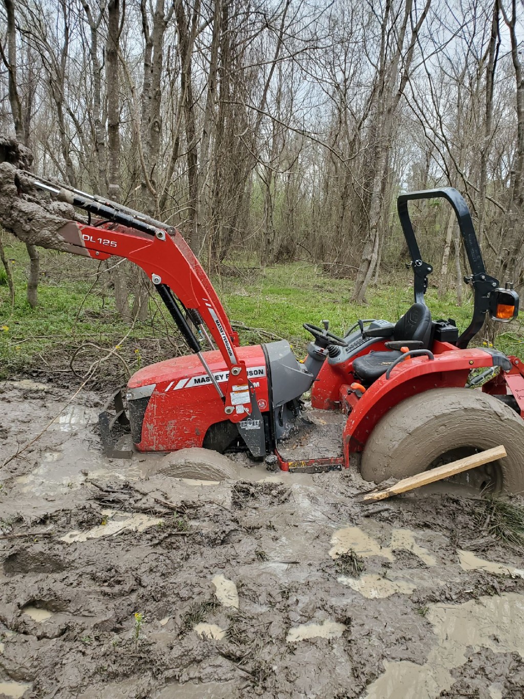

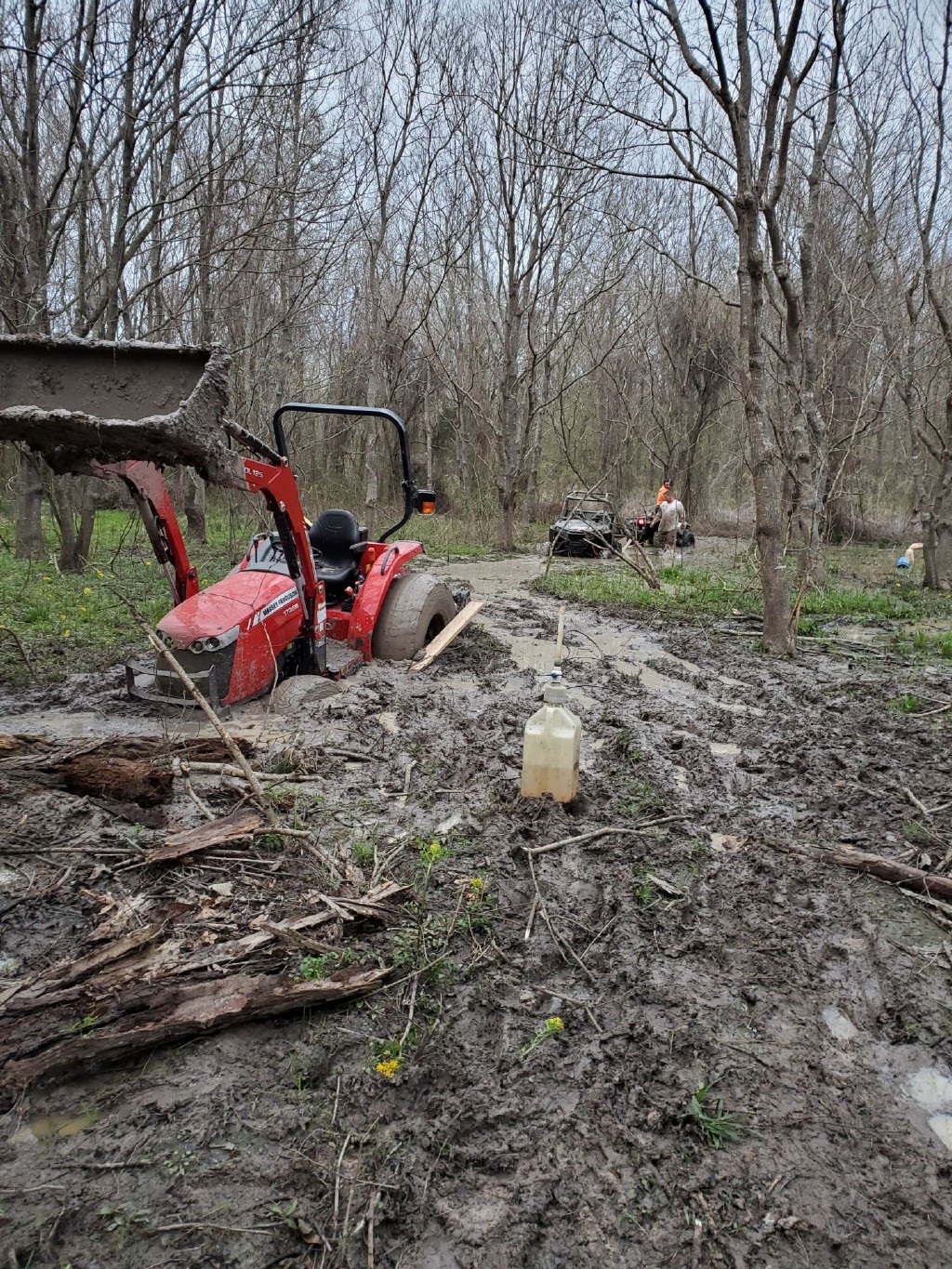

This led me to getting it fixed. Put a 4x4 under the bucket. Could not relieve pressure on quick-connect by tapping on the male end, or even pushing hard against a piece of metal but, a c-clamp did the trick. As soon as it stated to relieve, the bucket tried to drop down but the 4x4 stopped it. Then used the c-clamp to relieve the rest of the pressure..... quick-connect snapped right in. Fired up tractor, bucket works !!! YEA !!!
Then was able to use the bucket to get un-stuck. A local logger had come out - he worked on it for about an hour trying to get it out and finally said it could only get out by using a dozer - the land was pure marsh. Getting the bucket fixed was the trick.
btw: Here's a trick I learned from the dealer - with the bucket up higher, there was a tremendous amount of pressure in the hydraulics.... push the joy stick all the way forward to put it in "float mode". that took a lot of the pressure off.

Pics of the demise
