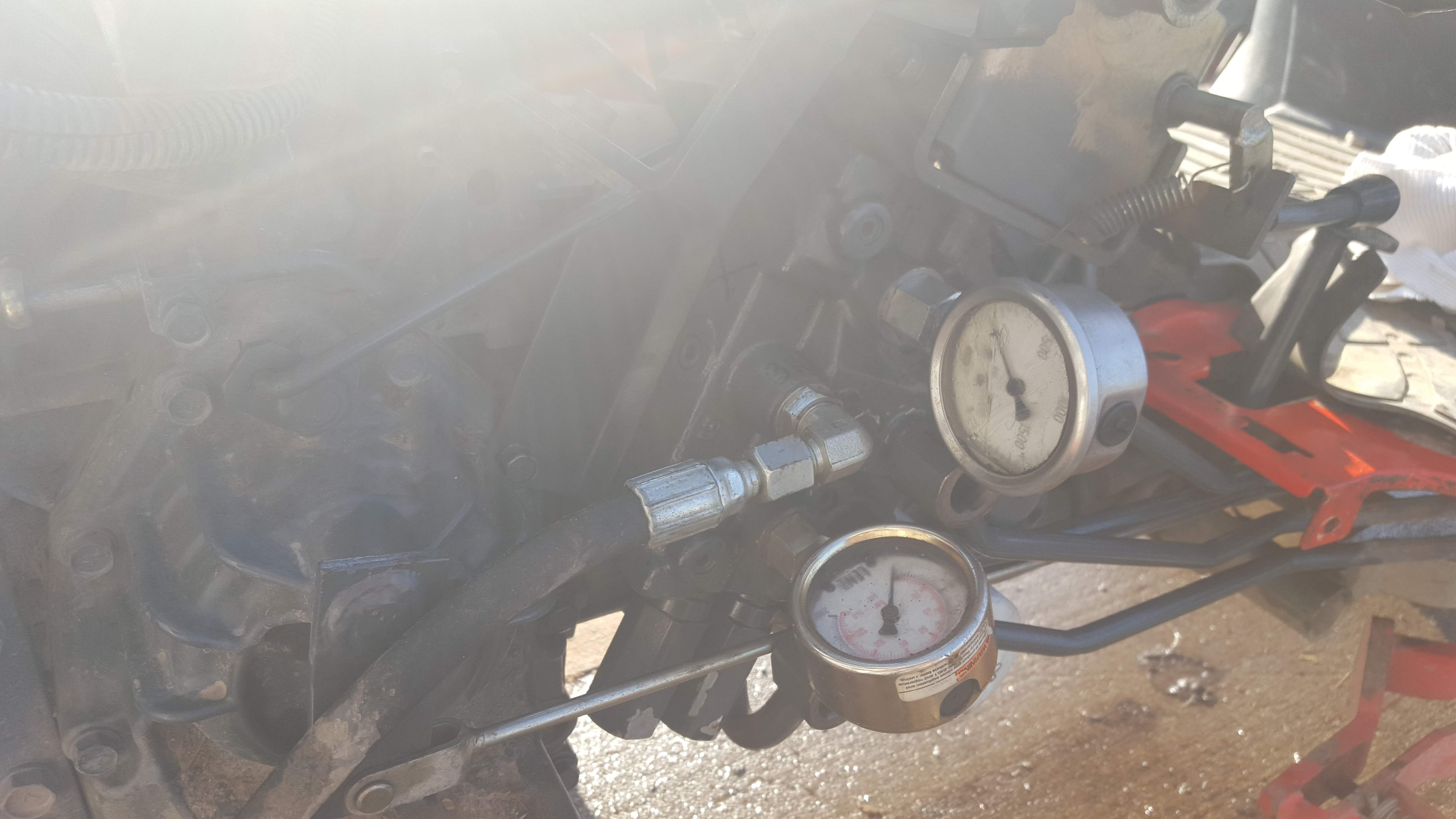

Thank you JJ and LD1. With guages directly mounted to the curl ports on the loader valve (not tee-d in), when I push the joystick out to the right, the top guage shows max pressure (2000) and when I let the joystick go, it bleeds back. Then when I push the joystick back in to the left, the bottom guage stays at zero. So I can't see any reason to plumb the hard lines back and open the lines at the cylinder to check on oil flow. With no pressure on the lower guage, it seems to me and my local hydraulic guy that the problem is internal to the loader control valve.
I'm shopping for a new or used loader control valve now. Thanks again.
/ Loader Valve / Curl function diagnosis
#23
Btw, I just took the guages out and reattached the curl lines, removed both quick connects from the lines. I applied pressure and got oil flow on one line but zero oil flow the other way. One last test verified no flow.
/ Loader Valve / Curl function diagnosis #24
It does sound like a valve.
ITs hard to see in that picture, where you lines are hooked, but is that the actual valve? How is the joystick connected to that? There could be a problem with a linkage or something that when you pull the lever to the left that you arent actually moving the spool...

Yes that is the actual valve. I wasn't sure the spool was moving either but after I took the valve off, and removed the cans from the bottom, I could see the spools were moving. I could also see them moving from the ports.
I ordered a used valve this afternoon. New from Kubota was an astronomical $825 plus shipping. The used one I ordered is guaranteed for 1 year and cost $675. Still outrageous but I need it and didn't want to buy a universal valve and have to find a place to mount it and then replumb all the lines.

The problem with your valve is almost inconceivable.
The grooves in the spool are cut to allow a flow path from the pump side through the valve in neutral.
When you move the lever, you are moving the spool to match with another port.
In the no regen position, the flow from the pump goes into the spool groove and to one of the work ports, and opens another grove for the cyl fluid to escape.
Even if the port was blocked, the flow would pass over the relief valve.
So, since the problem started, you have not seen any flow from the one work port.
It could be that a piece of the valve has broken off inside the valve.
When you remove the spool, and if it is complete, then the problem is internal and you might never see why.things are not working correctly.
Are you also saying that after you dumped the bucket, it never curl back up, or you curled up and it never did dump after that.?

I curl it up but can not dump. Sometimes I notice that it has gradually dropped (dumped) a small amount. I can curl it back up but I can not dump it.
This condition started after I accidentally abused it. I had the bucket dumped and was grading forward in the evening when it was getting dark and hit a farm gate at the hinge side where it is bolted to a cemented in 6x6.
At the time, the dump function slowed and eventually stopped altogether.
So while it may be unusual, the system did take a big hit
And to answer your other question, since it failed I believe there is no flow at all to the dump function. That is, I can not dump the bucket.
