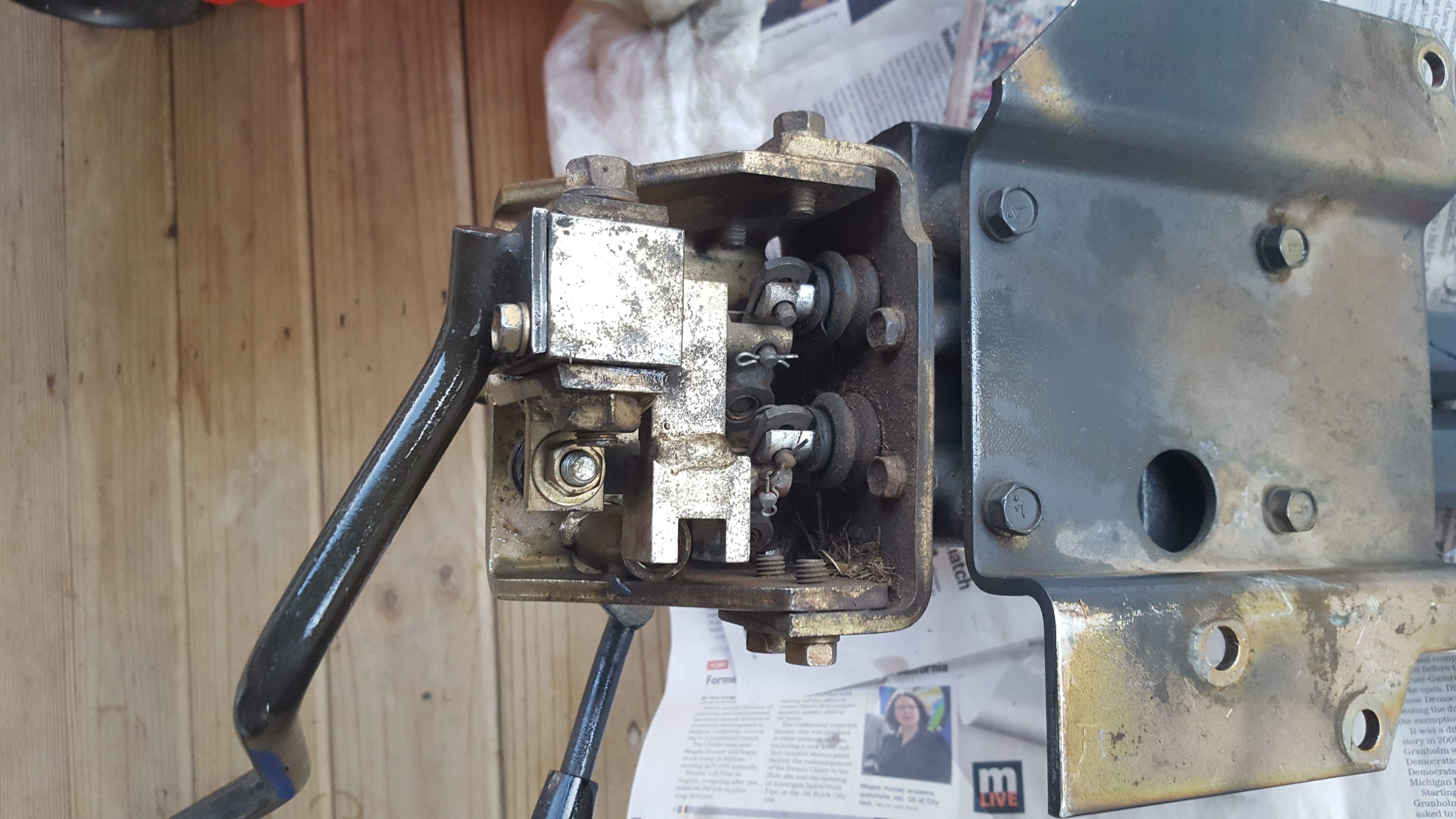

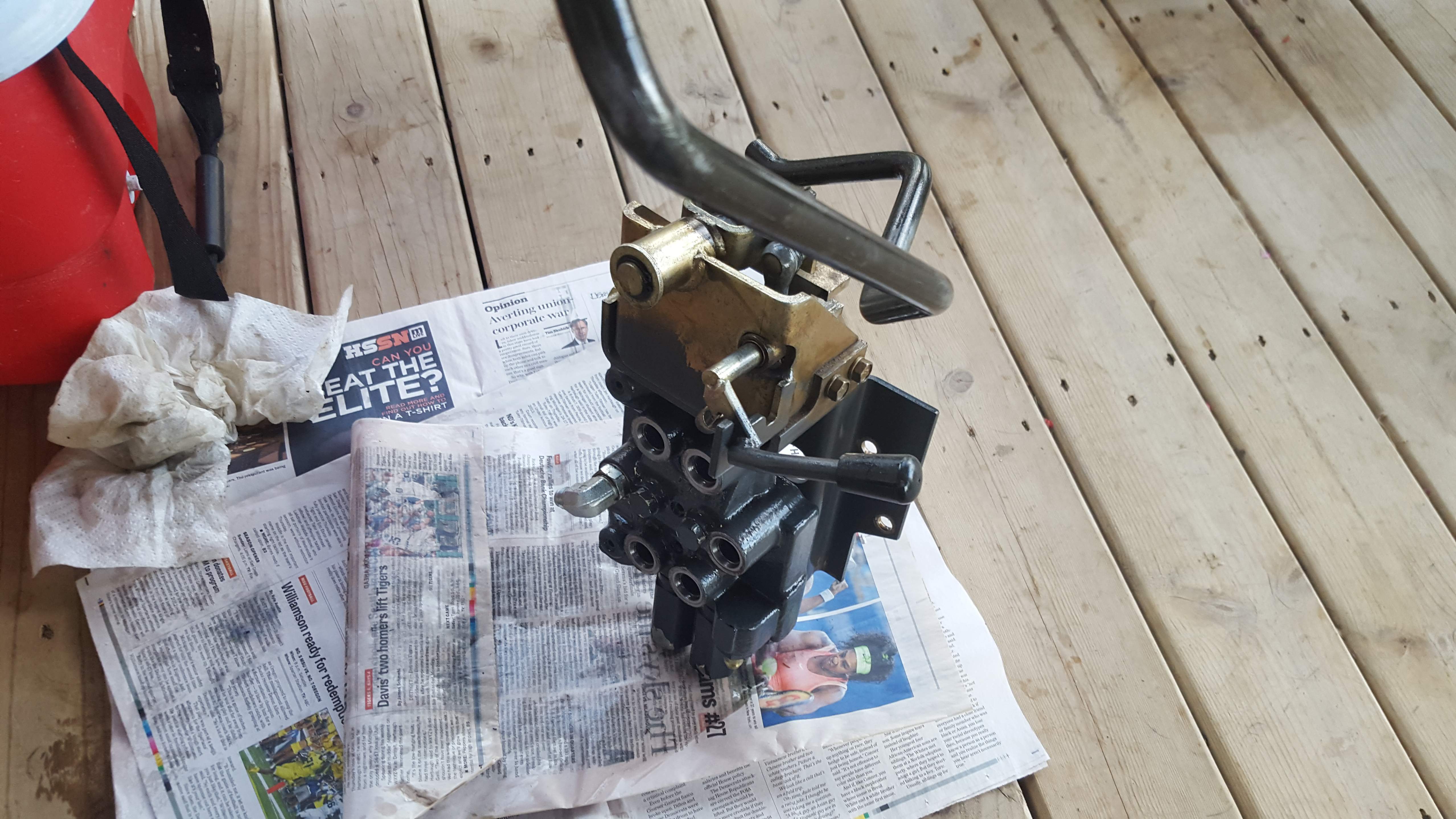

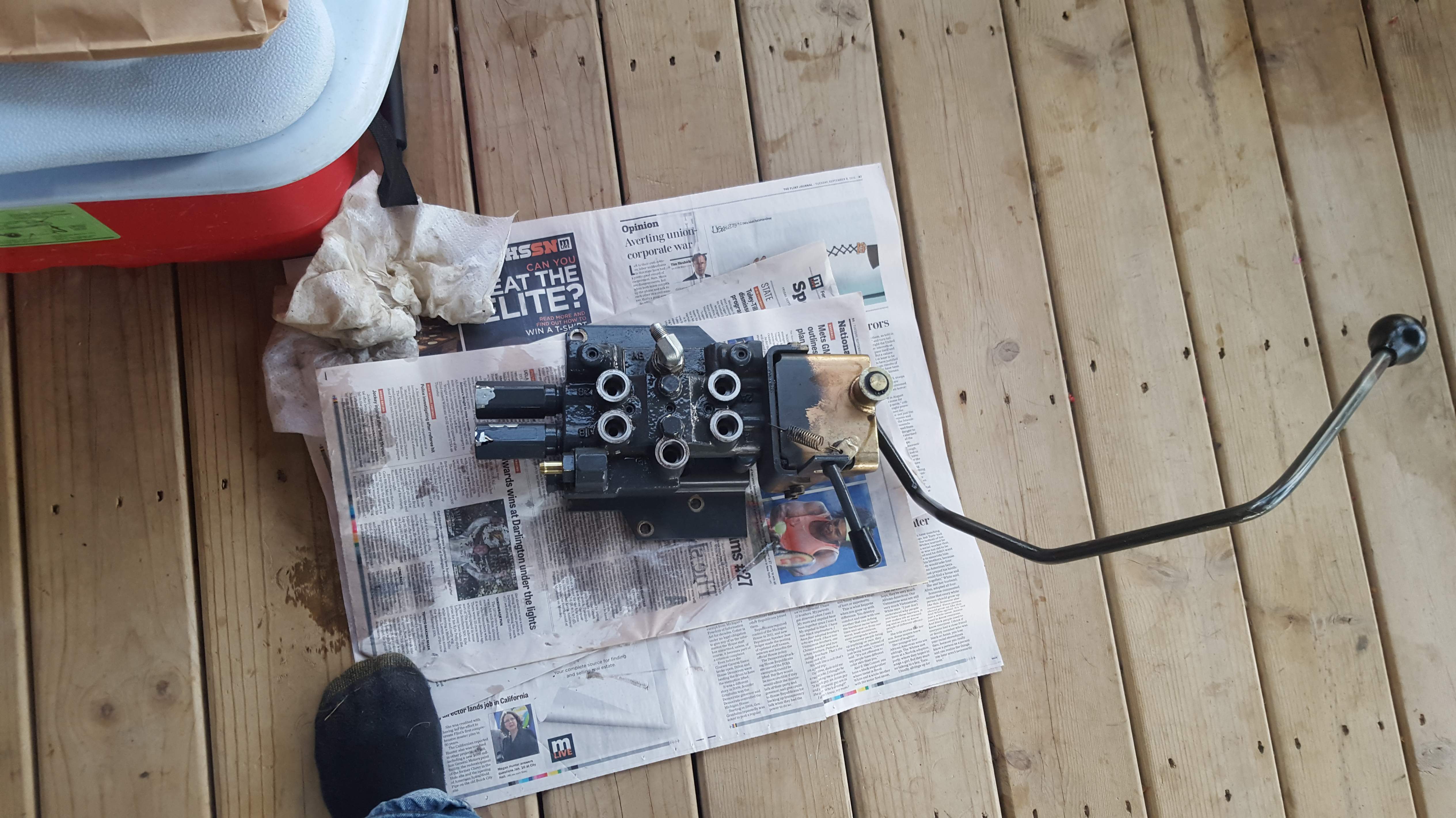

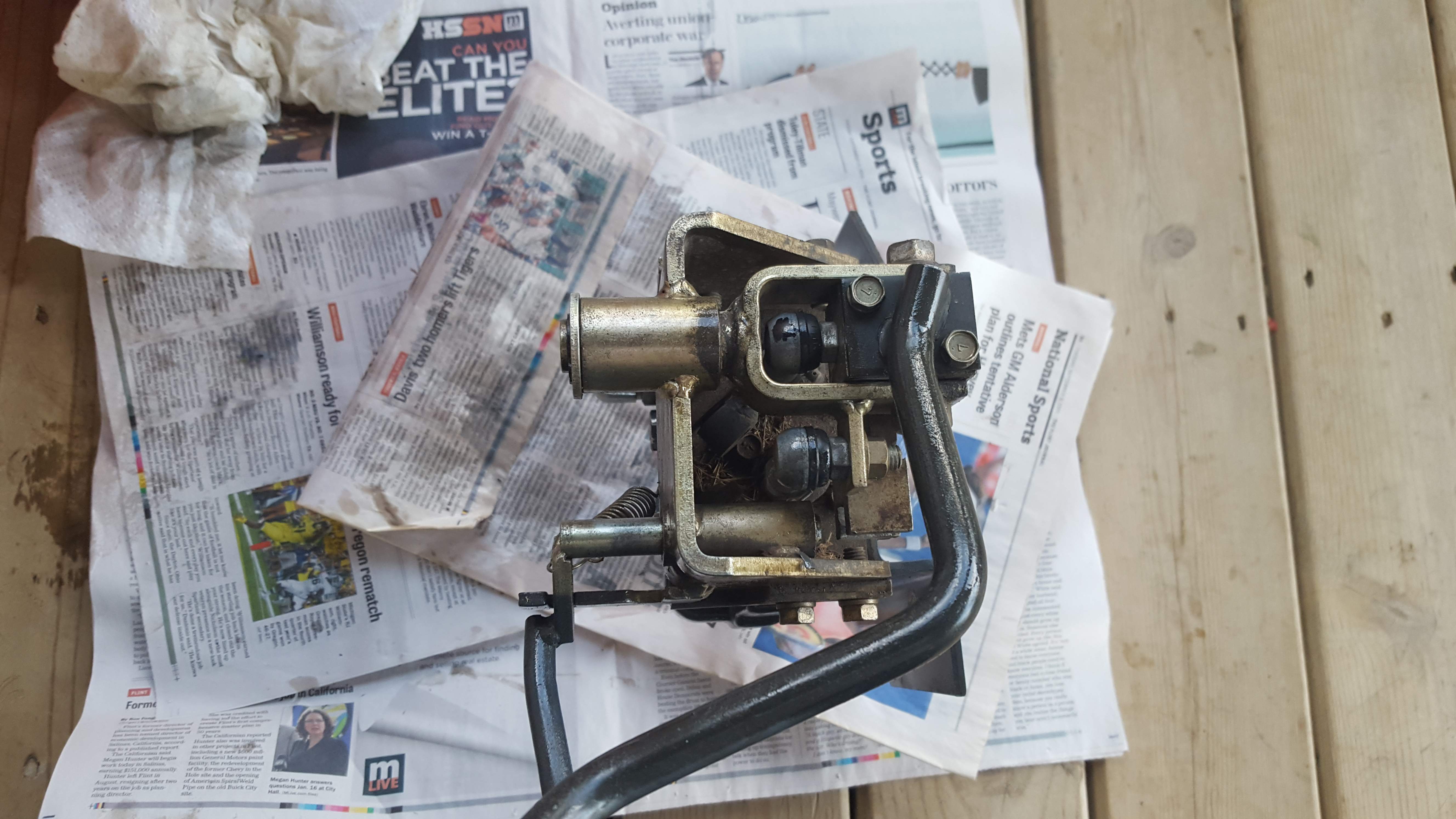

I received the used valve today. It was shipped by Marshall Machinery but I bought it from All States AG Parts. The box had a LOT of dirt in it. The valve body had dirt all over it. It looked like they dug it up out of a swamp. Someone attempted to put plastic caps in the ports but the caps were too large so they were bent in and didn't seal well. I hope the inside isn't too dirty.
In addition, the ports are not exactly in the same position but appear to be close. This was my whole reason buy and genuine Kubota part so that I wouldn't have to redo the hard line banjo fittings. I'm not real happy right now. But I may try and attach it tomorrow.
What would be a good way to attempt to flush the interior out?

/ Loader Valve / Curl function diagnosis #46
No way I would put that thing on my hydraulics to try to save 20% vs the cost of a new exact fitting valve.
I vote send it back.
