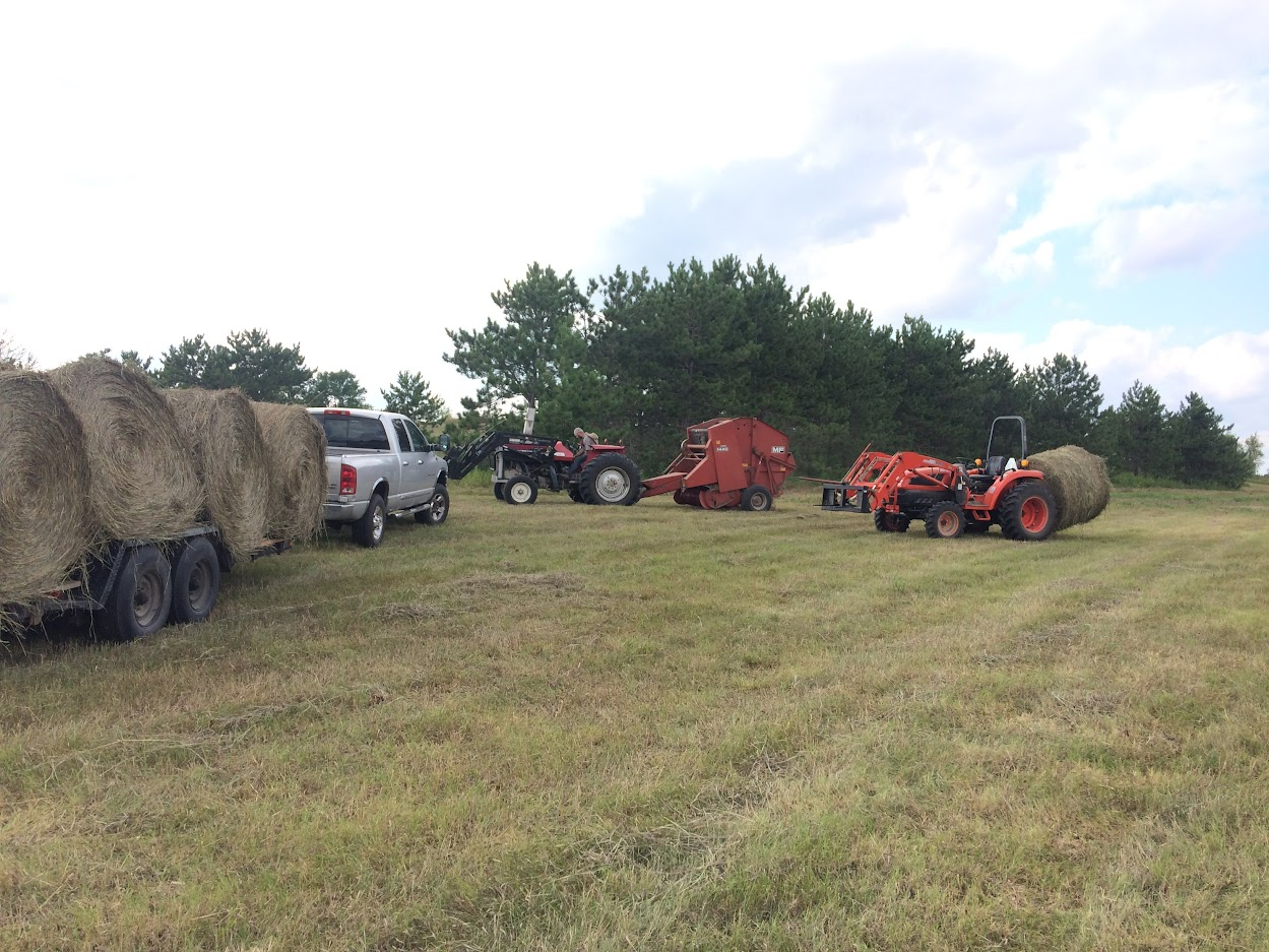

Just get a trailer with strong fenders, or make them strong... I stack 3 more on top in the middle of the 8 on bottom. These are 4 by 5 hardcore bales but not super tight like a some balers make. We've never tried 14 bales, I don't think the trailer is rated that high and there's some pretty decent sidehill to get out of the field... 11 never budges.

I don't see anything wrong with that.

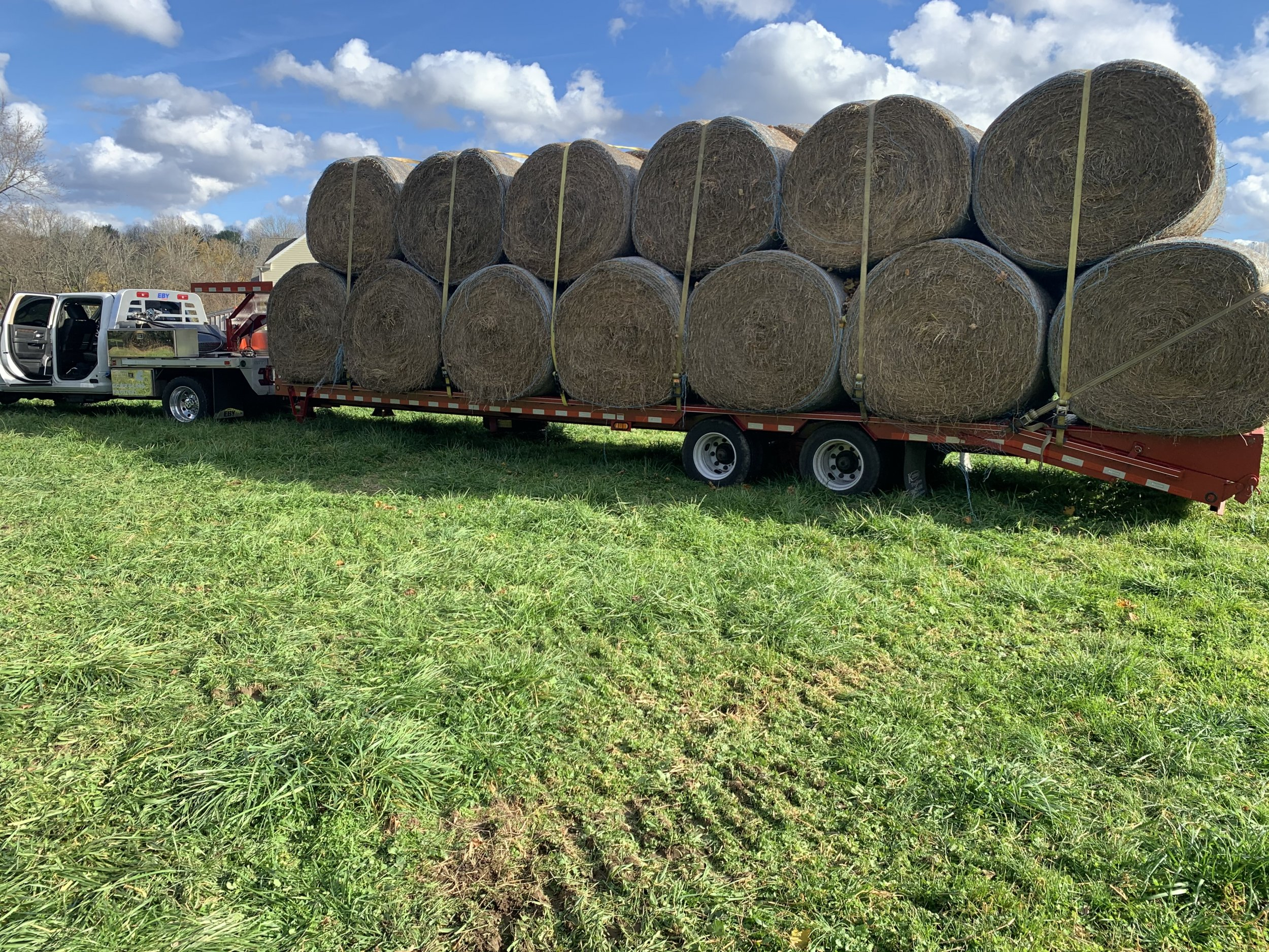

Try running doubles across the top instead of singles to improve efficiency.

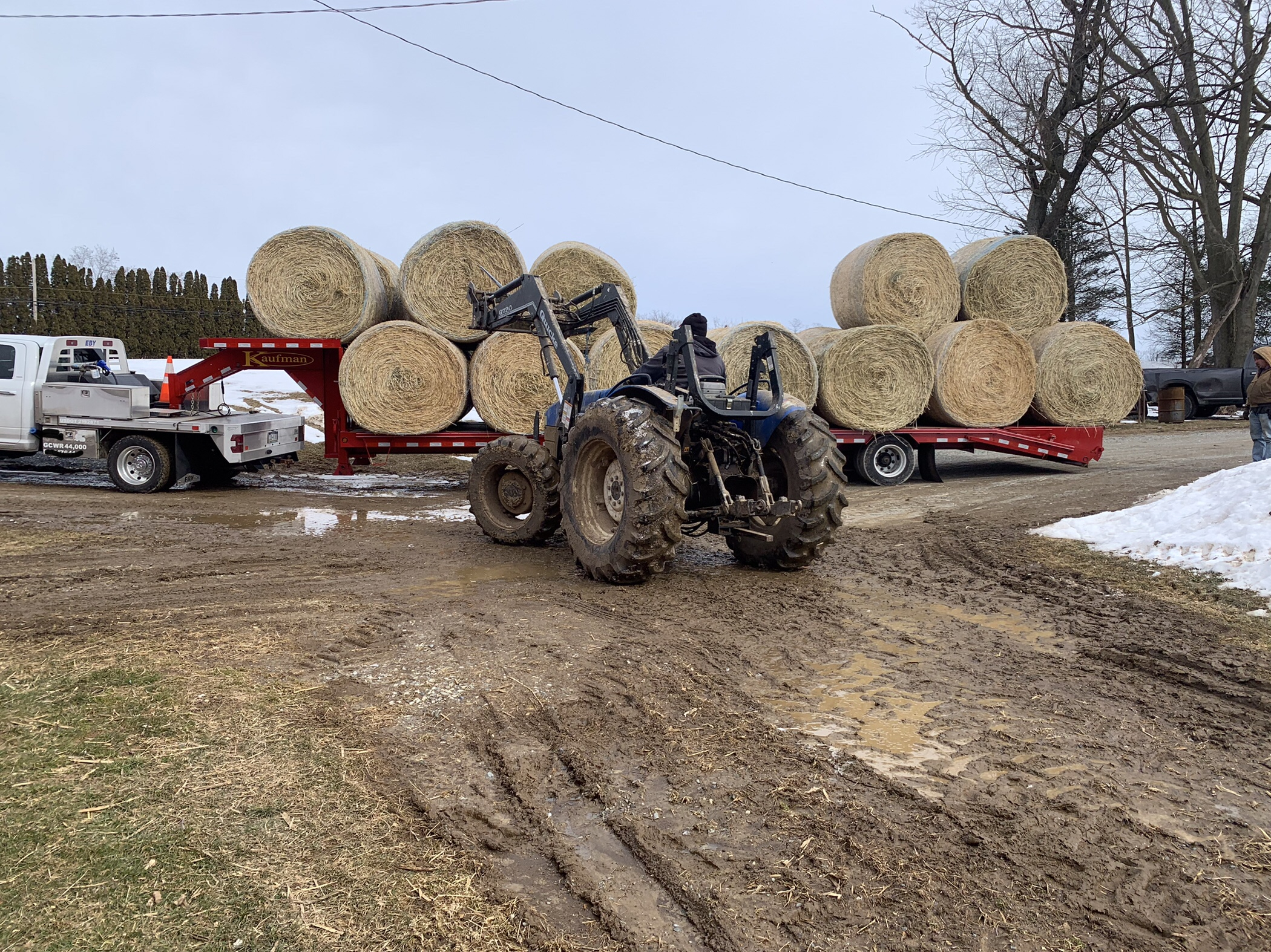

Loading round bales is a skill in of itself. Takes a little time to get the hang of double stacking, but there’s things you can do to make it safe.
One is to lay some strips of 2” lumber along the outside edges of trailer deck to “lean” or “tip” the bales inward slightly. Then the upper layers won’t fall out ward in transit. I just learned over the years that RBs almost always have one side is wider than the other and stack the wide sides out on the bottom layer to achieve the proper “tilt” for the top layer.
Once you strap them down snug, you can use tractor to adjust them again.
When you unload, they won’t tumble off as long as you have just a little inward tilt. These bales were shipped to JC’s Cattle. Below-You can see him unloading one at a time with none of them tumbling off. I drove this load of 28 double stacked up top 40 miles with no issues.

I would love to borrow that trailer two days a year.
