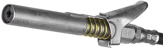

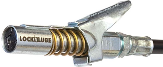

I'm thinking of getting a LockNLube grease gun coupler to grease my RX7320 and other machines. LockNLube offers a standard size and an XL size for recessed Zerks.
Standard Size, $29.95 - https://www.amazon.com/LockNLube-fi...rds=locknlube&qid=1567419838&s=gateway&sr=8-4
XL Size, $39.95 - https://www.amazon.com/LockNLube-Gr...rds=locknlube&qid=1567419838&s=gateway&sr=8-9
Do I need the XL size for any of the Zerks on my RX7320?
Any issues with the LockNLube?
Any better competitors of LockNLube grease couplers?

I have the standard size for my Kubota. It has worked everywhere that I have tried to lube with the exception of the U-joints on the PTO shaft for the rotary mower. I had to buy the angle head to get into those spots.
   / LockNLube for Kioti RX7320 - Which One? #3
I have the standard one. Has worked well for tractor and vehicles. The only time I use anything different is when I put a grease needle on.
   / LockNLube for Kioti RX7320 - Which One? #4
Although mine is not a Kioti (Kubota GL6060) I have the standard LnL. It will do all the fittings except 1 on the lower swing of the back hoe. It is too long so the longer one would only be worse. I have 2 grease guns so I just use the standard coupler on that fitting. I like that I don't have to fight to get the coupler off the fitting with the LnL. If you don't have any really recessed fittings the standard coupler will probably work for you. Hopefully someone with the same tractor will chime in with their experience.
   / LockNLube for Kioti RX7320 - Which One? #5
Standard one is what I use. Works great! Wish it weren't so expensive though...
   / LockNLube for Kioti RX7320 - Which One? #6
Been using mine for a while now, it's not working all that well anymore, I would have thought it would have lasted longer without a rebuild..
