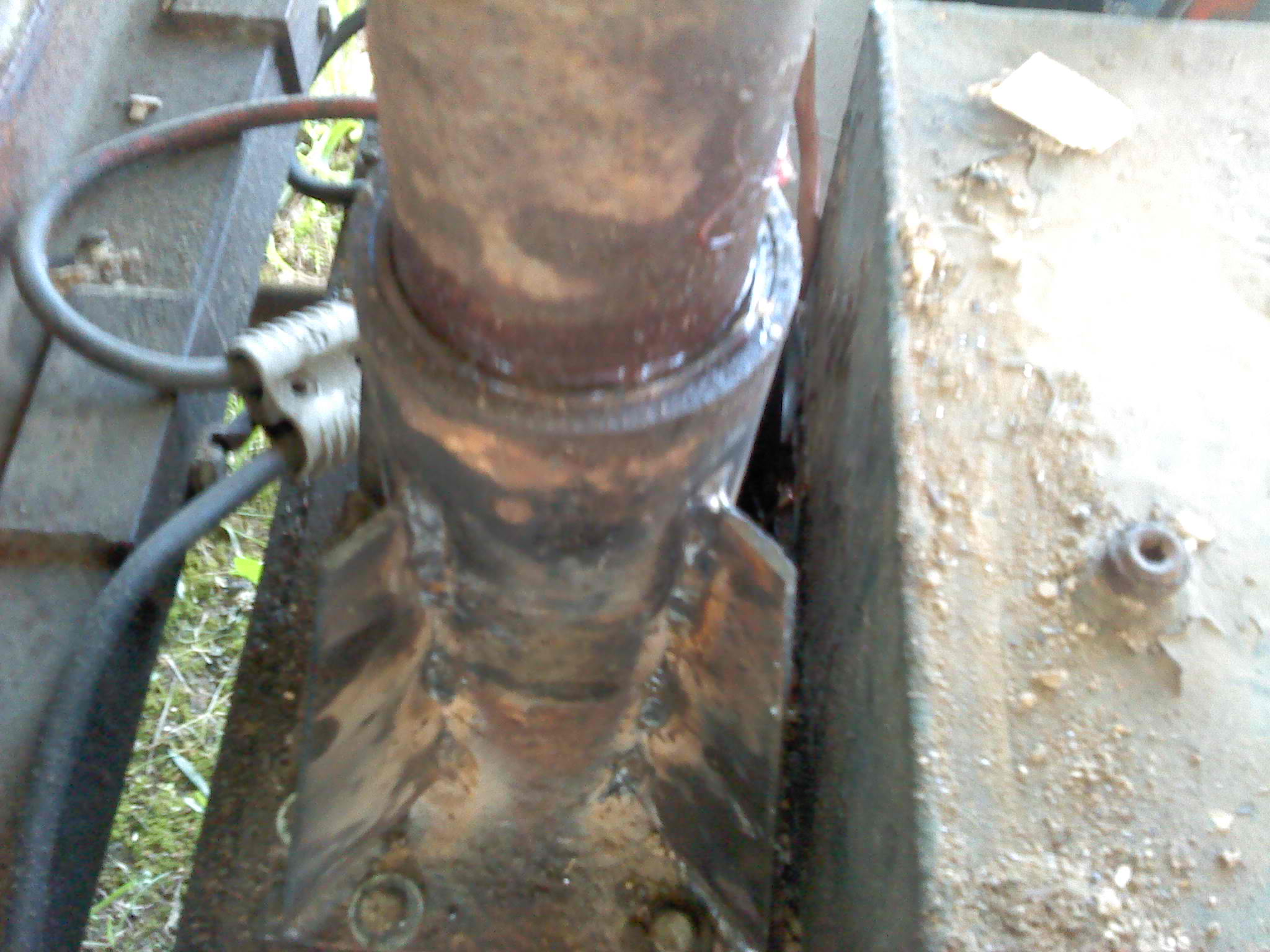

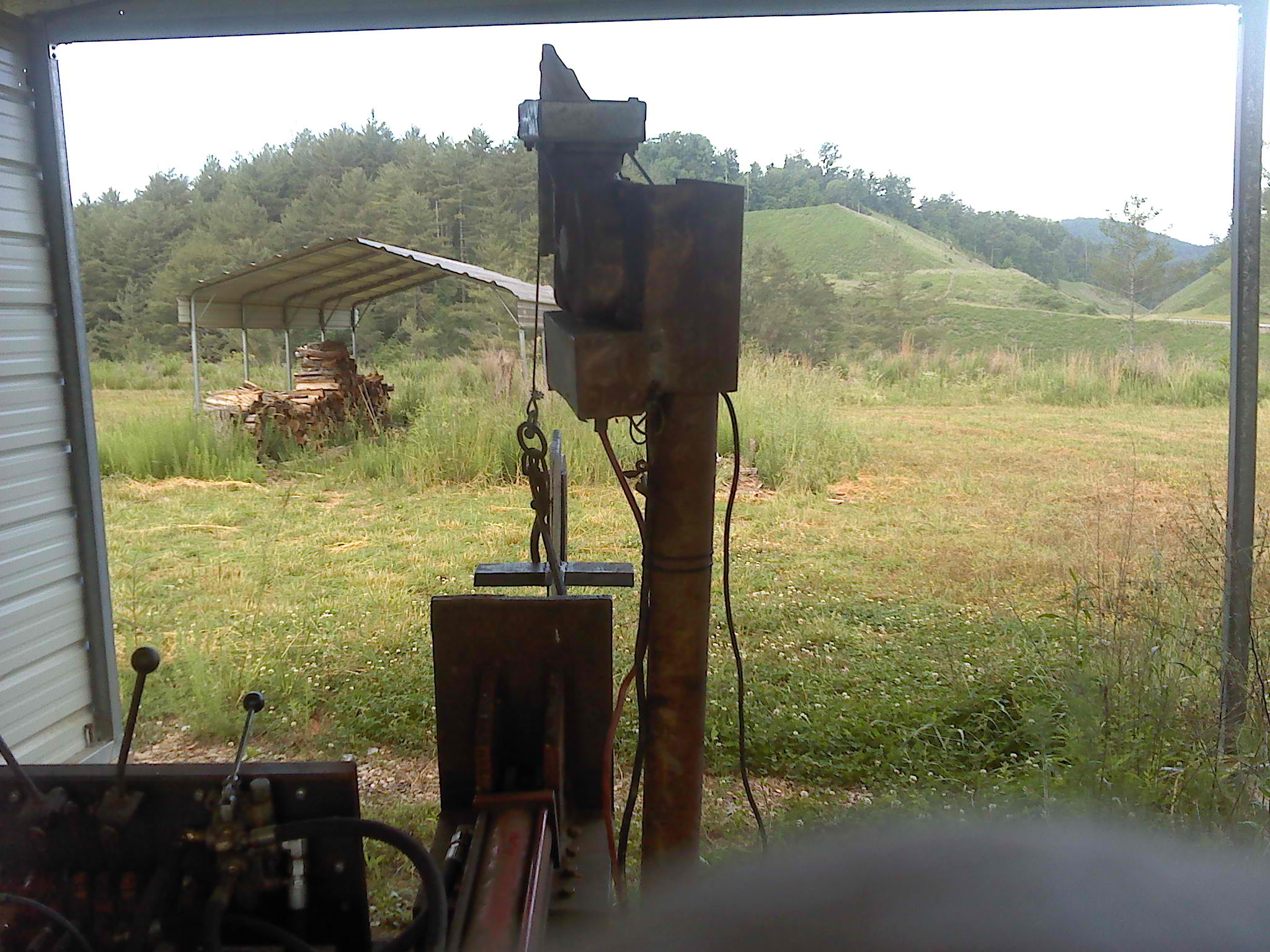

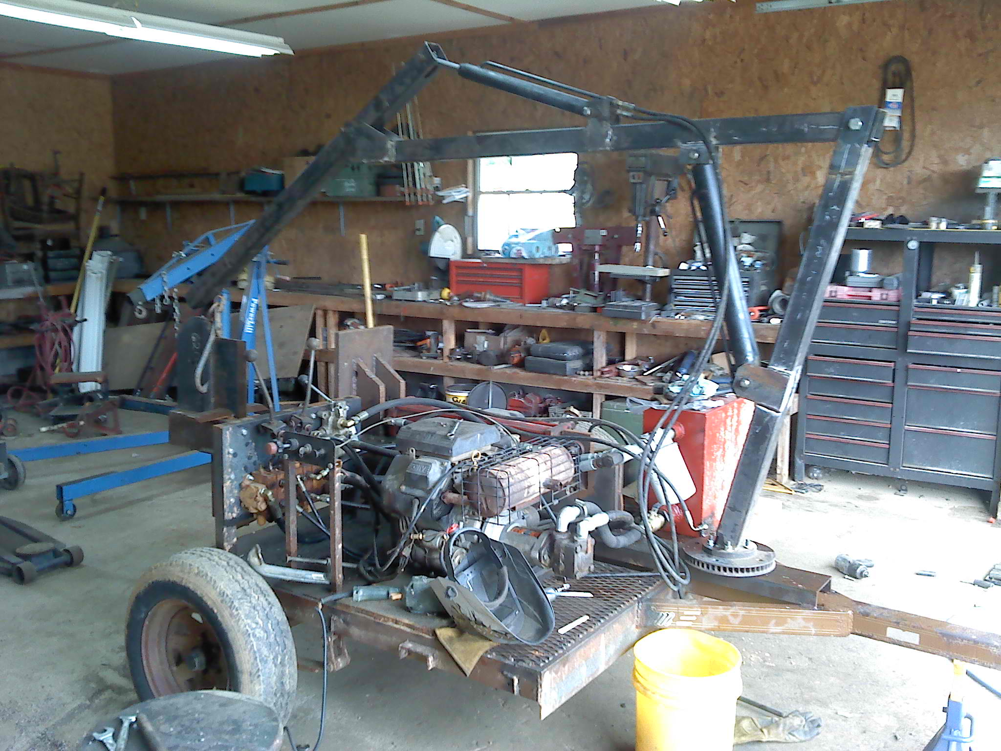

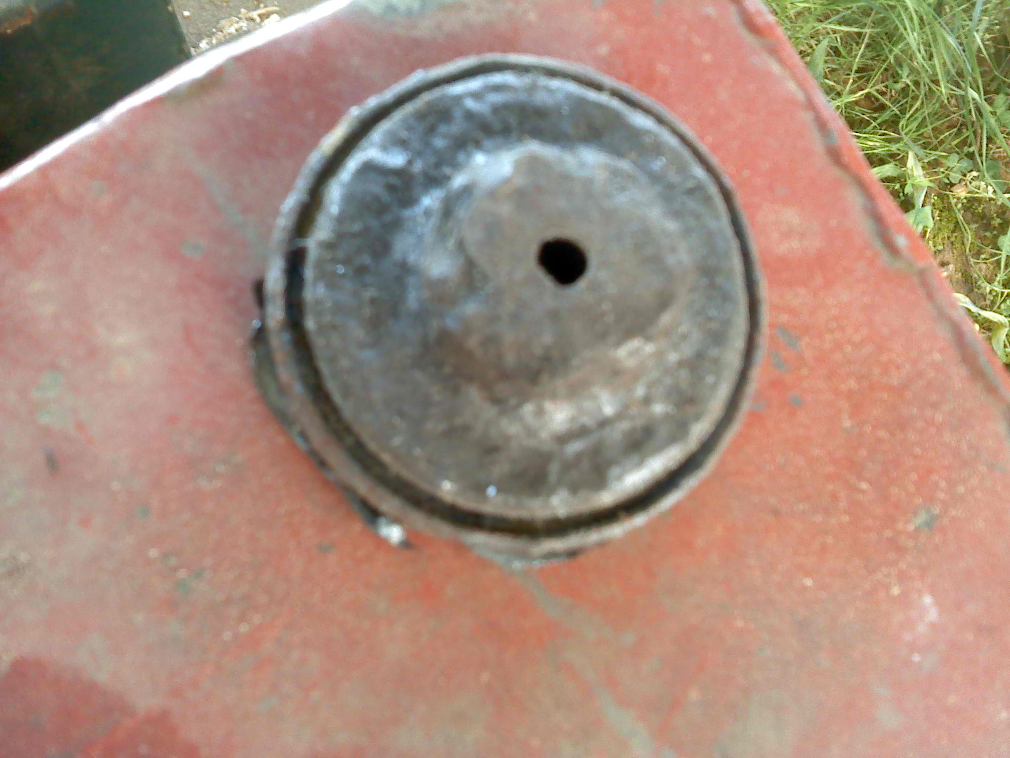

I built a knuckel boom on my splitter for load large rounds to split. I used the jeep front axle hub where it bolts to the strut. My boom was 14ft long fully extended with just a set of log tongs for picking up the rounds. Worked really well until I decided to lift a 14ft, 16in dia log up for easy sawing. The jeep bearings are actually 2 bearing in the hub. They are spaced to close together for any real support once you factor in the extended length of the boom. The leverage of my long boom just popped the bearing out of the hub, almost took out my splitter engine. For a boom/grapple I think your pipe ideal will work much better than the jeephub.
I found an old electric crane off a mechanics truck and replaced my knuckle boom with it. This crane is simply a pipe in a pipe. Not sure of pipe size, but sure it isnt 4in as in your plan. I think it is rated for 1500lb. The pipe that slides into the outside pipe does have a smaller solid shaft sticking out the bottom, that goes into a bushed plate on the bottom of the outside pipe. This supplies additional support for the upright pipe and reduces the load on the sides of the pipes. Makes it much easier to turn since it reduces friction of the two pipes as they turn inside each other. The upright outside pipe is just welded to a flat piece of plate with 4 gussets welded on for support. It uses a small electric winch on top of the boom to pull the wood up. I used a 4 pole trailer connector to wire up a 20ft long remote cable which allows me to reach firewood I otherwise would have to either carry to the splitter or move the spitter closer to the wood.
I attached a pic of the boom, the base, and the stub I replaced at the bottom of the inside pipe. I also added a pick of the Knuckle boom and the jeep hub mount that I removed from the splitter.

Muddstopper, that's exactly what I was going to use, I think your problem was you didn't leave the stub axle in place, it keeps the bearings from separating. I have decided to go a completely different route now though. I'm using a Jeep axle assembly with one tube cut off. I will be able to drive the yoke with a hyd. motor for turning and it should be much stronger. I'll post some pics once I get it under way. I've been shearing and punching steel this morning at a friends shop. He is going to cut a piece of 6" well casing for me. It sure was nice punching some 1" holes in some 3/8" plate! He also has an Ironworker which I used to cut the 3/8" x 6" to the lengths I needed.

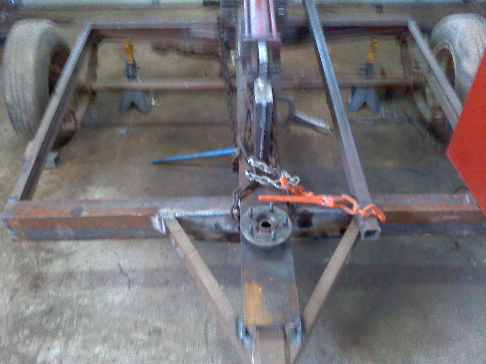

I had the bright idea to build this thing after using the truck to pull some logs off a pile then having to bend over to cut them to firewood lengths. I have a dump trailer I built a couple of years back and I'm going to put this on the tongue. I will do away with the electric over hydraulic unit on the dump trailer and power the grapple and dump with a gas powered motor hooked to a hydraulic pump. I have most of what I need here, I have a bunch of 2"x2"X1/4" angle iron I picked up cheap at the scrapyard this summer, the main lift cylinder which was given to me, the pump came in a hydraulic tank I used for my log splitter, a piece of 6" well casing that was given to me, 3/8" x 6" flat stock was left over from a previous project, I bought the 2 1/2" square tube for the boom, I had the jeep axle and the bearings were in a drawer that I had bought for a project that never happened.
Anyway, the plan is to get a HF 6.5 hp motor for 99 bucks, a backhoe control valve either used or new. I will need to buy a crowd arm cylinder and sabilizer cylinders, an adapter for the pump to motor and hoses etc. etc.
Here are a few pics of what is completed so far, I will get some more pics of the bearing set up for the base of the turret.
Here's how most of my projects start, a doodle. I doodle when I have my morning coffee! LOL
Plan is to weld the spiders, put a large chain sprocket on the yoke and drive it with a hydraulic motor, I'm trying to figure out the gear ratio and how fast the turret will spin. Given a 6:1 chain drive and a 3.73:1 axle drive I'm guessing somewhere around 24:1, I hope this will be slow enough. (I could use some help here)
I'm searching for the drive motor.
I will keep you updated as this thing progresses.
thoughts on stabilizer legs, folding or sliding, I'm thinking folding will be less weight?
dave
