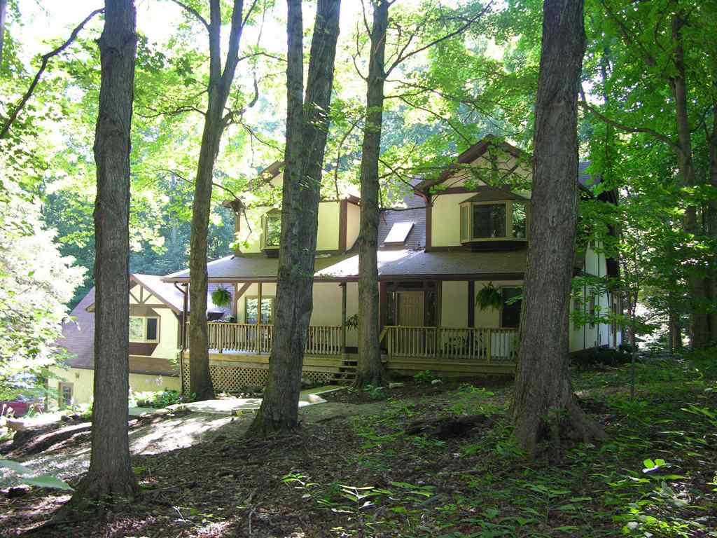

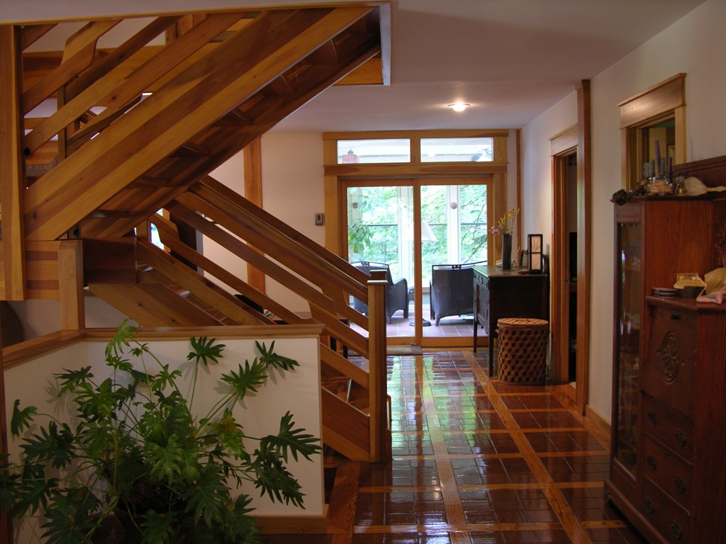

I have really enjoyed building our Timber frame home, but I'm glad to say we are selling it and close on Friday. We are building an all concrete home with massive amounts of insulation.
Patrick T
