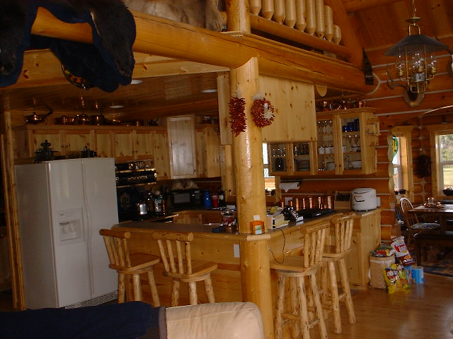

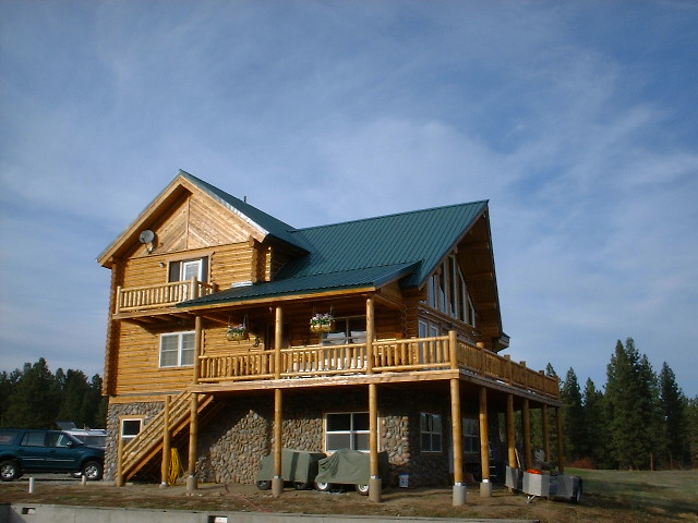

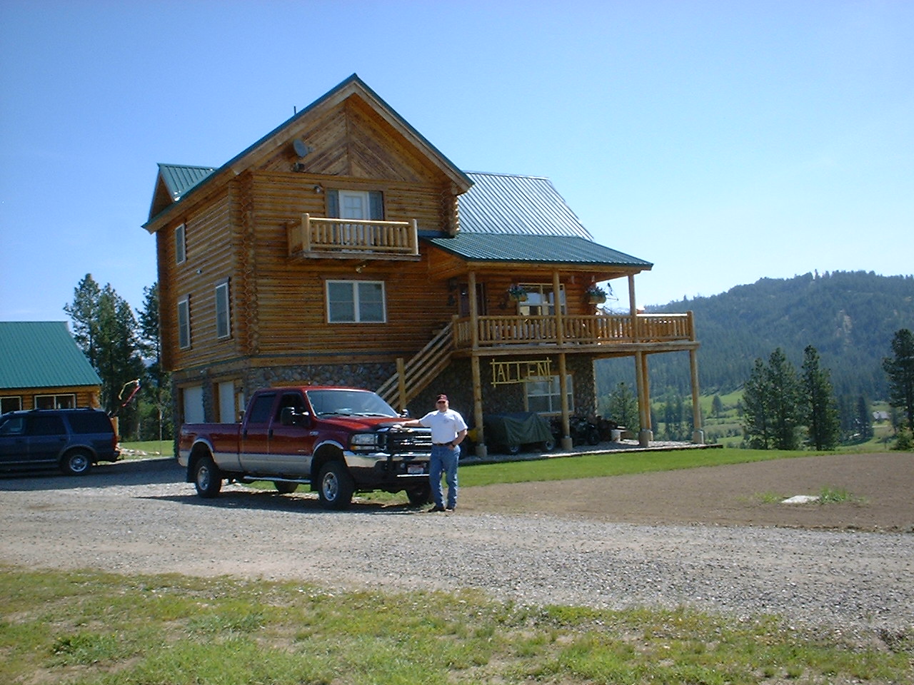

I not only have a log home, but I live in a "log home only" subdivision in SW Idaho. I am also a life long forester to boot. Now that doesn't make me an egocentric log expert, but I do know a few things about my log home and things I would change even after years of experience in logging and knowing about log homes.
First and foremost, I would build my next log home out of cedar or cypress logs...nothing else. Those 2 species would be bug free with very few exceptions. Next, only a metal roof with no gutters, no shake, vinyl, fiberglass or asphalt shingles, period. All deck materials would be the "tech" variety, not wood, but made from reconstituted milk cartons or whatever, to look like wood. All foundations would be solid concrete, no blocks, period, with plenty of air ducks for cross air waves under the foundation.
Speaking of foundations, all cross members made from redwood 2X6's. Yeah, I know, they are super expensive. So if you don't care then use whatever; gluelams would be the next best.
If possible, use "instant on" hot water system; and solar backup. If you are really on top, place an underground water system under the foundation and always have a 24 hour 55 degree water circulation system, sorta like a heat pump setup. I saw one of these in Oregon a few years ago and it was amazing.
Just my take, hope it helps someone.

Yeah, that's gonna be a great, low maintenance log cabin, unfortunately I'd have to hit the lottery to build that. I'm gonna have to maintain what I got I guess.
But looks like you have a big advantage over the rest of us by both being in forestry and living around a bunch of other's who have log cabins. Ya'll can share your maintenance tips with each other.
That's a beautiful home you have there, how old is it in those pics?

That's a beautiful home you have there, how old is it in those pics?[/QUOTE]
The actual picture was taken when it was 2 years old and now is 7 years old. Built for move-in in March 2001. Took about 11 months from beginning to end and built by an experienced log home builder. I wanted Engleman Spruce logs but at the time couldn't find any from a log supplier so we went with native standing dead Idaho white pine from Weippe, Idaho; New Pioneer Log Homes. Their logs were super and I have no issues with them at all. We used a product from Behr called Rawhide and it was horrible. We had to sue them to get our money back on the product as it pealed and mildewed terrible after only one year. We used Sickens (sp?) afterwards and it seems to work fine. That's the reason I would build with cedar or cypress if I ever did this again. The reason I wanted spruce to begin with was the R factor is greater with spruce than anything else. It is lighter and easier to work with but like all other pine/spruce wood, is prone to bugs and weather. I will say this about logs homes. I have seen old log structures that are over 100 years old out in the woods without ever having any type of sealant or paint that look weathered, but just fine. It may be that all the hoopla over varnish and stain on logs is just that, BS. I really believe that a good chink is as important as the finish. Some log home are grooved so that the manufacturer claims one doesn't really need any chink. I believe that no matter how kiln dried or air dried a log is, it will swell and shrink so that the cracks will eventually get a space to allow cold/hot air or bugs and I would chink both inside and out. That's what I did. Anyway, there's nothing like the comfort and homey feeling one gets from living in a log home, even with the added effort.
