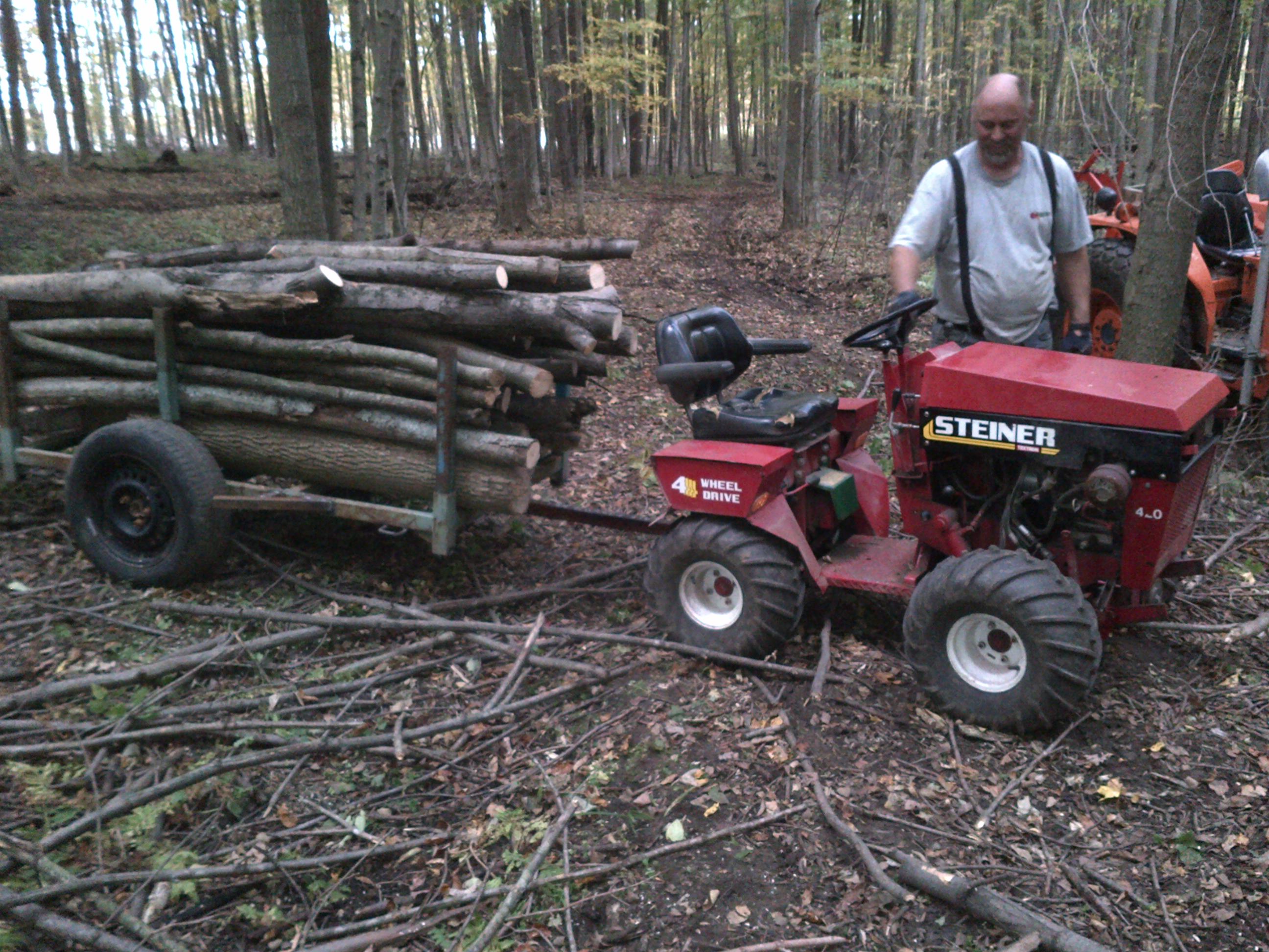

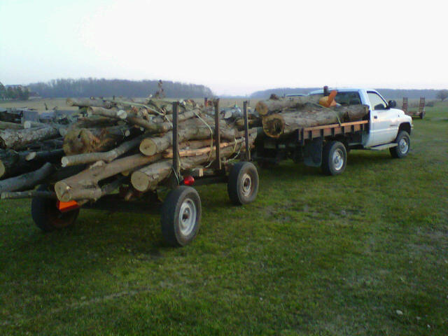

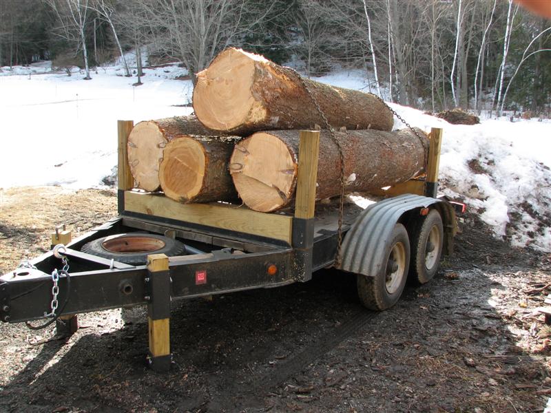

This is an old camper trailer frame. Hauls lots of wood, has 1 braking axle. I haul with a 3/4 ton dodge.
Small trailer behind Steiner for limbwood and deadfalls.

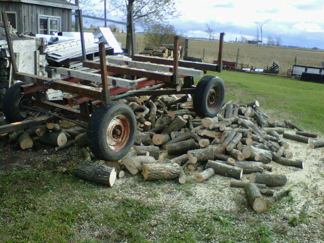

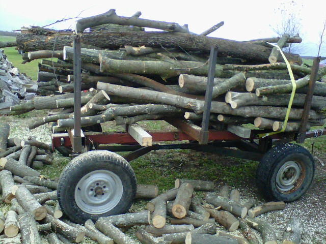

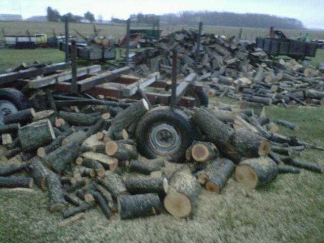

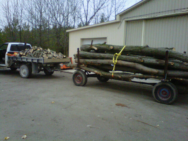

Small wagon running gear that I cut into rounds right on the wagon, Works great and saves lots of handling.
Another wagon running gear with a longer reach for long stuff. We haul from a mile to 15 miles away. I also have a couple of dump trailers.

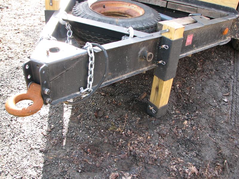

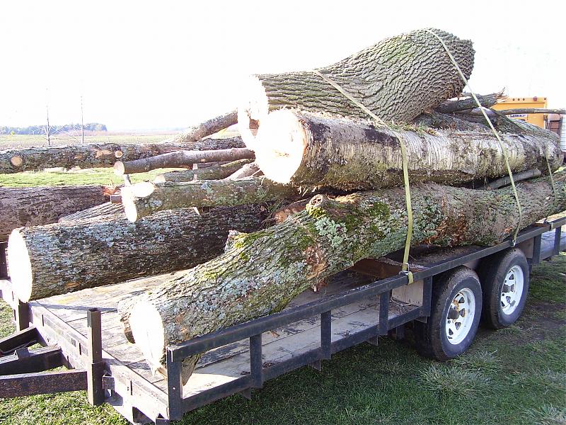

More pictures of the smaller wagon running gear and cutting on the wagon. The side posts are 2 1/2" steel tubing sitting in 3" steel tubing so they are removable.
Last picture is my bil's big dump trailer, it'll haul whatever we can load into it. Has pto driven dump.
