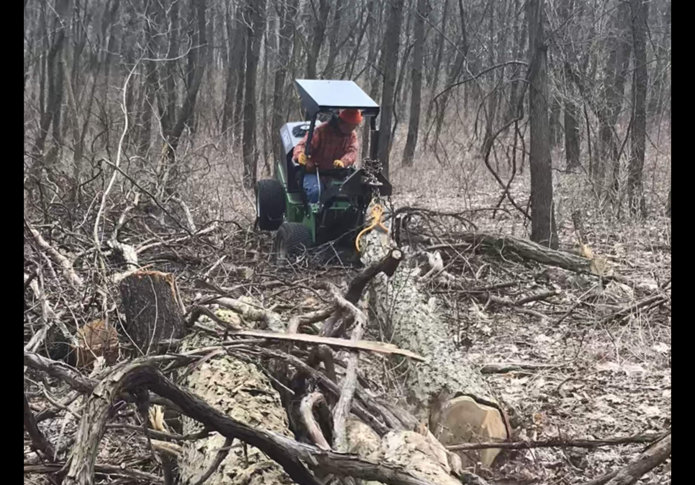

What is the plan to load multiple logs? Get a couple of chains or straps under the bundle, and trying to lift the whole bundle together?

Yessir! Whole bundle together! The size of the arch will easily accept 3 or even 4 20" logs.

I'm using an 8-ton running gear for my off road log hauling. I prefer 4 wheels and a steering axel. I can load and haul with the same tractor easier.
