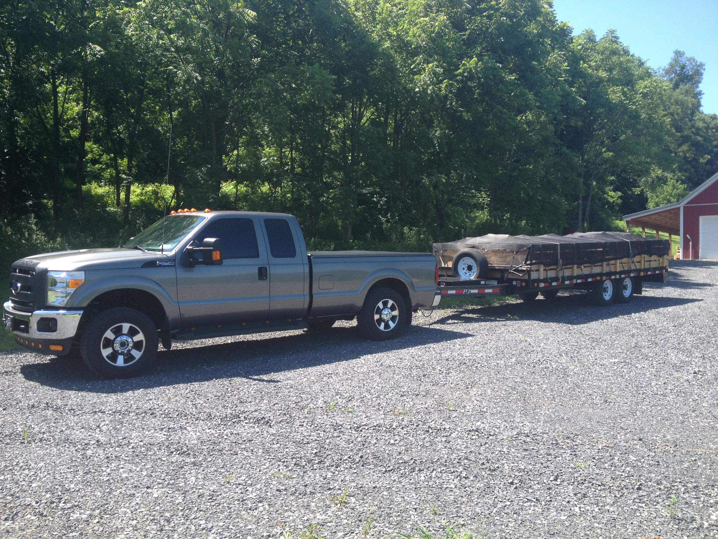

I haul plenty of logs in a dump truck. I don't strap them down. I don't load above the side boards. I have hauled logs on a gooseneck trailer, and those get chained on. I have never secured firewood either. How exactly do you go about doing that?
Here's what I do. Better than nothing I guess...
