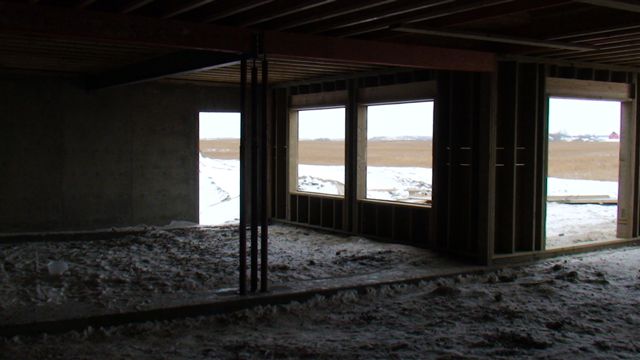

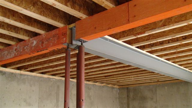

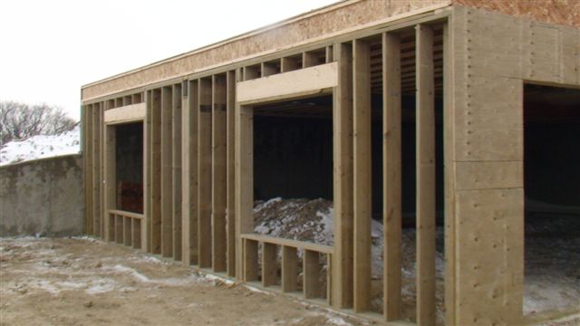

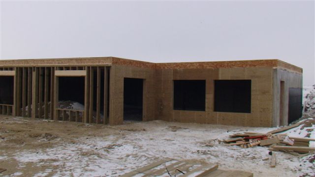

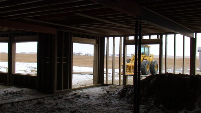

Well its going slow now, we demolished the first basement and re poured a second, way better and now we have the rear walkout wall built, floor above and the floor nailed good but then came the snow, we need good weather in the 0 to -10deg C, its been in the -20s last 3 weeks and lots of snow. These pictures were taken 3 weeks ago, today the snow has drifted in some 6 feet deep at the back

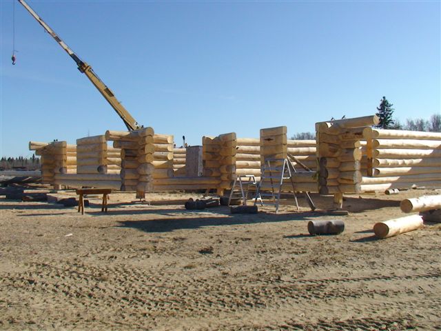

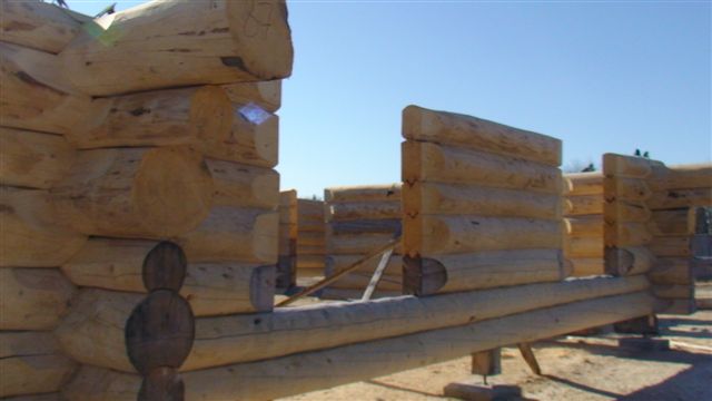

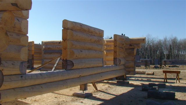

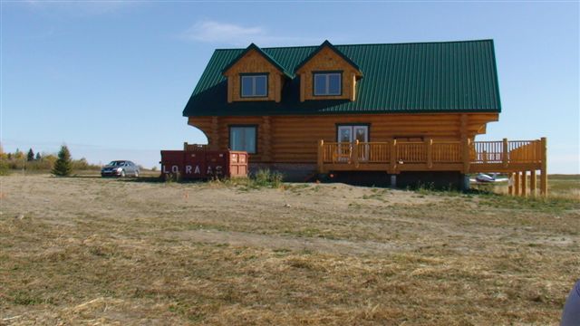

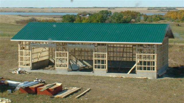

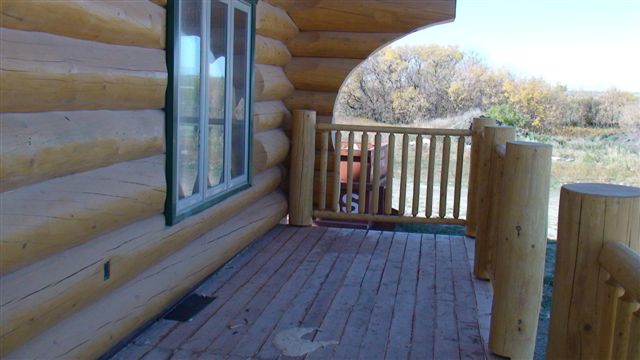

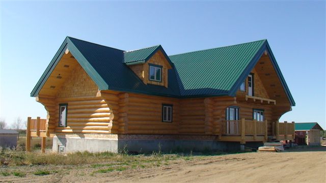

Here are some pictures of the log construction, it is being built about 175 miles north of us, then un assembled and like a large lego set assembled with seals and windows, thiugh with the snow here its looking like a project for early next year, we had a completion date of Nov 15th this year, we missed this, the basement was backfilled using a trackhoe and final to grade using the CK20, did not want heavy equipment packing the dirt around the basement walls due to pressure, nature will pack and settle the soil over time without point pressure on the walls
