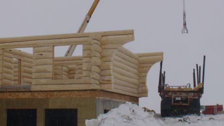

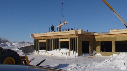

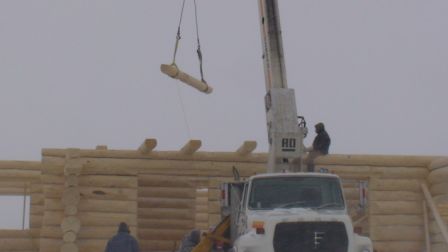

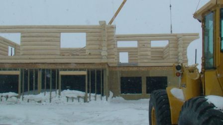

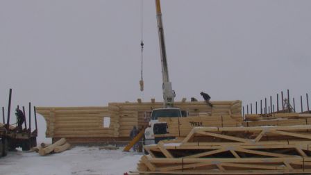

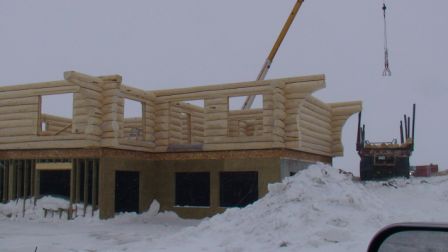

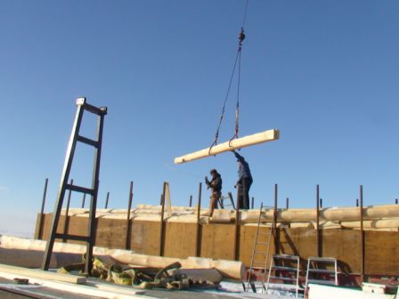

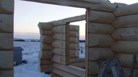

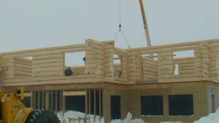

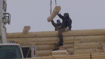

well its blowing snow and -20 deg C today and the last row of logs were set, saturday they set the second floor beams and the bulk of the log work is complete, its been a hard push with the project, sorry guys and gals my camera is a smaller SD card than the computer, will post pictures saturday night, by next week the roof trusses and all closed off, my CK20 is working overtime, the pictures will show the depth of snow, poor Deer 644 is out of action due to clod and no flow plugs.
   / log home and pond
#34

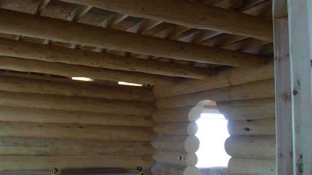

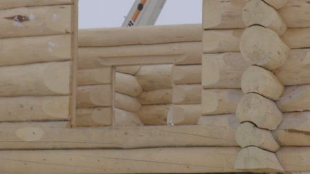

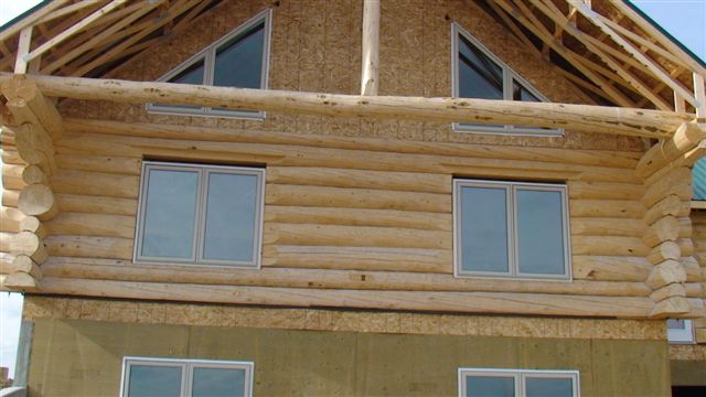

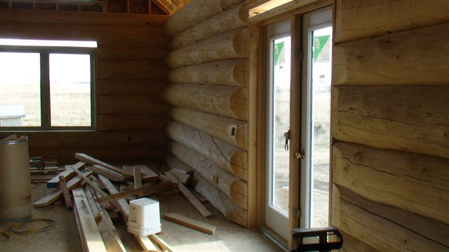

Well, here are a few pictures, the log work upto the second floor is complete, this week they will have the roof on and next windows, these guys braved -30 temperatures and strong wind, we had allmost whiteout conditions friday

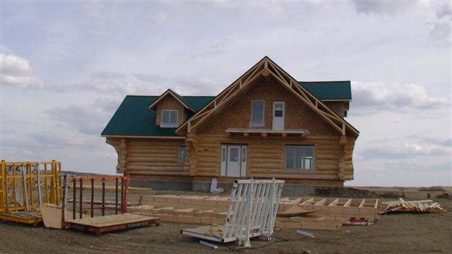

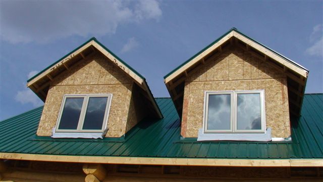

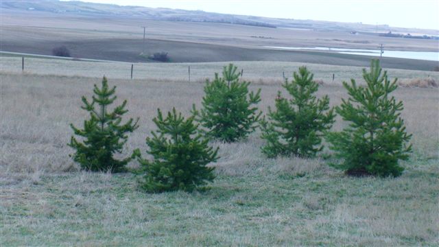

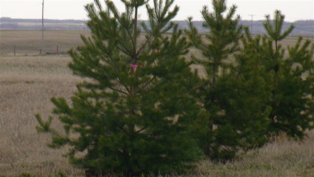

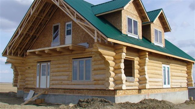

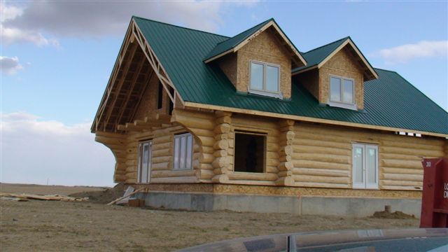

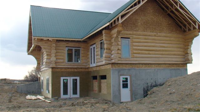

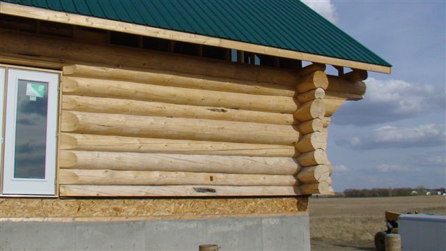

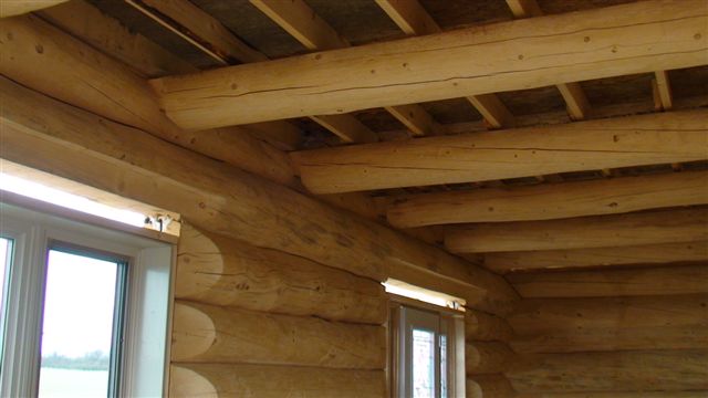

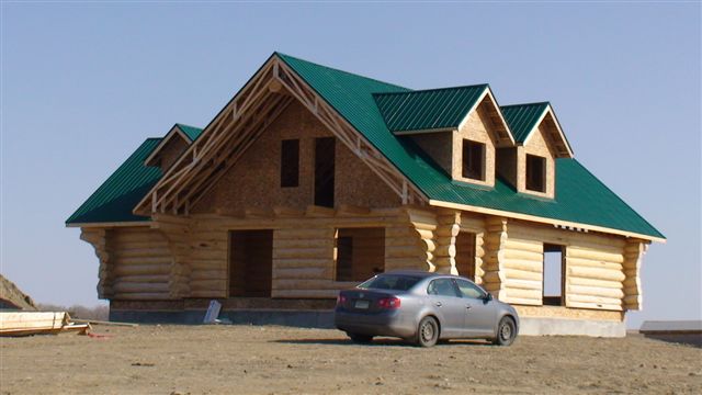

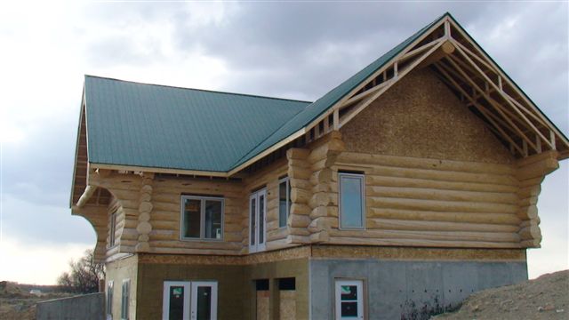

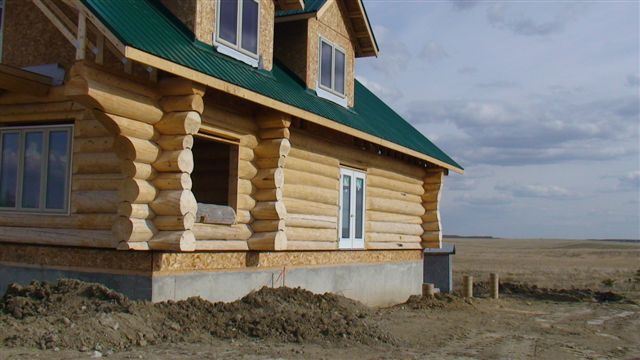

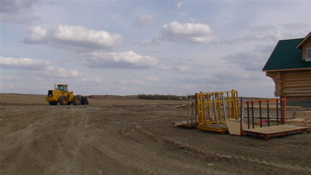

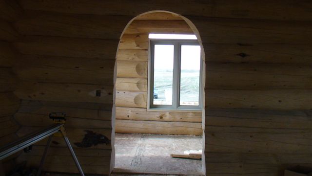

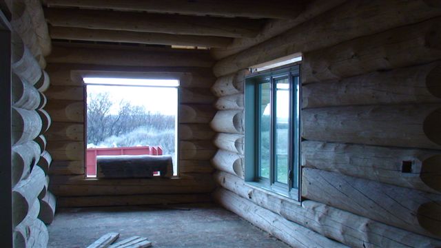

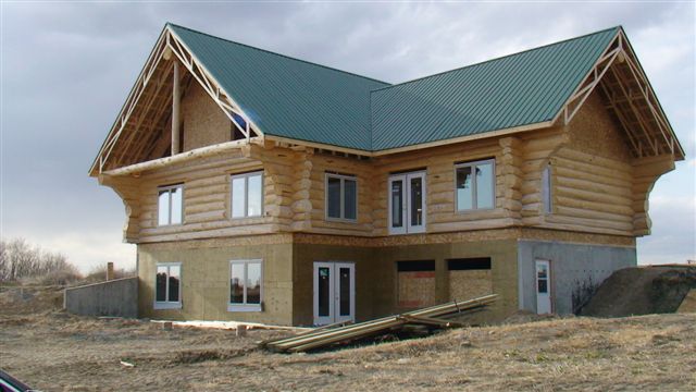

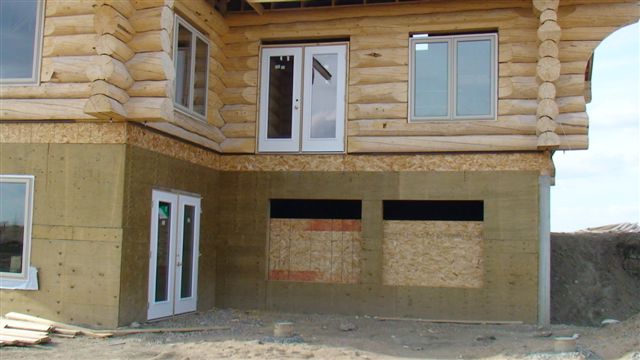

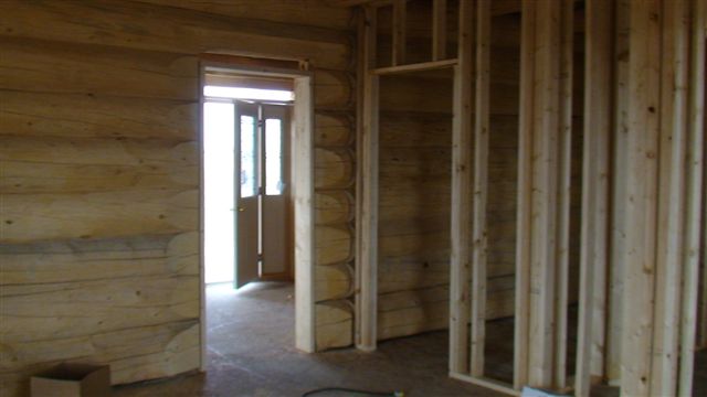

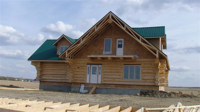

Well spring is here, work is progressing, the Kioti has been working with the backhoe planting several trees and trying to level the yard, here are a few shots as of last week, hoping to be in by year end
Laurence

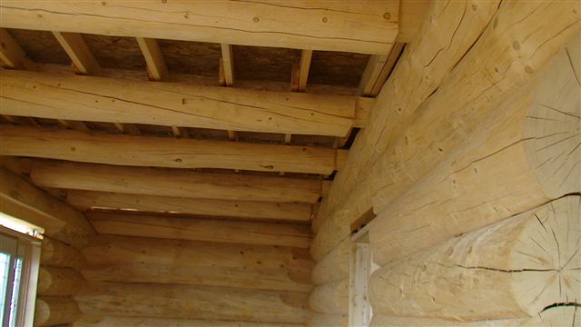

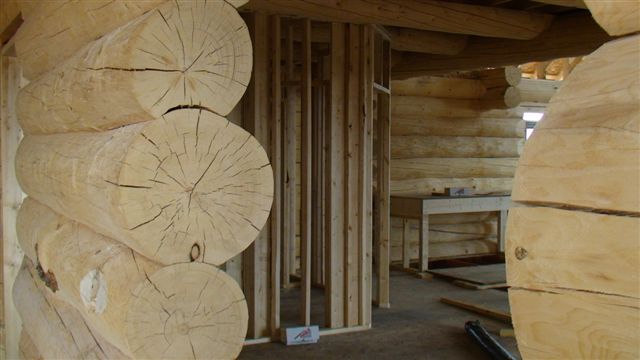

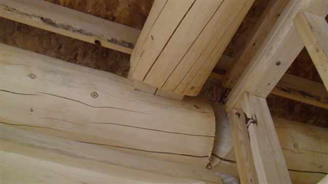

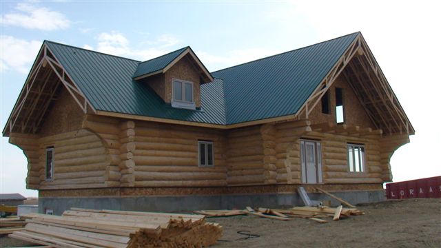

here are a few other shots

That's a lot of progress you made there. I see they're starting to finish the interior roof and such. It's very interesting to see the difference in log home construction between yours and mine, even in the style. Won't be long before you move in now. Mine should be done sometime in June this year.

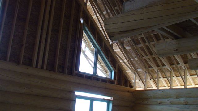

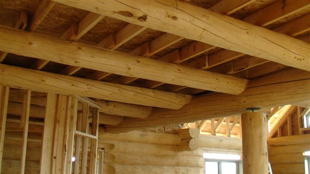

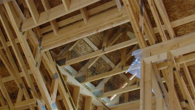

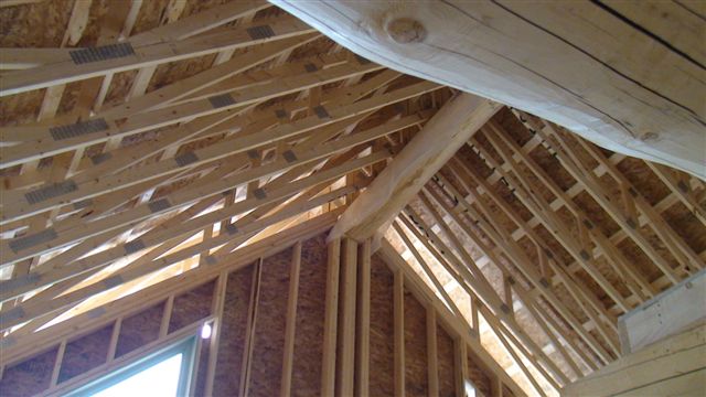

Niiiiiiiiiiiiiiice! That's an interesting blend of construction styles -- hand-crafted log walls (instead of machined) but with a more conventional roofing system made of engineered trusses. I find the roofing most interesting...
A lot of log homes here in the US have gone to structural, insulated panels (SIPS) over purlins or rafters, or what's called a "built-up" roof where they deck the entire roof with T&G planks, then use 2Xs to frame above that, add the insulation layer beteen the 2Xs, then deck it again with OSB (or plywood) and roof it on top. Looks like your insulation will be installed between the trusses, then the interor ceilings (drywall or something) will be installed below that... I've never seen that method detailed. Please provide more pics as they complete that part of the project!
