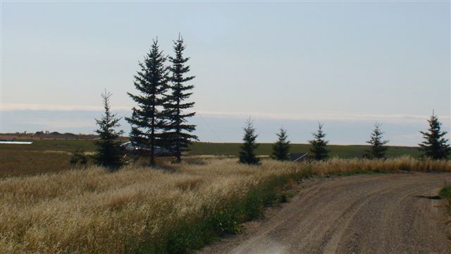

The driveway is under construction today, for the last year the crews have drove across the field straight to the house, we wanted a more North road 100 yards east of the house making a final right turn in front of the garage then house, this will prevent headlights shining into the house when we have visitors, I will take a few pictures of the work tomorrow befor the gravel is placed.

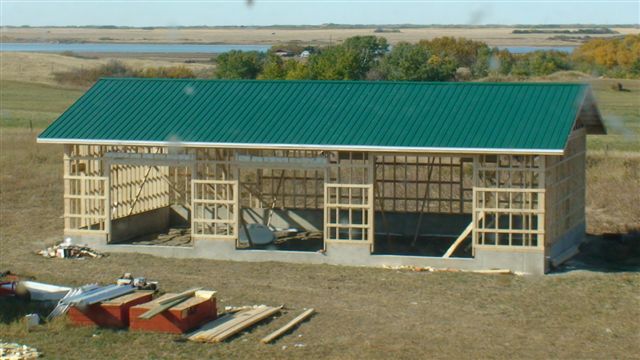

The garage is planned to begin next fall, like the house it will be set in the natural slope of the land, from the highway like the house appears farly small but with the full walkout its quite private, the garage will be 45 feet wide 30 feet in depth, we will be putting a pool underneath, the small door on the side of basement will connect to a glass fronted walkway to the pool area with stairs to the garage, the garage will be log construction sitting 25 feet away and scewed 15 degrees away from the house.

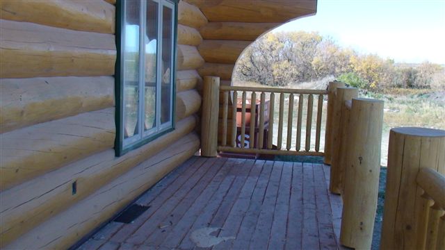

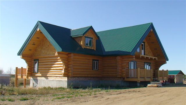

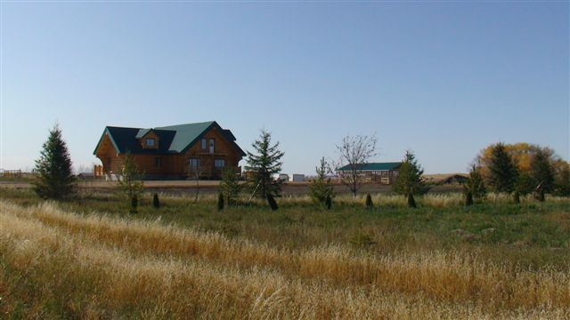

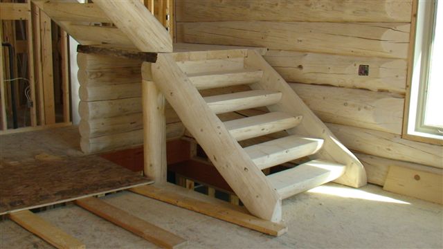

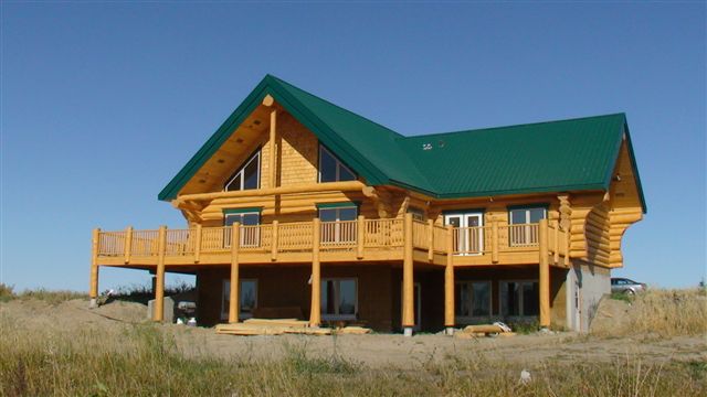

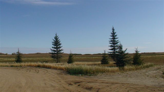

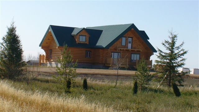

Hi all, well the house is close to completion, we are at the interior finishing stages, the CK20 has done a fine job of the yard and driveway, we have planted lots of trees and hoping to be in by christmas, here are a few pictures last week

It's a beautiful home, is there a specific reason for the large roof overhangs?
   / log home and pond
#48
the large roof overhangs are to protect the logs from the elements, we can also use the decks when its raining, the overhangs are 8 foot.

Just curious . . . with those large overhangs, did you also orient the house to take advantage of passive solar?
