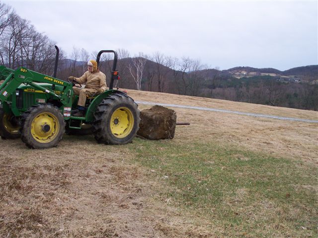

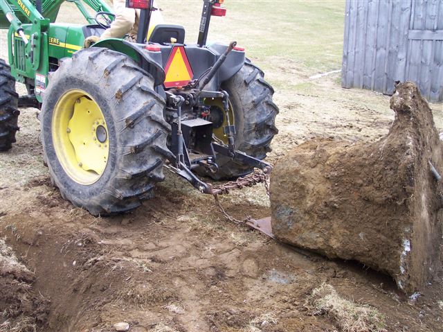

Good Mornin Foggy,
Her is a couple of pics of one that i used to move a 4x4 chunk of concrete about 3/4 of a mile. Its about 2 ft by 5 ft with two flame cut holes through it for the chain and about 1/4" thk. It works well for what we do with it !
BTW, I meant to add that you obviously would need to make some bends on the front of the plate, possibly some welded tabs to hook your chain to, to be able to hook up to your 3 pt hitch. I have also seen some log grapples advertised that may be of help also !
