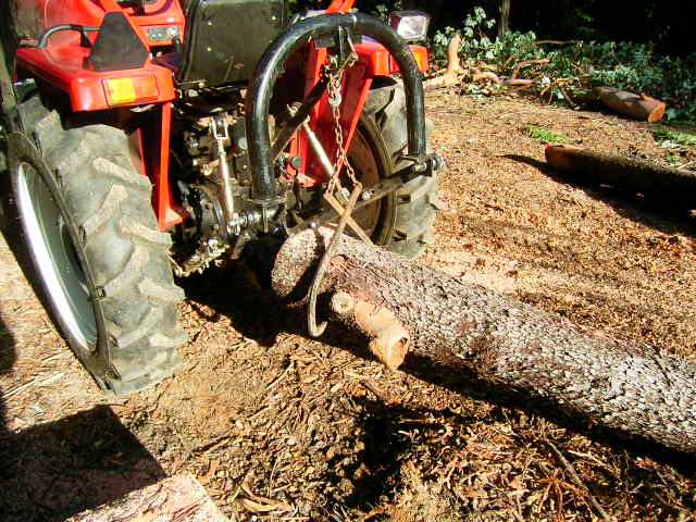

We used an old car hood, it worked reasonably well and it was free:)
   / Log skidder plate....? #14
And sometimes the bullet holes in the door or hood are in the right place so you don't even have to drill!!!
   / Log skidder plate....? #16
I use the "U" shaped yolk from my PHD with logging tongs attached to the top link connection. Lower the TPH, adjust the chain, place the tongs over the log & lift the TPH. Only the tail of the log skids on the dirt. Another option is to additionally connect a chain from the drawbar to a lower link in a choke chain. That way if the log snags the pull force will be below the axle.
