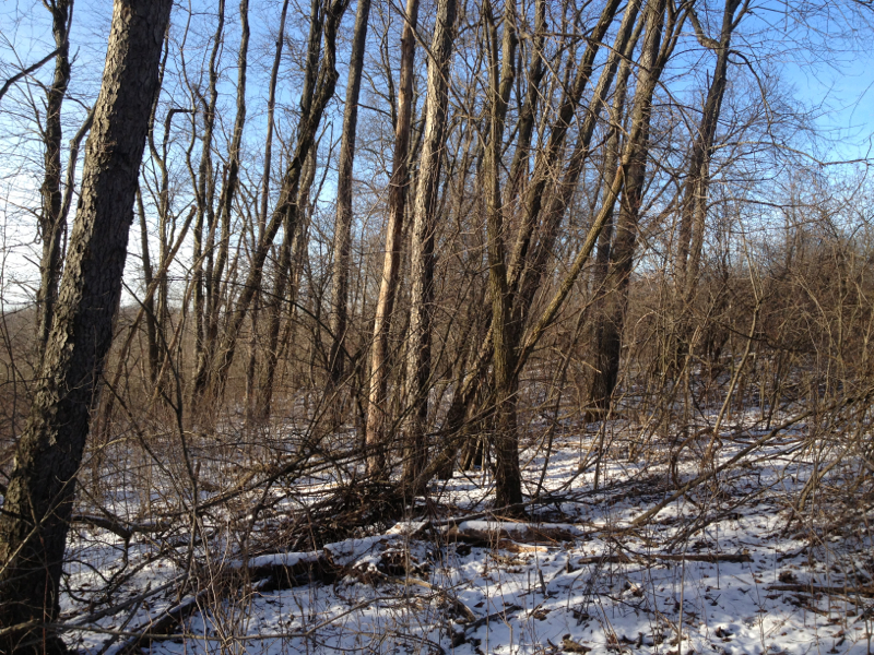

What size and length of chain do you guys use for log skidding?
In the next couple days, I'll be clearing a large area of trees. Tree size range from small to large oaks. I don't have a lot of experience doing this but thought I would head to Tractor Supple and get a couple different lengths / gauges. I was also thinking about picking up a set of tongs. And advice? Here are a couple pics of the job site. Thanks!

That tree in the first photo must be a "dogwood"?? :D
5/16" is fine, especially at your size tractor. Much easier to cart around than 3/8". If you can find the choker style hooks, they work better than regular slip hooks, IMHO. Chains stay in them a bit better - they have a more rounded shape.
