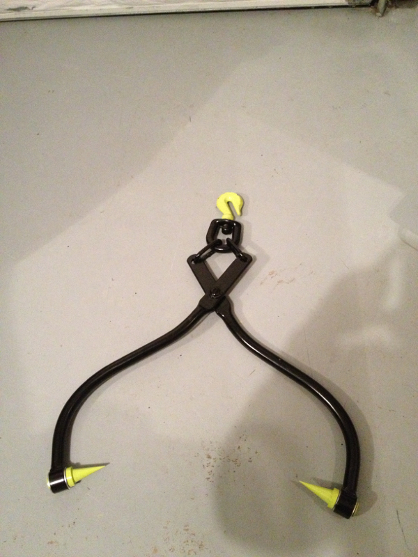

I also picked up a set of log tongs. I've never used one before but have heard good things about them. Anybody have experience with them?
/ Log skidding chains #23
We use tongs all the time. Put a 5' 5/16" chain on it and hang from the centre hook on my loader bucket to pick up logs and place on the sawmill. I have a spotter balance the log and control the spin as the tractor takes all the weight. No muss no fuss.
I've alo been eying these but have not seen them locally. Northern Products sells these for around $79. Let us know how you like them for skidding. Some guys chain up the log as well as using tongs. If I'm going to do that, I just as soon as continue to use just the chain as to me the whole point of the tongs is to reduce the amount of times one is mounting and dismounting. An alleged advantage of the one's you have is that the points seem to be able to rotate so the log is more likely to stay on. Once you use it, please keep us informed of how well they work for you.

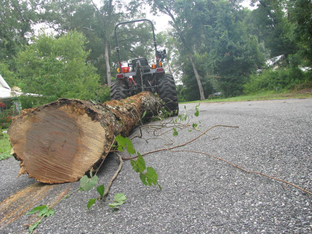

I pull from an OMNI Hanging Tree attached to cross-drawbar stabilizer. It is a very good rig but weighs, maybe, 65 pounds. Here is what I would buy today:
Norwood Log Hog Log Skidder Tractor Attachment, Model# 41255 Log Hog | Log Skidding| Northern Tool + Equipment
I have log tongs somewhere in the shop but have not used them for a long time. More effort needed than with my Hanging Tree rig.
Next you need chain grab hooks for your bucket, mounted in line with lift arm hydraulic cylinders. I have Ken's bolt on grab hooks and highly recommend them. The 5/16" hooks will securely "grab" 3/8", 5/16", 1/4" and 3/16" chain; almost universal chain fit.
Ken's Bolt on Grab Hooks
Tractor: Kubota B3300SU = 33-hp / 1,900 pounds​

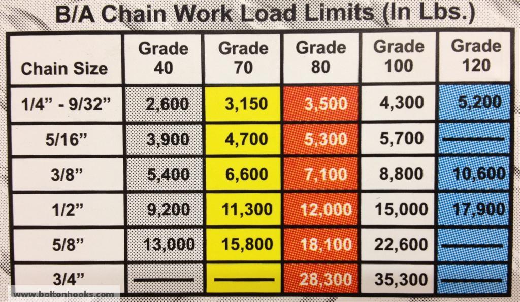

Just thought I would add, A grade 70 5/16 chain is rated considerably higher than a 3/8 grade 43 chain.
The chart I have does not agree with that statement:
My mistake, sorry. I thought my 3/8 was grade 43 , it turns out it is grade 30 (2650 lbs.) It is still new in the package (garage sale find) . I have always used my grade 70 5/16 off my rollback. Can't use anything less than grade 70 for tow trucks.
