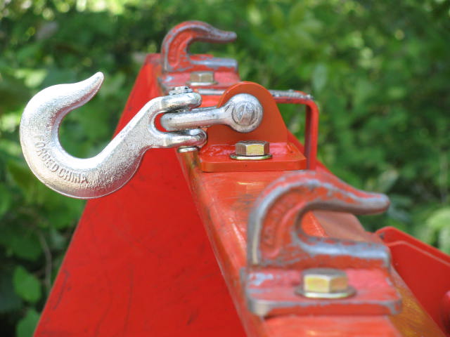

I pull from an OMNI Hanging Tree attached to cross-drawbar stabilizer. It is a very good rig but weighs, maybe, 65 pounds. Here is what I would buy today:
Norwood Log Hog Log Skidder Tractor Attachment, Model# 41255 Log Hog | Log Skidding| Northern Tool + Equipment
I have log tongs somewhere in the shop but have not used them for a long time. More effort needed than with my Hanging Tree rig.
Next you need chain grab hooks for your bucket, mounted in line with lift arm hydraulic cylinders. I have Ken's bolt on grab hooks and highly recommend them. The 5/16" hooks will securely "grab" 3/8", 5/16", 1/4" and 3/16" chain; almost universal chain fit.
Ken's Bolt on Grab Hooks
Tractor: Kubota B3300SU = 33-hp / 1,900 pounds​
