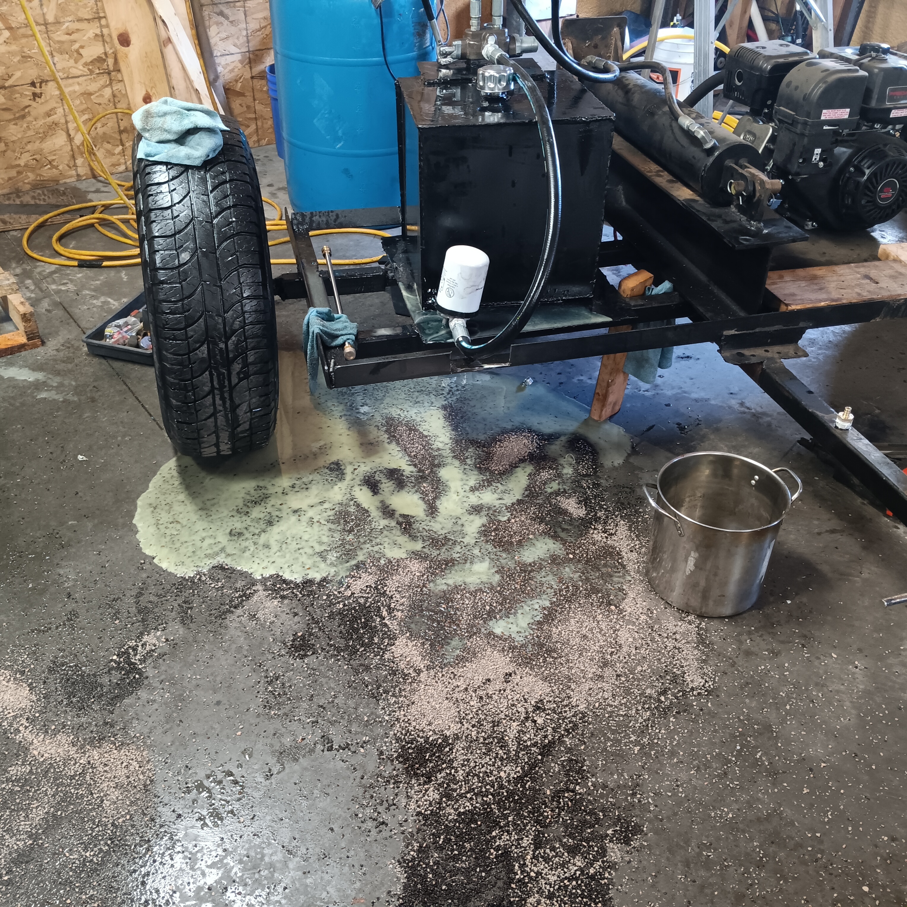

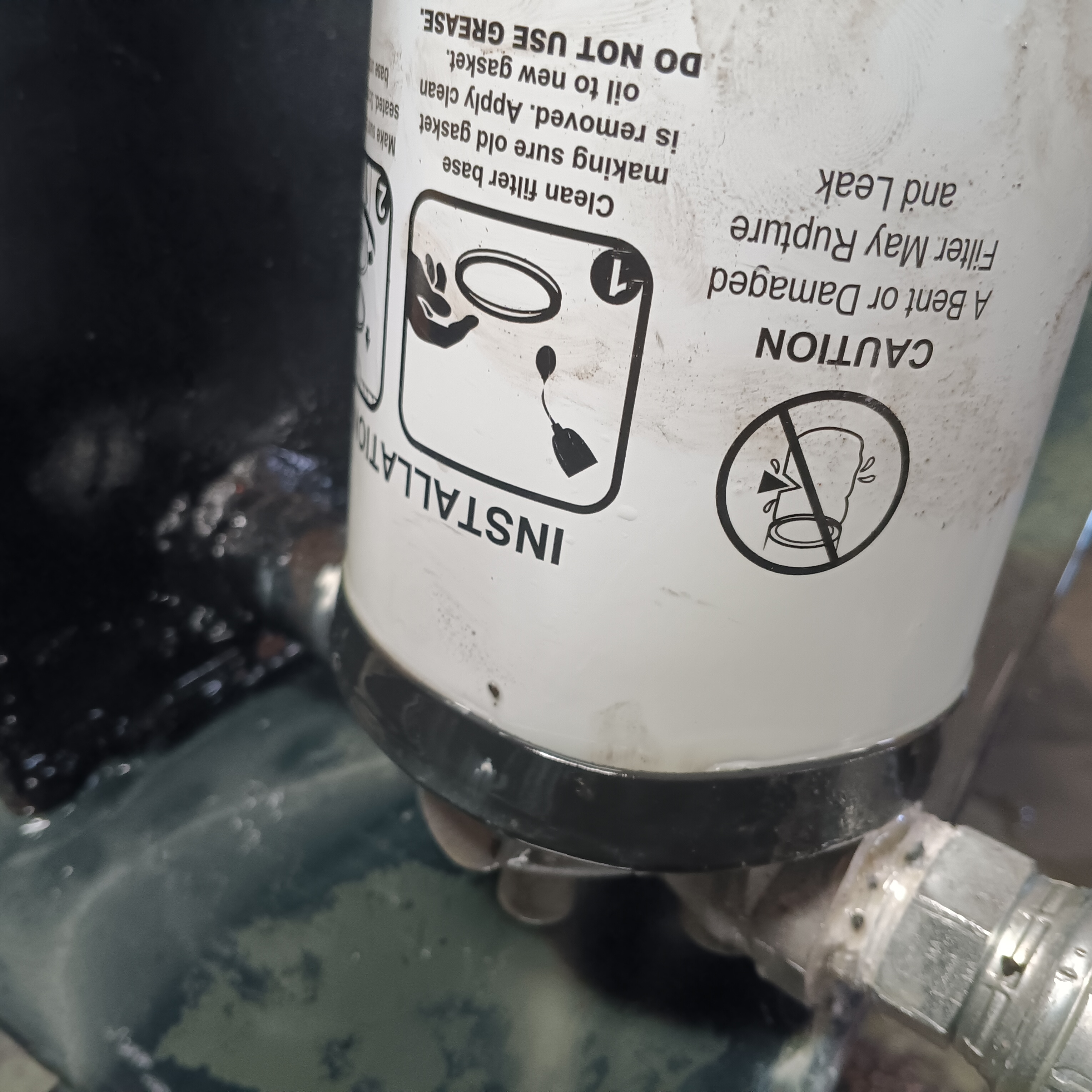

I bought a 3/4" hyd. Hose all good now except oil filter I might have to change that because the gasket around it did not stop the fluid and it went on the floor.

Well I changed the line from 1/2" to 3/4" I bought a clear line and put it on and started the spliter and it spit fluid all over! .
I use hose clamps on each end I checked before starting the spliter I think I have to buy pex crimp rings and a better line.
Now you know why it's just worth buying a hydraulic hose for a return line. 2gal of fluid prob cost the difference between low pressure hose and a hydraulic hose.
Surplus center is where I got all my 3/4 log splitter lines.
You want proper hydraulic lines for everything except the suction line between the tank and pump inlet. Assuming your filter is on inlet to tank, any line between the pump and filter can see some pressure, even if it's only super high between pump and cylinder. The suction line should be proper suction line, as regular unreinforced hose can collapse.
