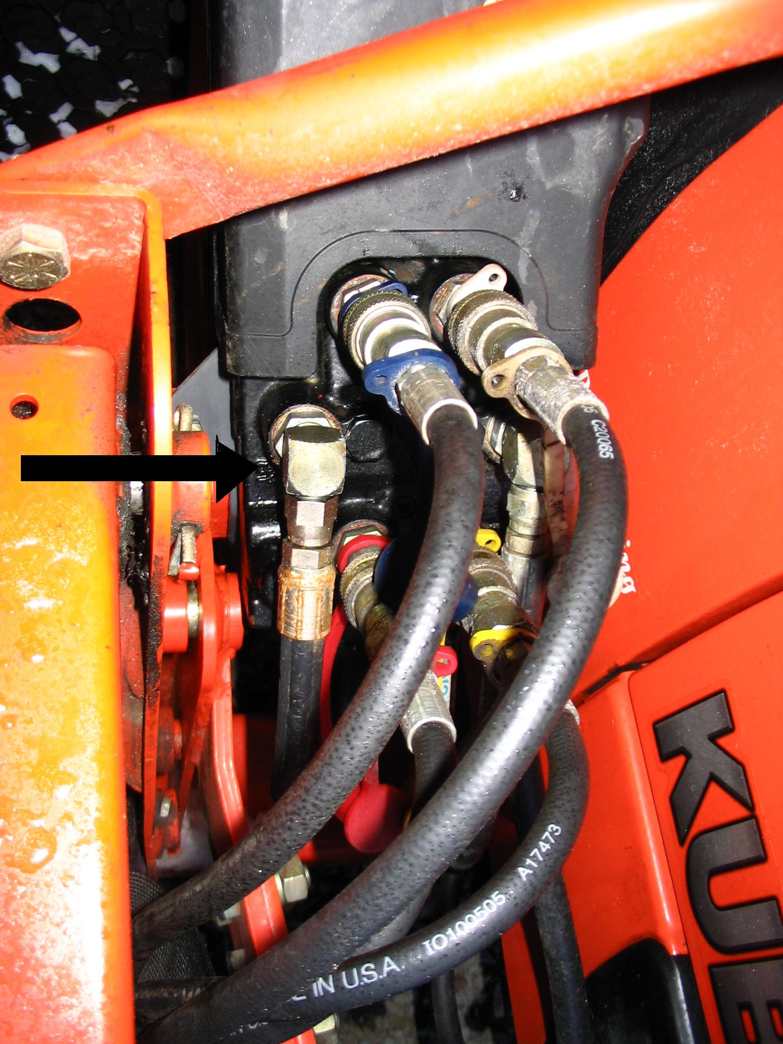

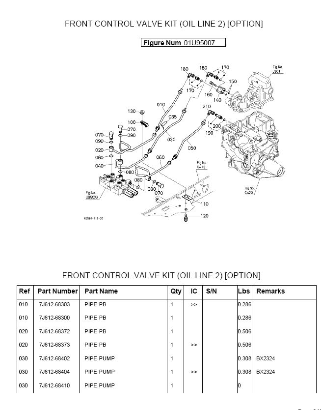

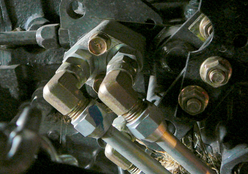

OK guys, I'm pretty confident that I've got this. A little research and exploratory surgery netted the following pictures. One is from the parts book, and the other from my FEL valve. The line I need to tap into is the one marked BY on the valve and listed as PB on the diagram, right? This would make it the forward of the pair of lines at the rear as in the third picture, according to the parts diagram and from tracing it back from the FEL valve.
So, what I intend to do is to extend the PB line at the rear point just before it goes into the elbow. Then I'll rotate the elbow rearward and extend a line from there. The two new lines will be coupled together until I want to connect the splitter, then I will uncouple and insert the splitter. If this all sounds good, let me know.
My only outright question is does it matter which side connects to what line on the splitter? My thoughts are that it doesn't since the PB circuit is just providing flow and the splitter valve directs it. It shouldn't matter which quick connects are male or female, and I shouldn't have to mark them, right?
Your hookup sounds correct to me...But you do need to hook it up so the OUT from the tractor's pump goes to the IN of the splitter's valve for everything to work properly. The fluid flow through the valve's is directional.

I believe that it is most common for the pressure line from the tractor to have the male QD fitting. The breakaway QD setup, deviates from that.
The pressure line attaches to the "P" port/in port on the log splitter valve

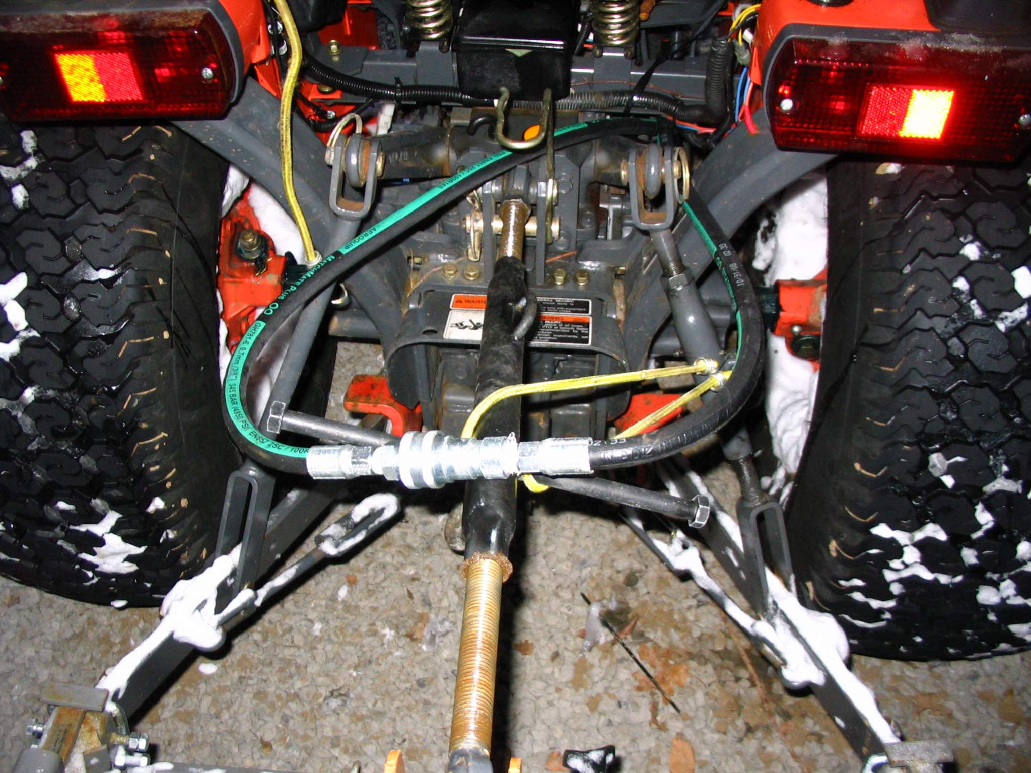

OK, so the flow is coming FROM the FEL valve and flowing TO the rear of the tractor currently, right? So once I extend that line, I put a male QD on that and a female on the line that is going back to the tractor. Connect the two together when not splitting; hook up the splitter when its time to make logs into sticks.
Thanks everyone. Once its all done I'll post pics.

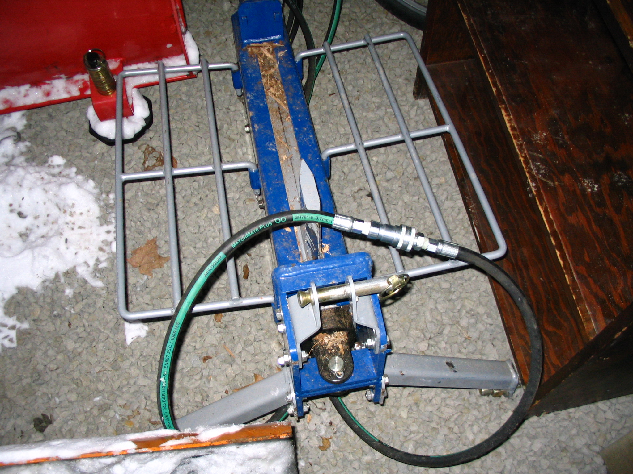

I see this thread has some new interest, so I thought I would post an update. I used the splitter extensively with this set up and it works flawlessly. Connections are quick and painless and the power and speed are excellent.
Last weekend we split 6 cords of birch in six hours with this set up. Thanks for the help from my fellow TBNers, and if you're in the market for a splitter, definitely checkout the Splitfire.
