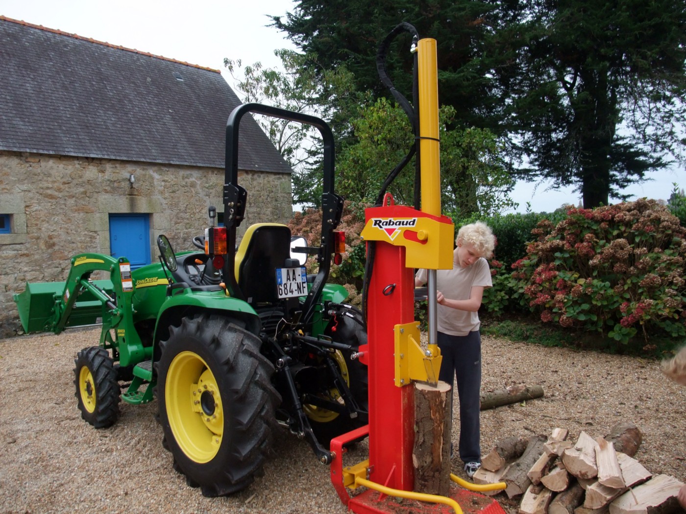

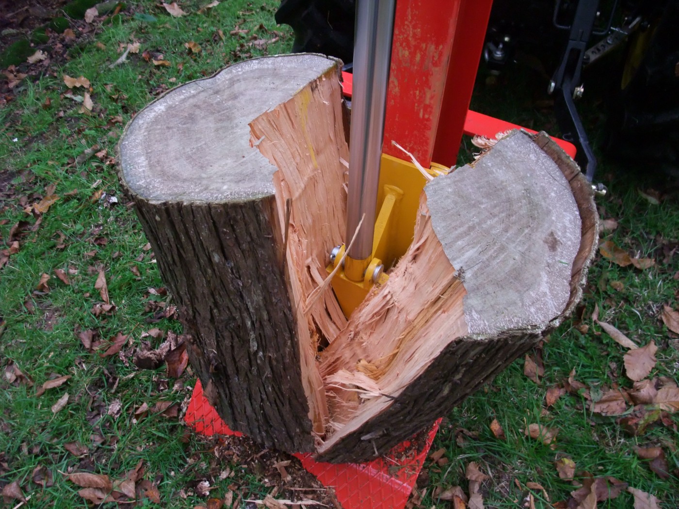

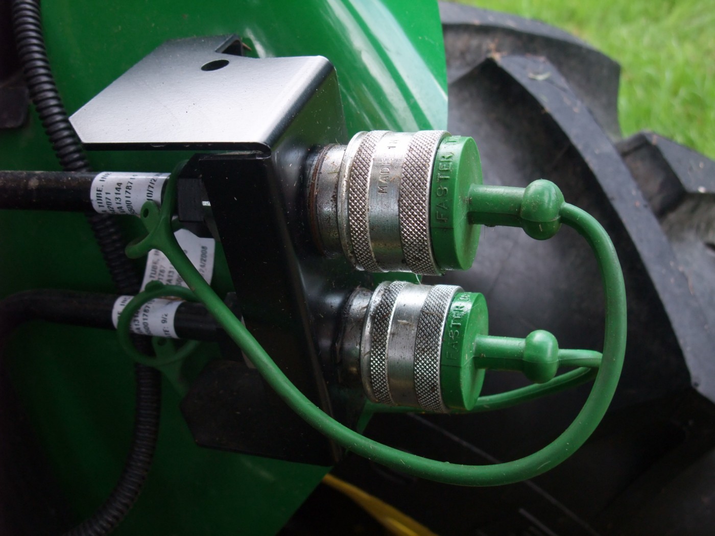

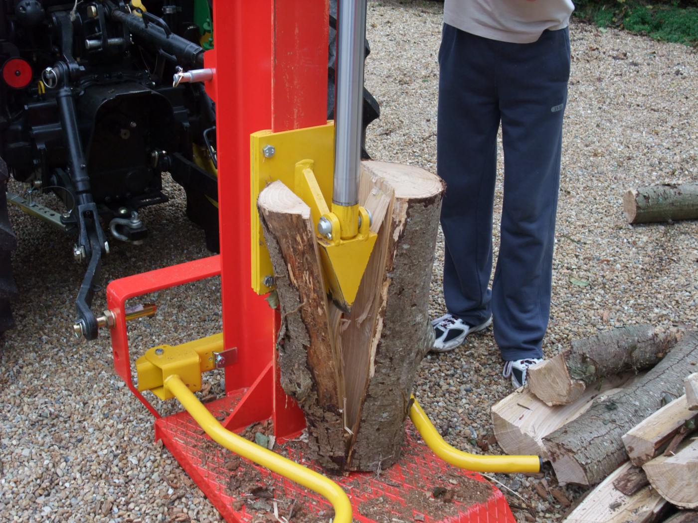

Not having power beyond installed on my JD 3520, I use the 3rd SCV to operate the splitter and other hydraulic implements. Quite neat and works all right if you hold the lever properly with bungee or small chain during operation.
