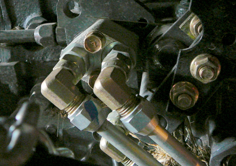

Finally got pictures. Here's the view from the right side and rear. I assume this is the right spot since this is where the lines for the FEL originate. Let me know if you need to see more.

/ Log splitter connections #18
Right, are there any markings on your FEL valve where the lines go in? Look for PB (if not ask your dealer which one is the PB Power beyond)
From your picture it SHOULD be the line on the left when looking at the side. (unless kubota ran the system backwards) Thats the line you want to remove entirely and run a new line from the fel to a set of quick connects at the rear, and then back to the hydraulic block.
keep the QC connected when operating the tractor, and connected to the slpitter when it is mounted.
You need to SHUT the tractor off when making connections as the hydraulics are always flowing when the tractor is running..
Let me know if you have any questions..

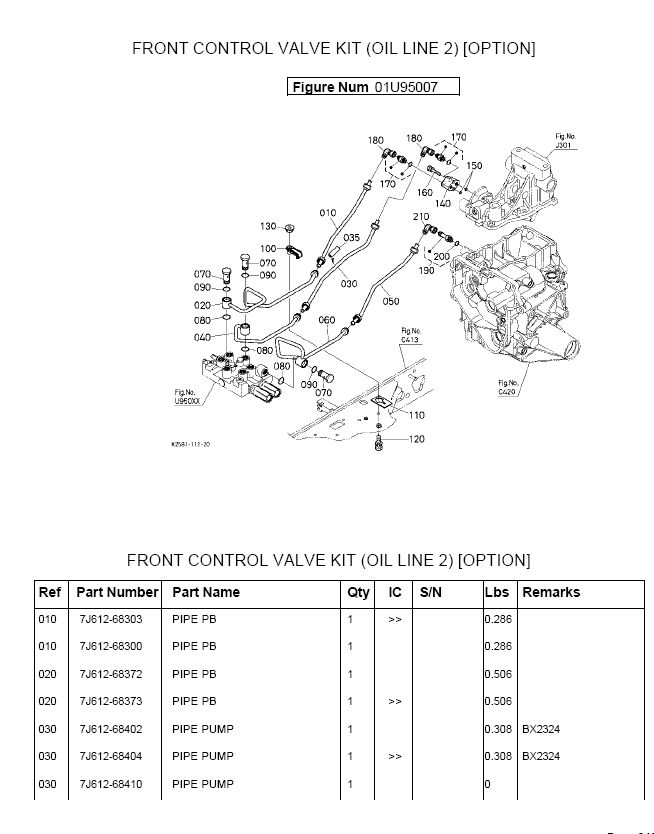

OK guys, I'm pretty confident that I've got this. A little research and exploratory surgery netted the following pictures. One is from the parts book, and the other from my FEL valve. The line I need to tap into is the one marked BY on the valve and listed as PB on the diagram, right? This would make it the forward of the pair of lines at the rear as in the third picture, according to the parts diagram and from tracing it back from the FEL valve.
So, what I intend to do is to extend the PB line at the rear point just before it goes into the elbow. Then I'll rotate the elbow rearward and extend a line from there. The two new lines will be coupled together until I want to connect the splitter, then I will uncouple and insert the splitter. If this all sounds good, let me know.
My only outright question is does it matter which side connects to what line on the splitter? My thoughts are that it doesn't since the PB circuit is just providing flow and the splitter valve directs it. It shouldn't matter which quick connects are male or female, and I shouldn't have to mark them, right?

You are correct on most accounts, except your spitter valve ports will be labeled IN and OUT . if you reveresed the flow I don't think it will harm anything but it WAS designed with a flow in a particular direction...so on your initial installation, make sure the PB line goes to the IN side. Once you've done it once with the quick connects, it will line up every other time.
