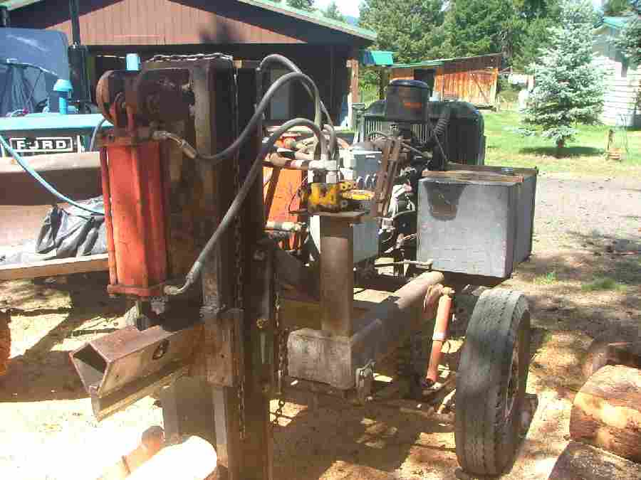

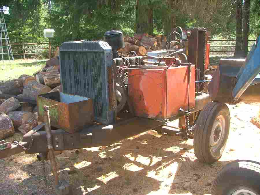

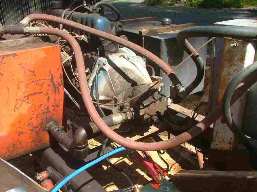

Hi Guys, I have not posted here in sometime. Partly becuase the computer would not reconized me. Finally I just reregistered.
So any way here is a log that I built some 15 years ago. It uses a 1968 ford 6 cylinder engine with a 24 gpm pump(I think) The engine just runs at a fast idle. Once in a while I will get a log that will kill the engine. Just restart and add a little gas. Also shown is the wood pile that I am working at present. That will be next winters, 2009,wood.
The foot is a piece of 1 inch plate and it had been bent twice. When I repaired it the first time I added a couple of bars 3/4X 1 1/4 underneath the foot.

You mention slide and wedge, but I think you are talking about the part of the log splitter which I call the knife. I stole kcprecision's picture and a picture of my splitter. kcprecision has the knife on cylinder side with two pieces of angle iron welded to the knife to spread the log out. His knife is about 2 " long before it hits the angle iron which is good. This giver the splitter a chance to crack the log before it try to spread the log. I see some commercial units where there is no knife edge, instead it is just a wedge, but the wedges are quite small, so it doesn't put too much stress on the whole system. My knife looked very much like kcprecision's intially but the stress was too much when I tried split some big stuff (the knife would bend the I beam).
You notice that that I now just have a knife with no spreader. This reduces the bending pressure when you are splitting big stuff. In retrospect I think the knife on the cylinder is a better design. However a small wedge is going to make splitting any big stuff (2 feet in diameter) very difficult.
I am not too sure if I like the verticle design which kcprecision has, vs the horizontal layout like mine. I think the horizontal design makes it easier to move wood to the splitter. I would like to see one in action.
