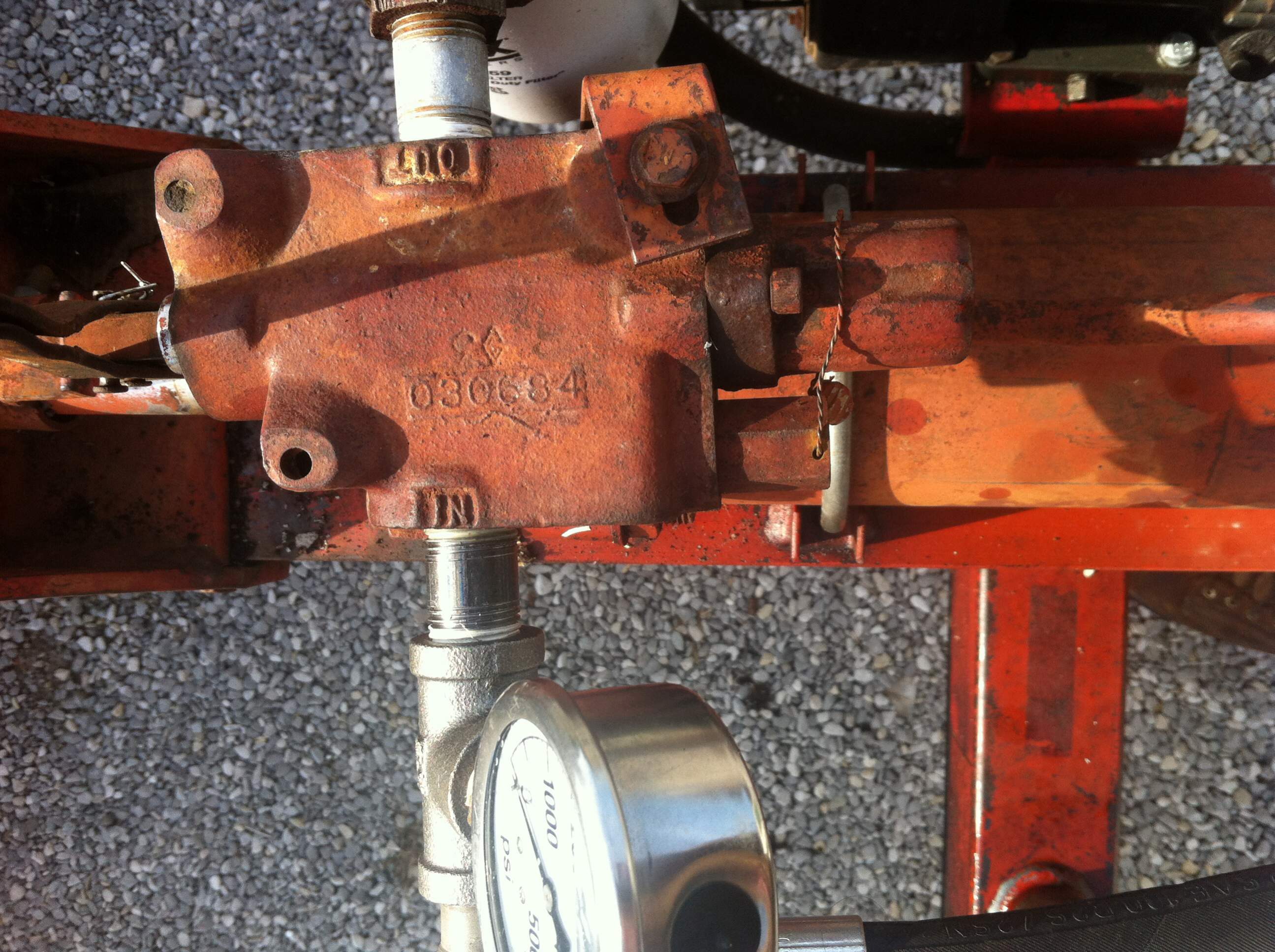

WOW Think I got it!!!! fired it up and couldnt get but 200 psi on forward stroke, retracted it full and detent kicked out like it should, pushed handle and held it and got 2500 psi instantly! this tells me pump is good, piston is good----------it's gotta be that "bullet proof" valve !!!!!!!!!! correct????
UPDATE: For those who care, It was NOT the Valve, heres what I did, I took valve off and plugged both ports and got needed pressure in both directions, so valve was good and also pump. then I replaced valve on cylinder leaving forward stroke port open and with motor at idle moved piston all the way out and fluid flowed freely out port, viola, bad piston!!!! The weird thing I found was that the piston was good in 1 direction (retracted) but not in both. Anyway I ordered a new cylinder from E-bay (tuff-tool) for $236 shipped, it now can split a 4x4 in half on edge! Prince Mfg. was a major part in helping me figure this out........there valves are BULLET PROOF!

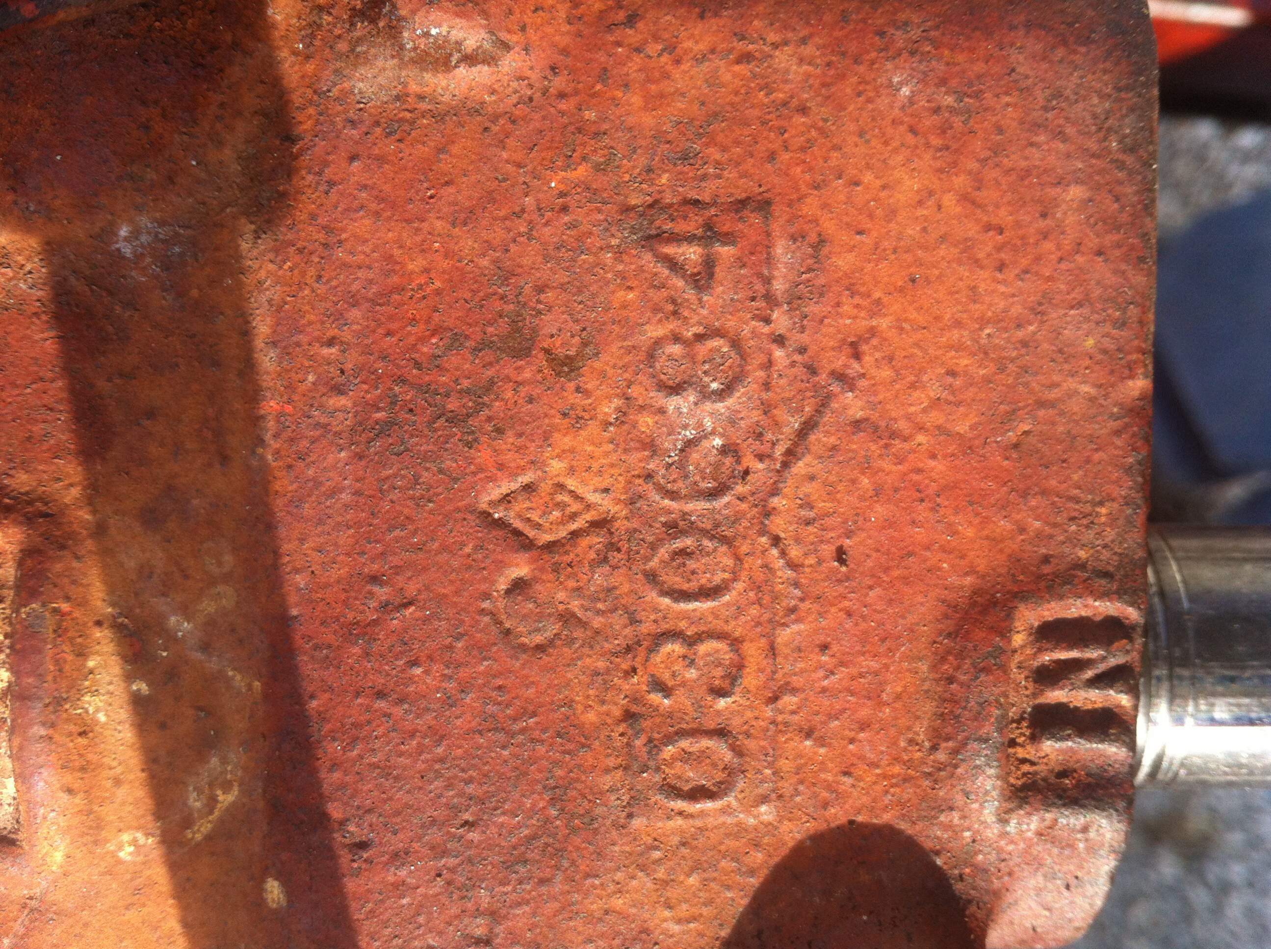

Anybody have any idea who made this valve. And can the pressure and dent valve be set. It's bypassing at 2200 now. Also the dent will pop out sometimes.
