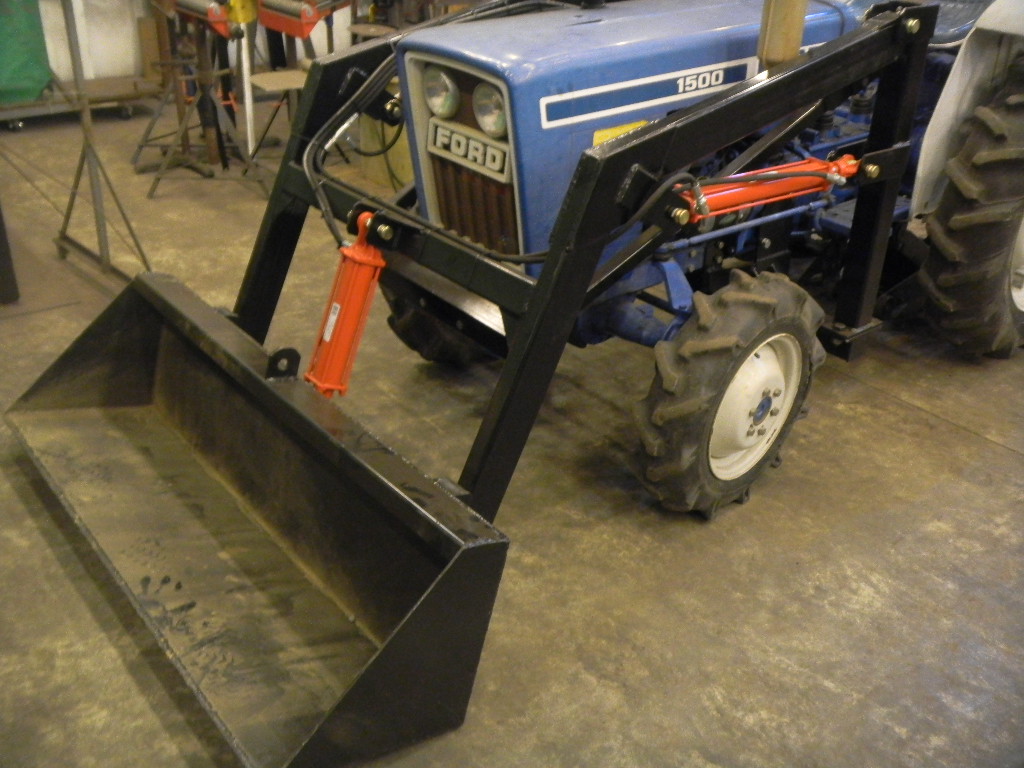

Maybe I missed it because I was so tired:confused3:. I had to drive to California pick him and his tractor up. Drop the tractor off in Hoquiam to have a FEL built and mounted. Then we started the log splitter, and counter weight while that was being done. Then a trip back down to Hoquiam to get his tractor.
