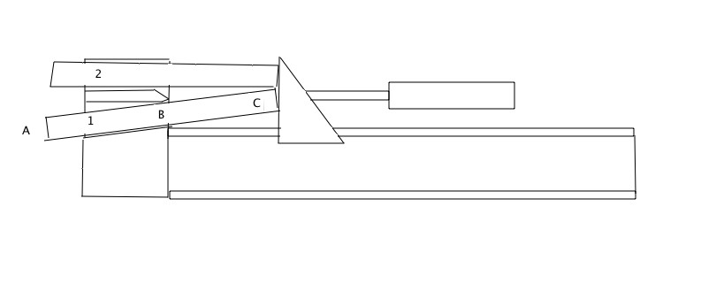

Ah HA! Someone is looking! When I removed the material on the bottom I considered
such forces as best as my burnt lil brain could calculate and I decided that I was
only going to go w/ 50% or so of the top angle.
The I Beam does drop away so the cant's (?) or split pieces of wood can drop away
as they are wedged apart but I wanted to try to AD somedown force to try to
create some equalibrum if you will in the up and down forces created.
There are just shy of a bazillion variables here me thinks!
As always I appreciate the input much!
I still think something is missing in the calculations and that this is a major cause of the problem. Just to be clear though, are you saying the bending happened before the mods to the knife and beavertail? Did the bending stabilize or get worse after the mods?
I'm also curious as to why or what you have against the single directional sharpening of the wedge? Yes, a felling axe is sharpened on both sides but a broad axe is only sharpened on one as is a wood chisel (the micro-bevel achieved with proper sharpening of these tools is so minute as to not be considered)
   / Log Splitter I-Beam BENDING...! #43
What MIGHT be happening:
Adding the bevel on the bottom means the wedge takes a thicker bite of the log. This forces the A end of section 1 down, using B as the fulcrum, lifting the C end, which forces the pusher upwards. It may take an even larger bite of the log as it nears the wedge, forcing the pusher higher.
I don't think it would be a problem on easy splitting wood like fir, but may create wrong direction forces with tough species.
Bruce

That's what I was trying to explain back in post #22
#45
The bending occurred before I sharpened the bottom of the horz blade.
I have not put it back together yet to know outcome, I await parts.
   / Log Splitter I-Beam BENDING...! #46
One thing you do not show is your cylinder install and pusher slide. Is your cylinder installed so it pushes parallel to the top plate? Is it mounted as low as possible or higher up?
