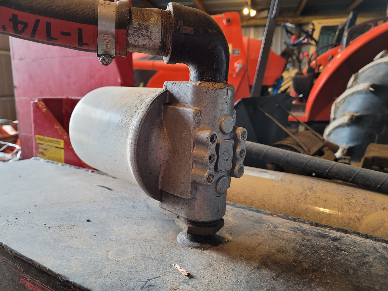

A filter is a filter its physical orientation probably has no effect on how it operates other than it needs to be between control valve and tank... Use what ever plumbing that is appropriate to locate it in safe area... I would bet a couple of nipples and a 90° elbow would do...

If the return line filter is below the level in the tank, you can't change the filter without also draining the tank.
Solution may be to use tractor FEL to raise tongue of splitter to transition return bung to position higher than when tank is in normal position (rotated 90°), but may also require to block vent... Was think this would be solution if I had to remove strainer or replace suction hose on my splitter... Really don't want to deal with 7 gallons of hydraulic fluid...
Dale
/ Log Splitter Question... #45
Hmm, I might try this. The vent is at the very top near the side where the strainer and return line are.
/ Log Splitter Question... #46

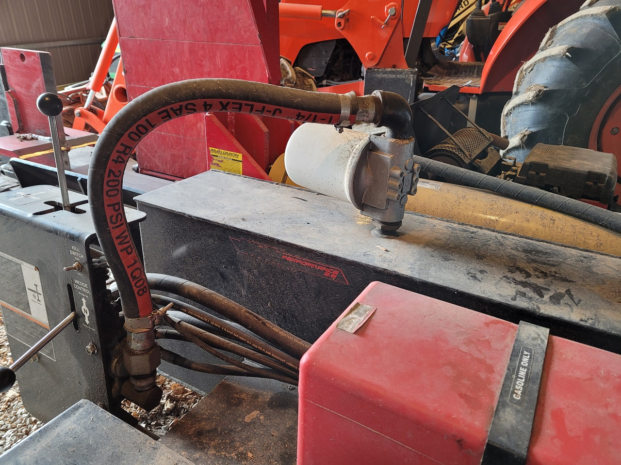

What about if I put a 90 degree elbow at the tank, pointing up, a 6" pipe, another 90 degree elbow pointing away from the tank and then connect the filter head to it, would that work too?
/ Log Splitter Question... #47
Short nipple and a elbow, or a "street 90° elbow" and just enough vertical riser (6 inch?) to get filter assembly above tank lever.... Don't make this so complicated.... ITs just plumbing and location...
Dale

Manage to find the time to assemble it, here it is :)
