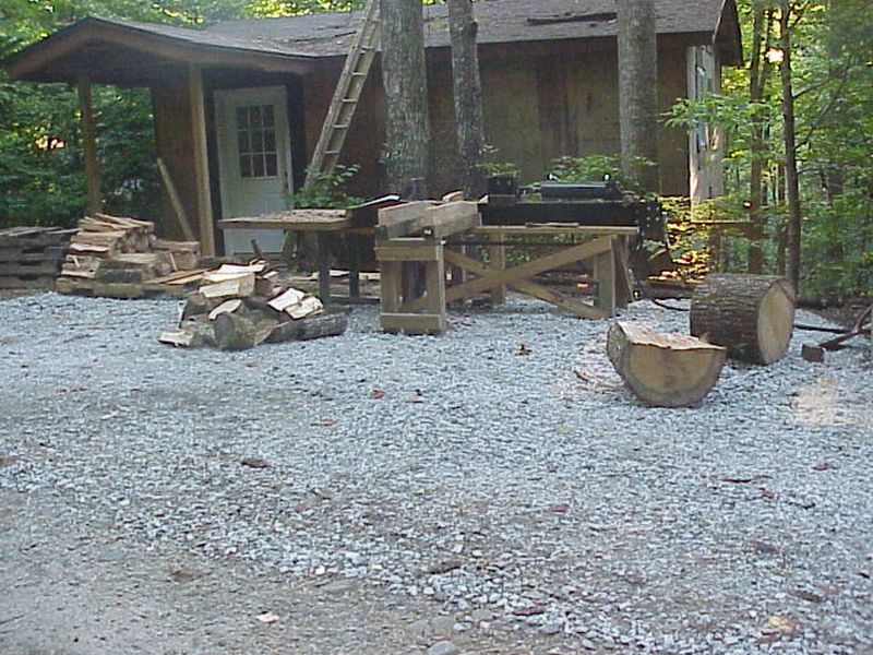

Here is a couple of old pics...before and after I added the lift...I park the tractor about 20' to the right in the pics...you can see the hoses...

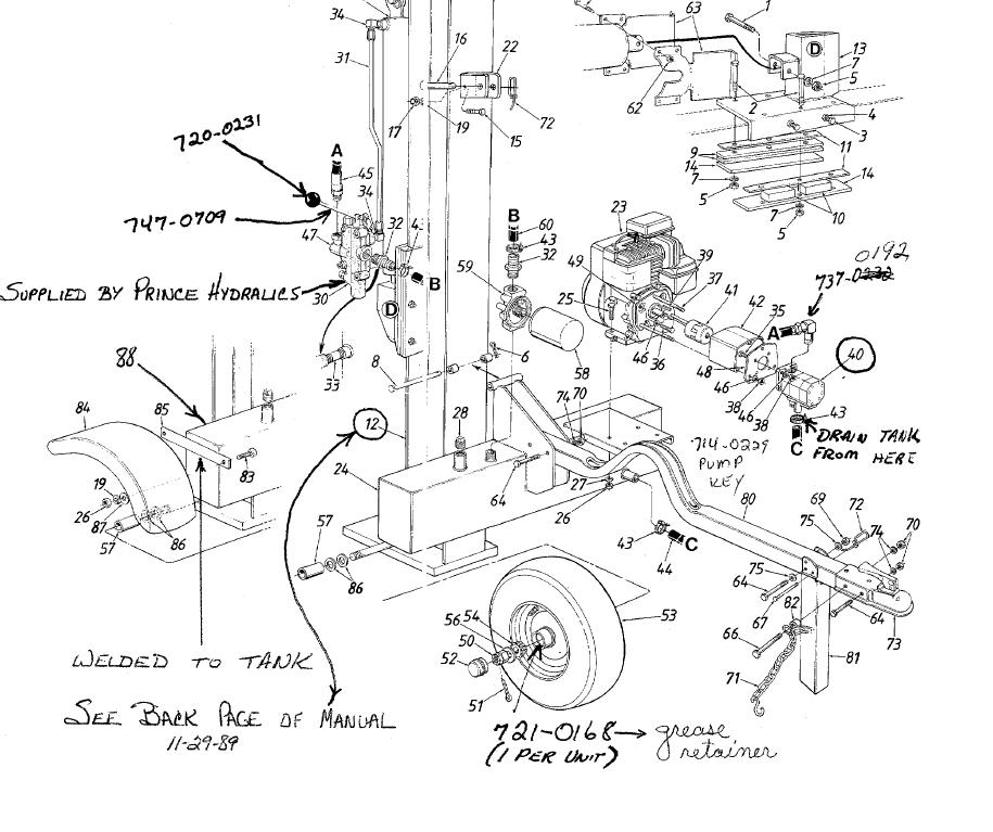

See my pics in regards to filter positioning.
